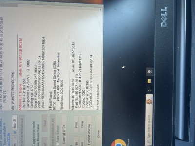

Suz. This is the code I got.
Not sure if it’s after 30 turns or not.
See previous info on this thread.

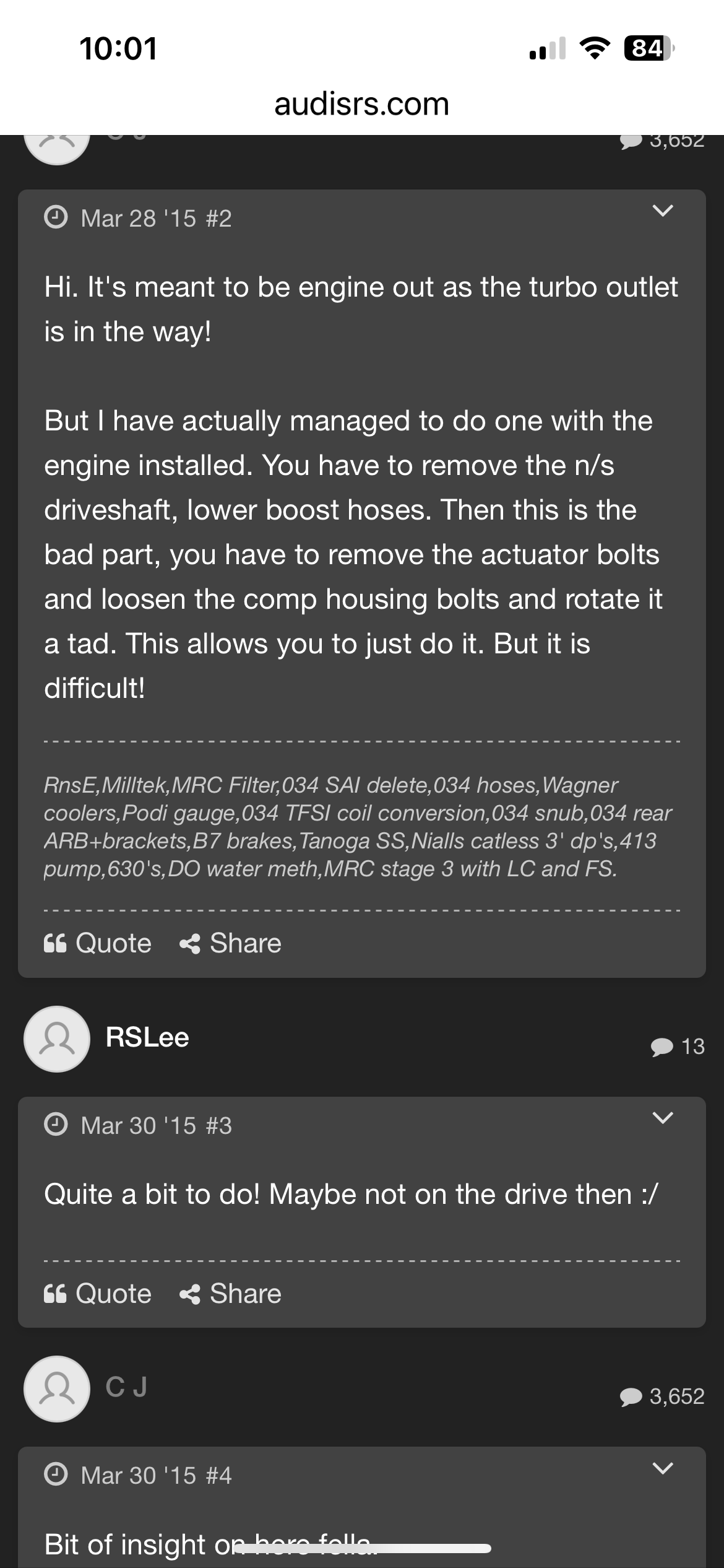

I did come across this. Don’t know how valid it is.
- Posts: 2956
Re: Breakdown
Spoke to Martin/Grizz
Apparently The above “how to” is valid.
May also need to remove the turbo drain pipe and a couple of shields.
Says they have done quite a few of these with engine in situ.

The fault I have is G28 engine speed sensor according to VCDS.
Is that the same as crankshaft position sensor.
