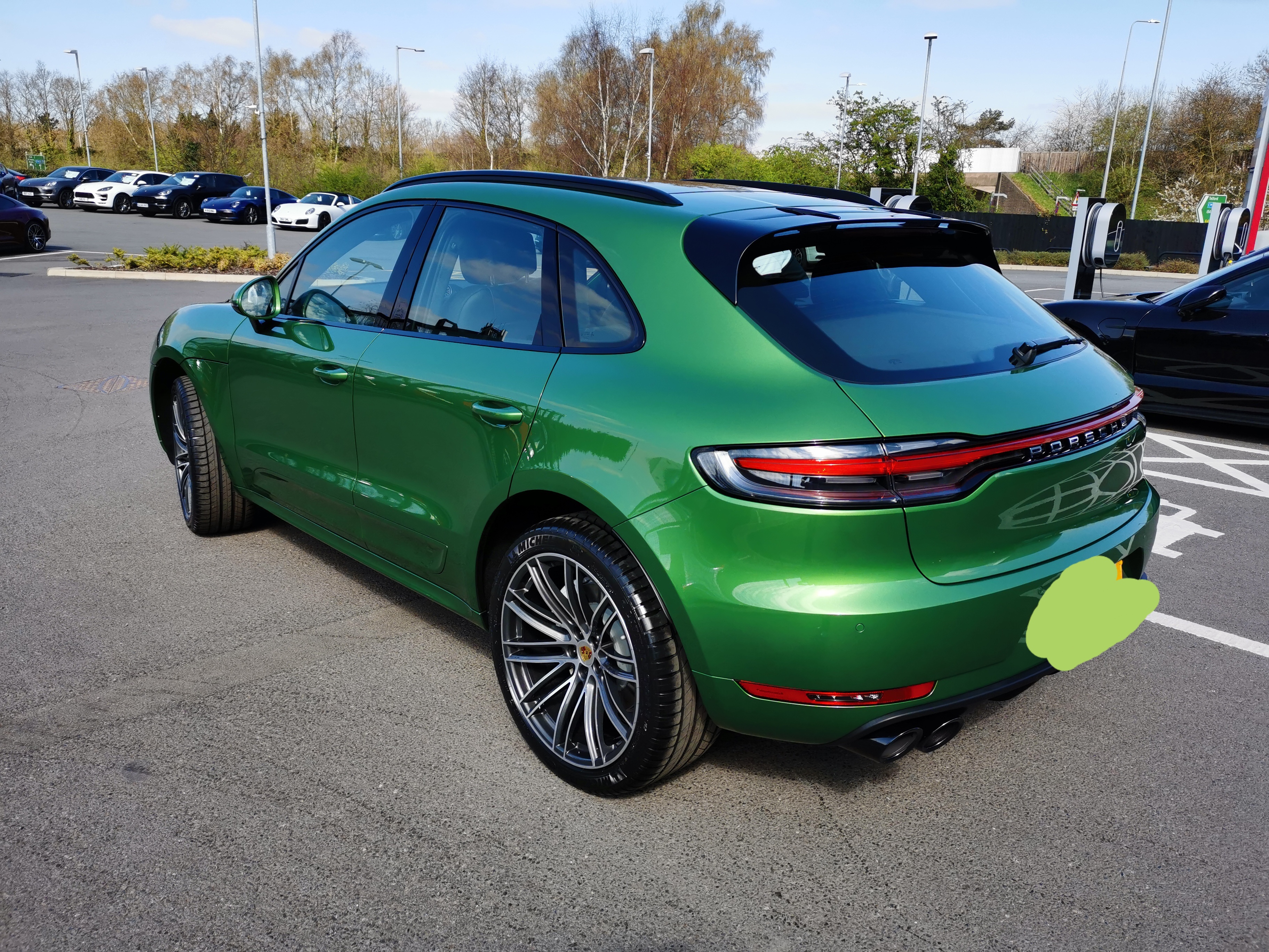

Macan Turbo.mavada wrote: ↑Wed Jul 14, 2021 9:10 pmGreat, which one?chunky79 wrote: ↑Wed Jul 14, 2021 6:33 amThe time had come to scratch the Porsche itch. Pretty sure I won't own another car as long as I had the RS6, it was an amazing car.mavada wrote: ↑Tue Jul 13, 2021 8:12 pm

Noted that it's nothing compared to a bloody 959 Mav!!!
Re: On the road again...
Very Nice Chunky. You must be proud
Almost some performance, bit more heavy, slight less bhp, but i think a much faster changing gearbox.
Have fun with it:)
Have fun with it:)

The gearbox makes a HUGE difference to the speed, not run in fully yet but think it will be quicker than the RS6. It hides the weight very well and air suspension is bloody impressive.
Put the PDK into the C5 RS6 and that'd be an amazing package.
