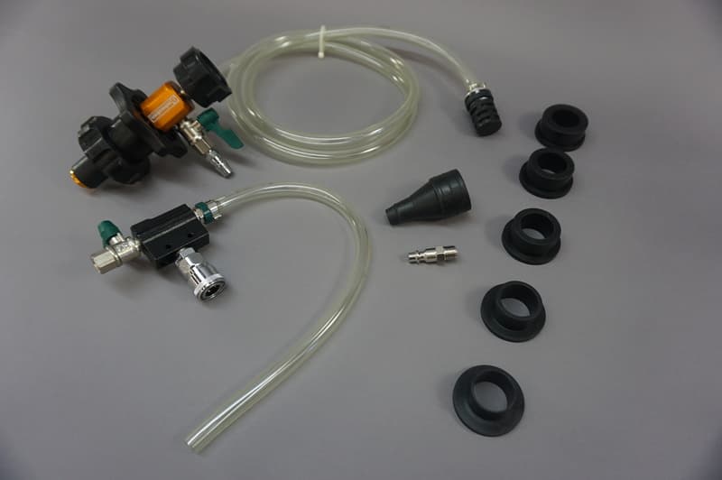

I hear people talk about bleeding the coolant system but I never have. I use a vacuum filler and it works so well that you just fill it and thats it finished.
