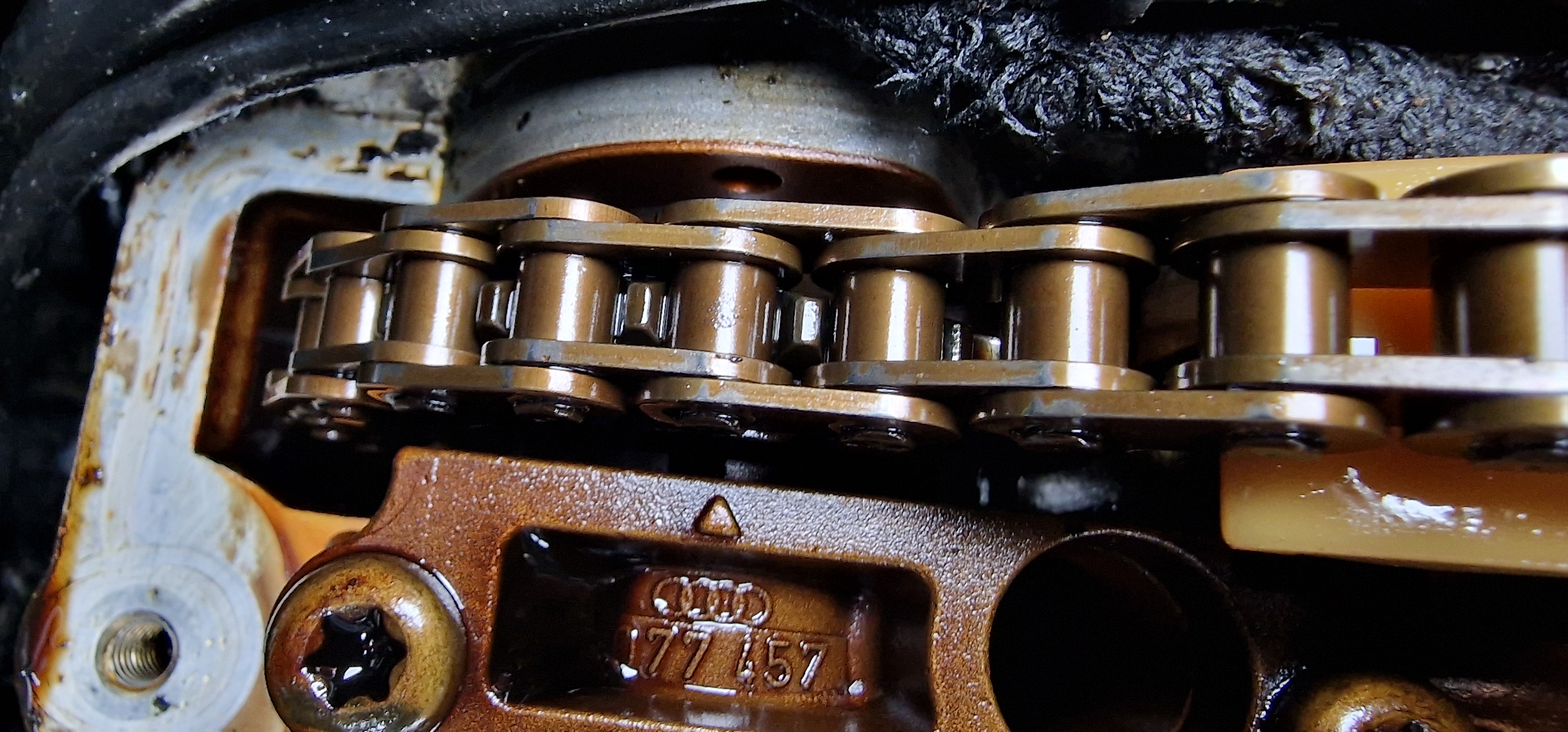

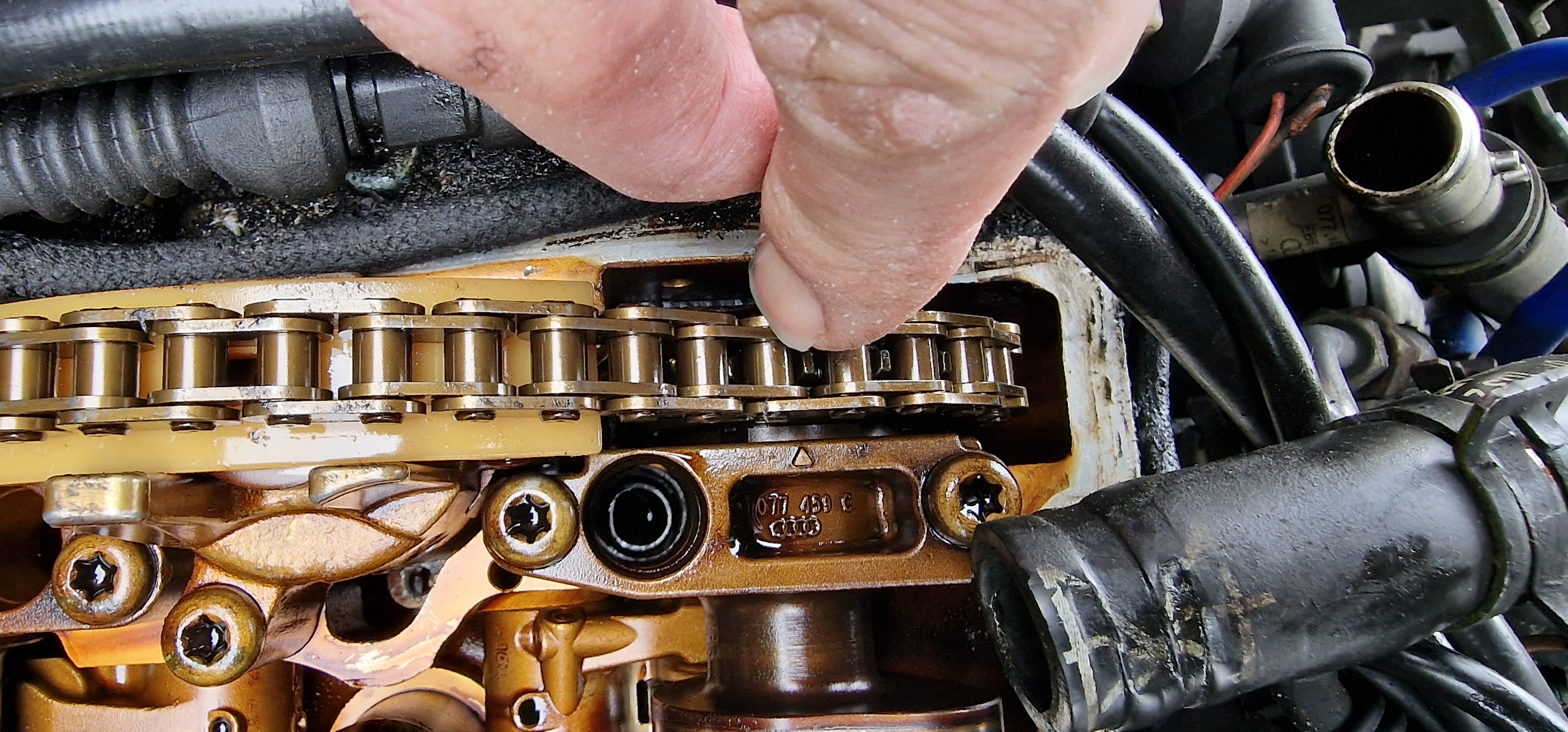

I had another look at the chain and adjuster yesterday, I am now wondering if it's possible that the chain jumped a tooth when the top pad failed. The exhaust cam mark is aligned at tdc, the inlet cam is a few (maybe 5) degrees retarded, plus if I count the rollers from the one aligned with the exhaust cam mark the 15th roller is sitting in a gap between teeth on the inlet cam sprocket that won't align with the mark on the bearing housing. Eg even if I rotate the inlet cam to fully take in the slack in the top of the chain the inlet cam is still retarded compared to the exhaust.

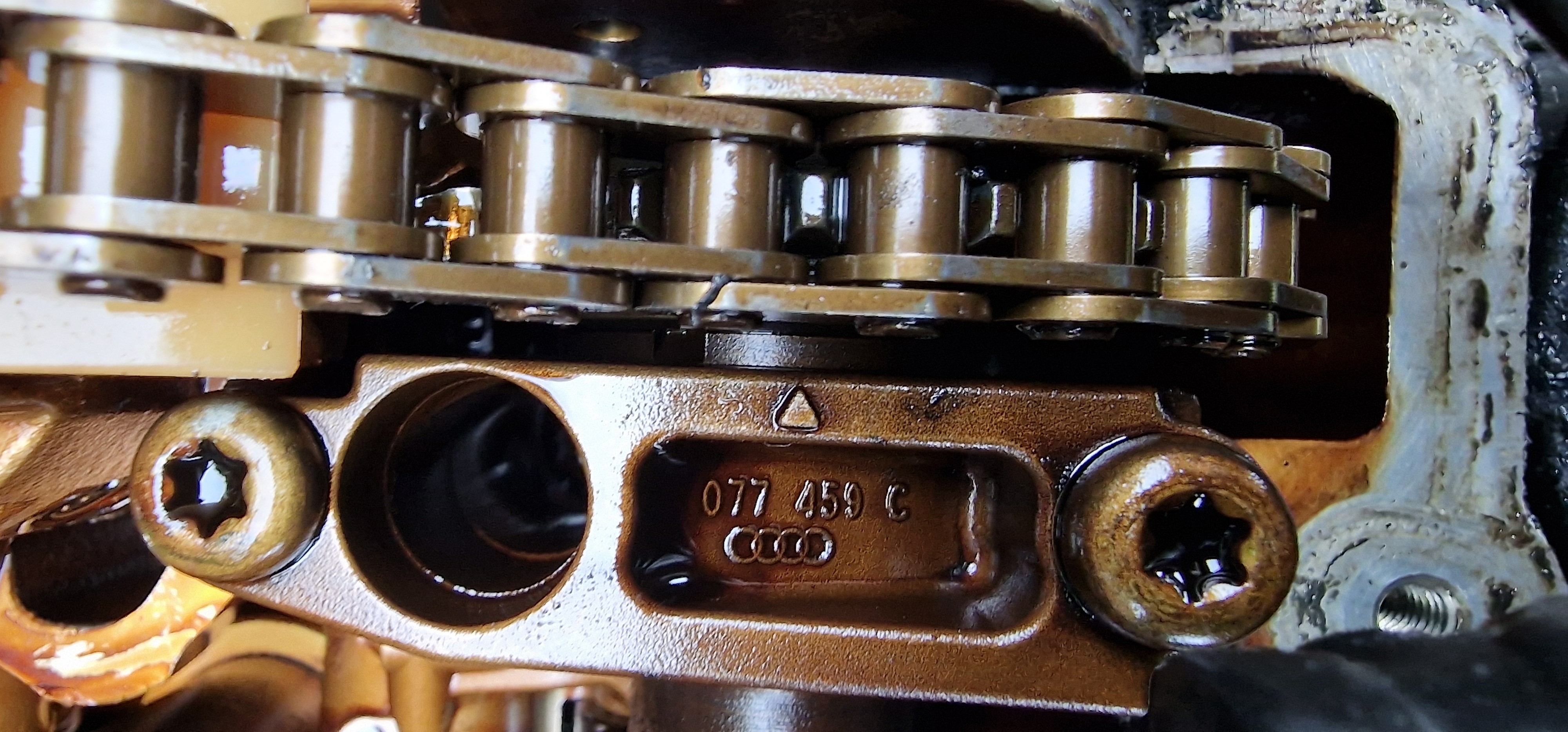

Photos show position of exhaust cam (aligned with mark), and inlet cam showing its retarded. If I count 15 rollers with number 1 one aligned with the mark on the exhaust cam the 15th is the one I am pointing at, which is not far off the inlet cam mark on the cam carrier, but the mark on the cam sprocket is about 1 tooth out (cam is retarded) does that make sense?

Found them, many thanks, mine doesn't align like yours did, even if I take up the slack in the top part of the chain the inlet is still looking retarded. Plus the roller count doesn't look right.....

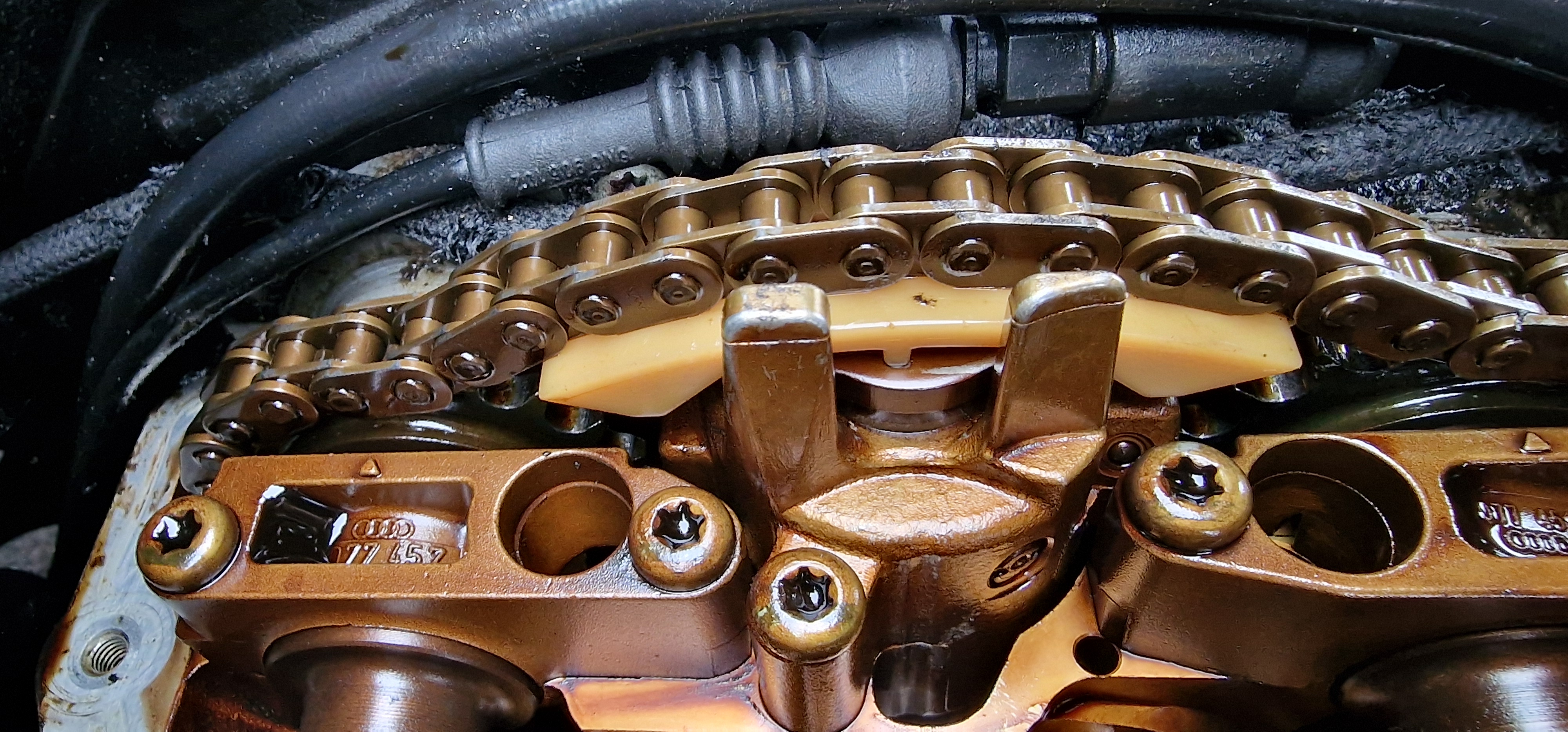

It seems that the top tensioner pad broke because of the slack in the chain (oil not getting inside the tensioner, obstruction and hence not expanding). If that is true then the extra slack caused by the missing pad explains why the cam skipped a tooth.

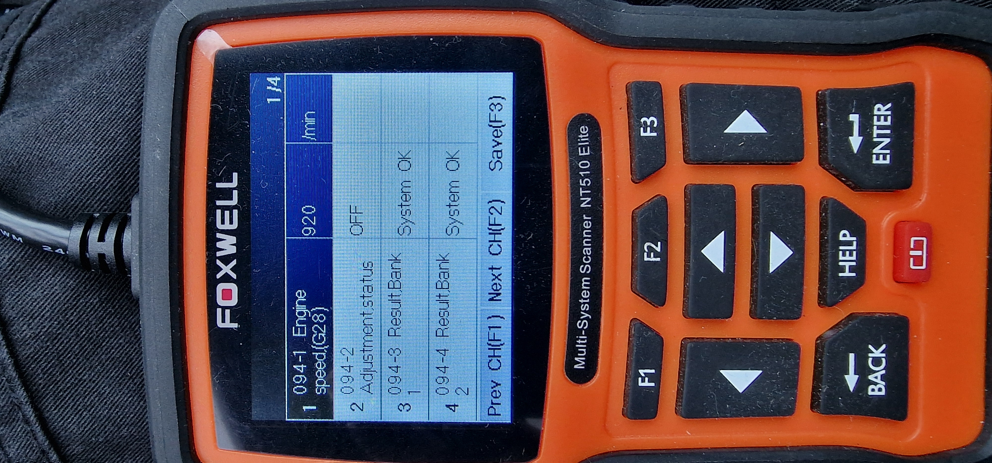

How do you like that scanner?

So far it's been very good, I have a more simple generic OBD Launch one as well, but the Foxwell seems to cover a fair bit of what vag.com does without the need for a laptop. Also works on my D3 S8.....
