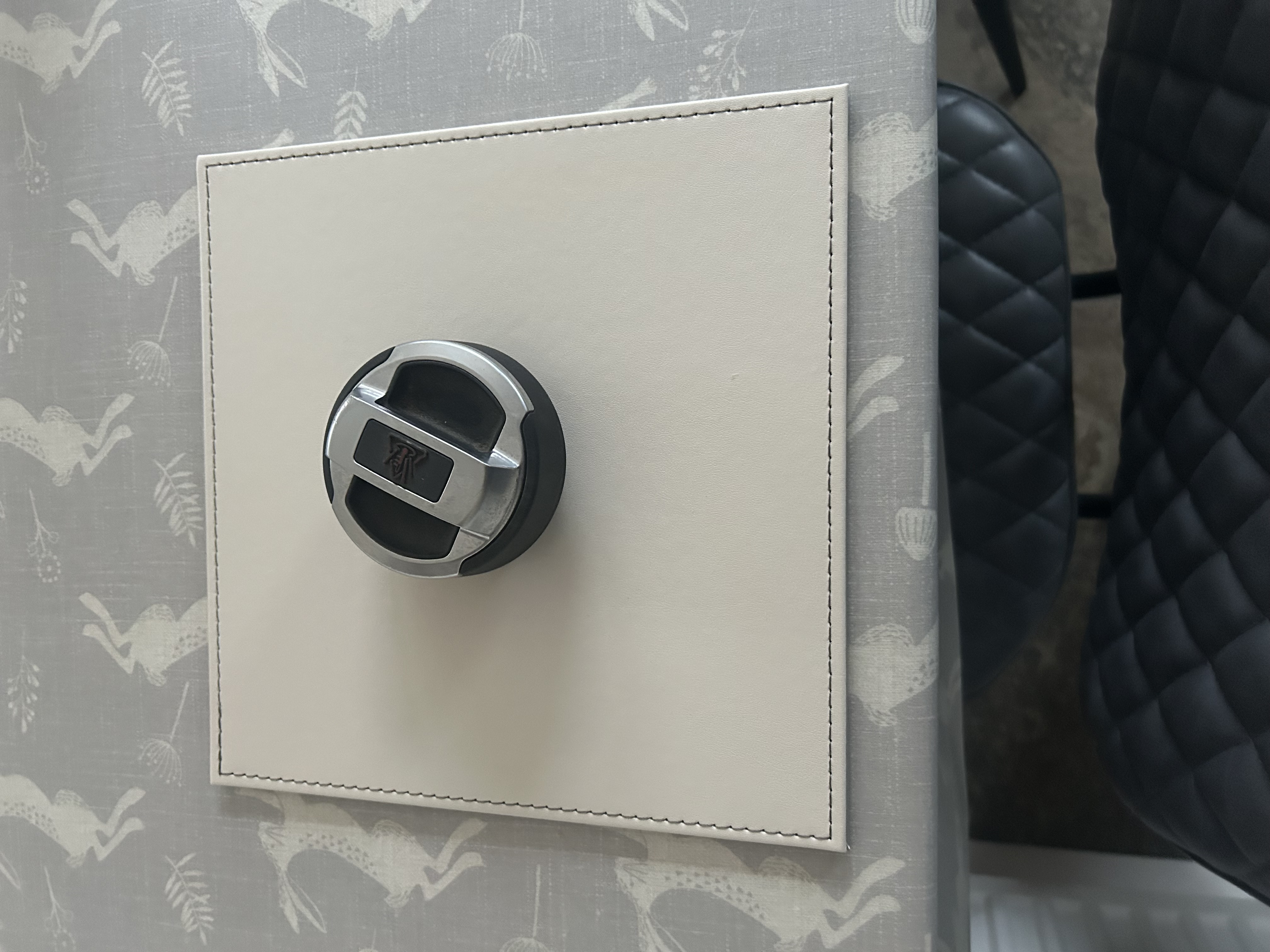

Tiny piece of R8 arrived to replace the nasty blue plastic one.
