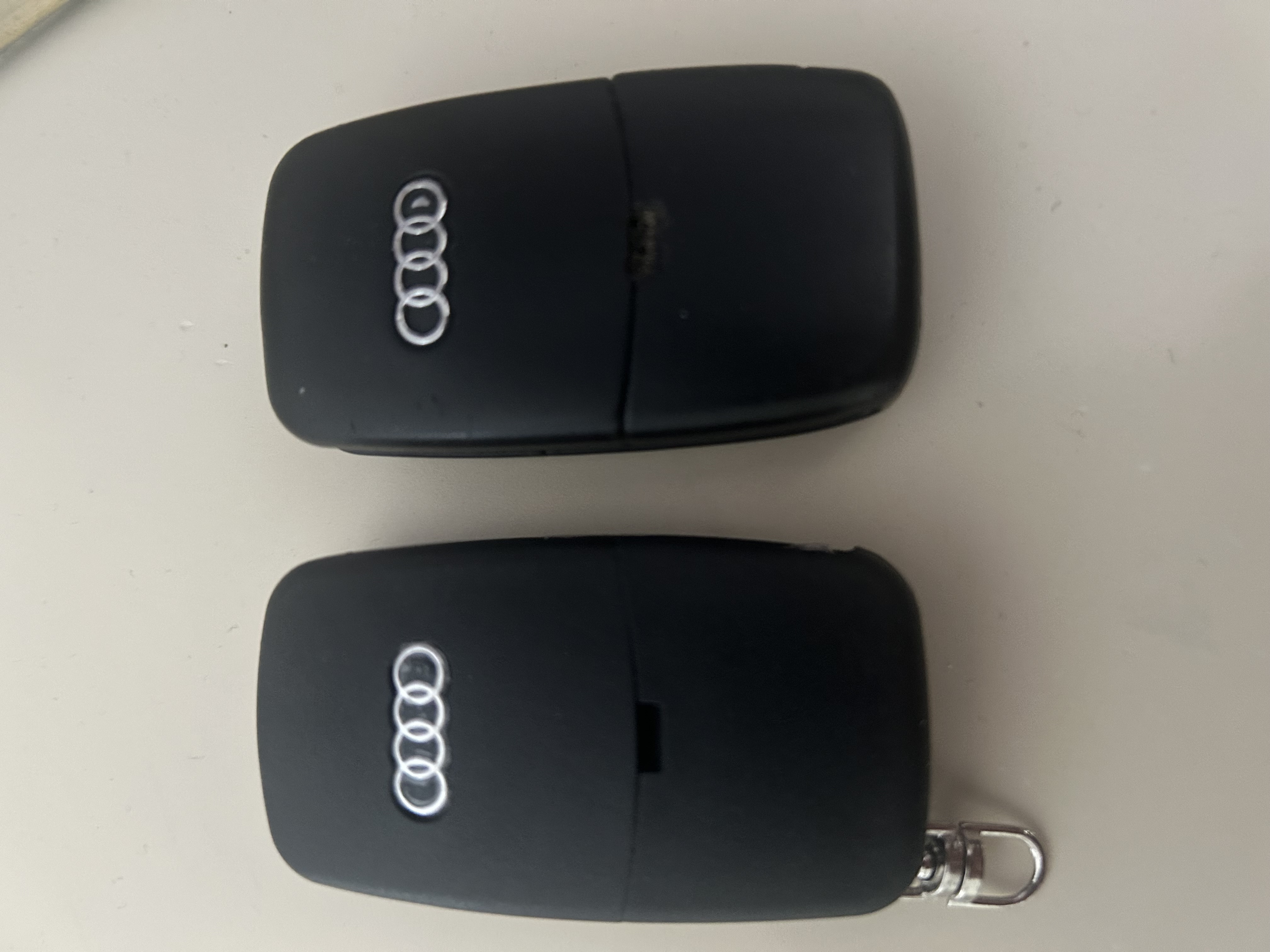

Has anyone swooped the internals of their remote central locking fobs into a new casing.
Had to replace the batteries in mine today.
The fob works fine but it’s looking its age.
Found this on eBay.
Found this on eBay.

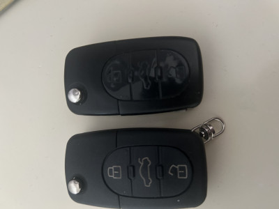

Re: Remote control
You can just buy a new case for a tenner if you're going to swap (not swoop) the internals!
Personally I'd buy a new key (like you've shown) and program it properly, but then I have VCDS to do that - but surely everyone with a D2 or C5 will have that as "the first tool in the toolbox"?

Re: Remote control
Yeah, that's my thinking too. ALthough it's a bit of a faff reprogramming the key.
You could just change the remote fob bit and keep the key bit with the transponder. Depends what condition yours is in I suppose.

Re: Remote control
Buy the shell and swap the internals. Easy, that's what I did. There are videos on YouTube. Ten minutes and done.

Re: Remote control
Cheers guys. Many thanks for the advice.
Will give it a go to swop the internals.
I already have VCDS and have coded the fobs before.

Re: Remote control
Bought a new key and had it cut from photos.
I was a bit sceptical. But put it in the ignition and it works.
Re: Remote control
And it starts the car? It shouldn't work if you didn't swap the transponder or reprogram the ECU etc. to the new key.
Steve2003rs6
- Posts: 2970
Re: Remote control
Paid to have the SKC read. (Security key code)
Then coding done.
Key came with ip48 transponder.
So I now have 3 working keys.
Then coding done.
