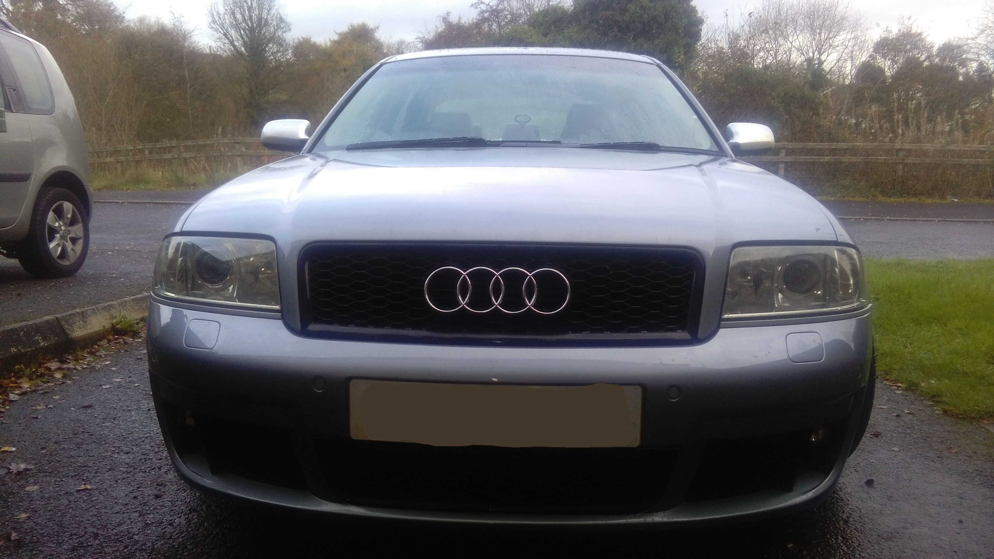

Long time lurker. Bought my saloon off here in 2017, I think I'm its 3rd owner off the forum actually. I've loved every second of owning it, was my daily driver until covid hit. Since then its been sat in my garage on a trickle charger(Always something else needing money). Finally got around to getting her out and on the road. Fired up first time (followed advice on the faq) with no issues.
Its been at the mechanics getting everything I could think of done to it over the summer, and of course on the way back from the MOT centre (passed) last week it decides to start slipping in 3rd around 3000-4000 rpm. Flushed the gearbox oil a few more times to see if it would help but it then threw up fault code P0741-Torque converter lock mechanical failure. Oil seal in the TC perished over time? Not surprised it happened, I got the car expecting to have gearbox work done eventually, although I'd have liked a bit of time to enjoy things before it did.
