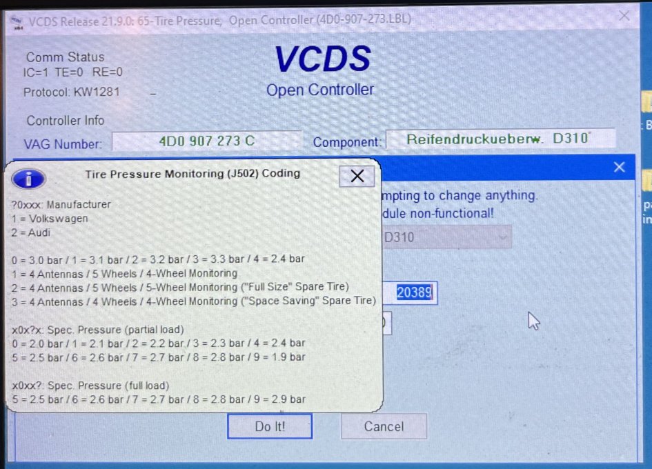

Made some progress on the TPMS sensors. I made a concerted effort with the Vagcom to figure out what was going on. I was getting a reading from a couple of sensors but not the new one, or so I thought. In the measuring blocks you can go through the positions and see what the sensors are reading (if they are communicating) but it wasn't clear if the data was live or not. In adaptation you can start the "antenna diagnostics" which I assume wakes up the sensors so that they send values. You'd need them to do this to learn new pressures from the DIS.
Anyway, I noticed that front left sensor (the new one) wasn't giving a value, but the other 3 positions were. Then I started the "antenna diag" and all of them stopped communicating. Then after a while positions 2 and 3 (I assumed front right and rear left) started sending values. Odd. I went further in the measuring blocks and I saw that the spare wheel position was reporting a pressure. WTF?
I put different pressures in each tyre. 1.5 bar, 2 bar, 3 bar and 3.5 bar and started the diag again. This time I could see that the new sensor WAS in fact communicating but the car thought it was the spare wheel, even though the coding clearly sets the car for no spare wheel. Not only that but the other positions didn't correspond to what I assumed they should (in order, FL, FR, RL, RR). The wheel at 1.5 wasn't communicating so I decided to replace the sensor in that wheel too.

Then, more or less out of ideas, I changed the coding of the TPMS module to 20389 from 22350 and cleared the fault codes. No DTC popped back up. This was new. I drove the car for a bit and then check the measuring blocks. All the sensors reporting in the correct positions. I learned the pressures from the DIS and all good. No more TPMS warning when starting the car.
My theory is that the pressures being reported by the sensors need to be close to what the TPMS is expecting for the sensor recognition to take place. By changing the coding I told the module to expect more like 3 bar than the 2.5 bar the standard coding seems to want.
