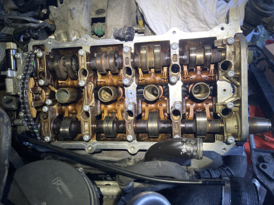

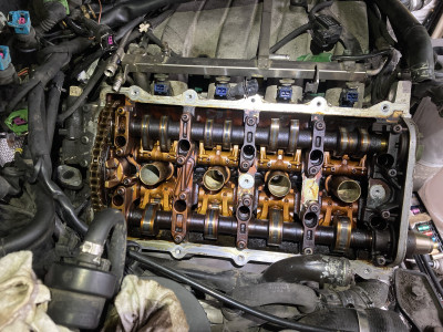

I bought the rs6 last year and changed the all timing components, thermostat, even tensioner chains and pads, etc… and found the timing belt was 11 years old and still in very good condition. The 2 guide rollers were starting to rust and not spin freely, thats how long ago it has been done. I’m not suggesting pushing it that long. The car I bought was neglected , the dirtiest engine I’ve ever worked on(got a deal on it), but 4 years seems a bit excessive and expensive. How much do you guys pay for the job? I do all the work myself, but just the thought of doing it again in 4 years is making me feel tired
Pictures are after and before (how it’s uploading on the iPad) on the difficult side (easy side looked the same), and only did a manual clean with gasoline/petrol (chain and guides are new along with cam bolts). It seems the oil change intervals were also long…
