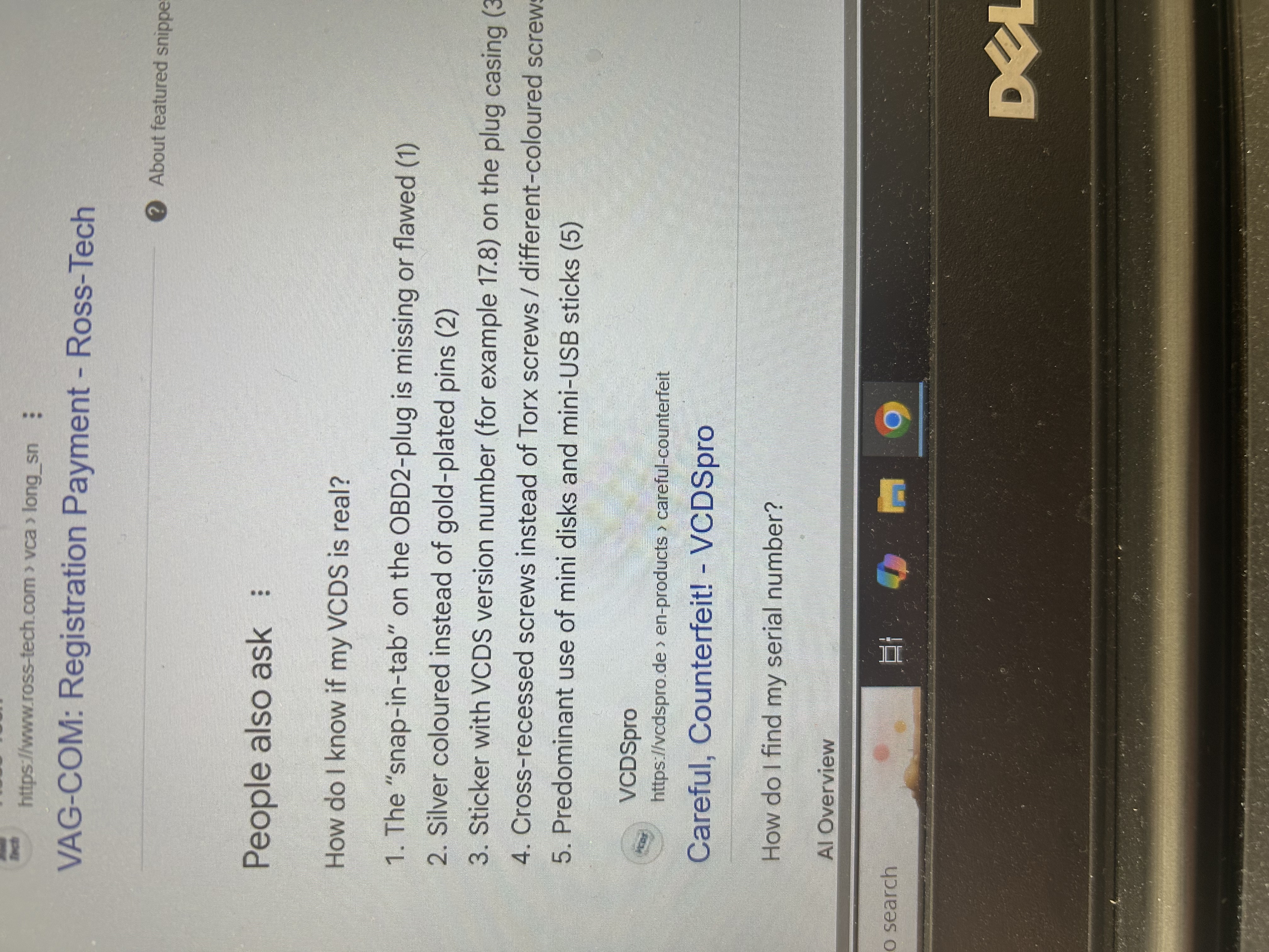

Came Across this whilst looking into it.

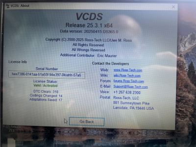

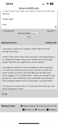

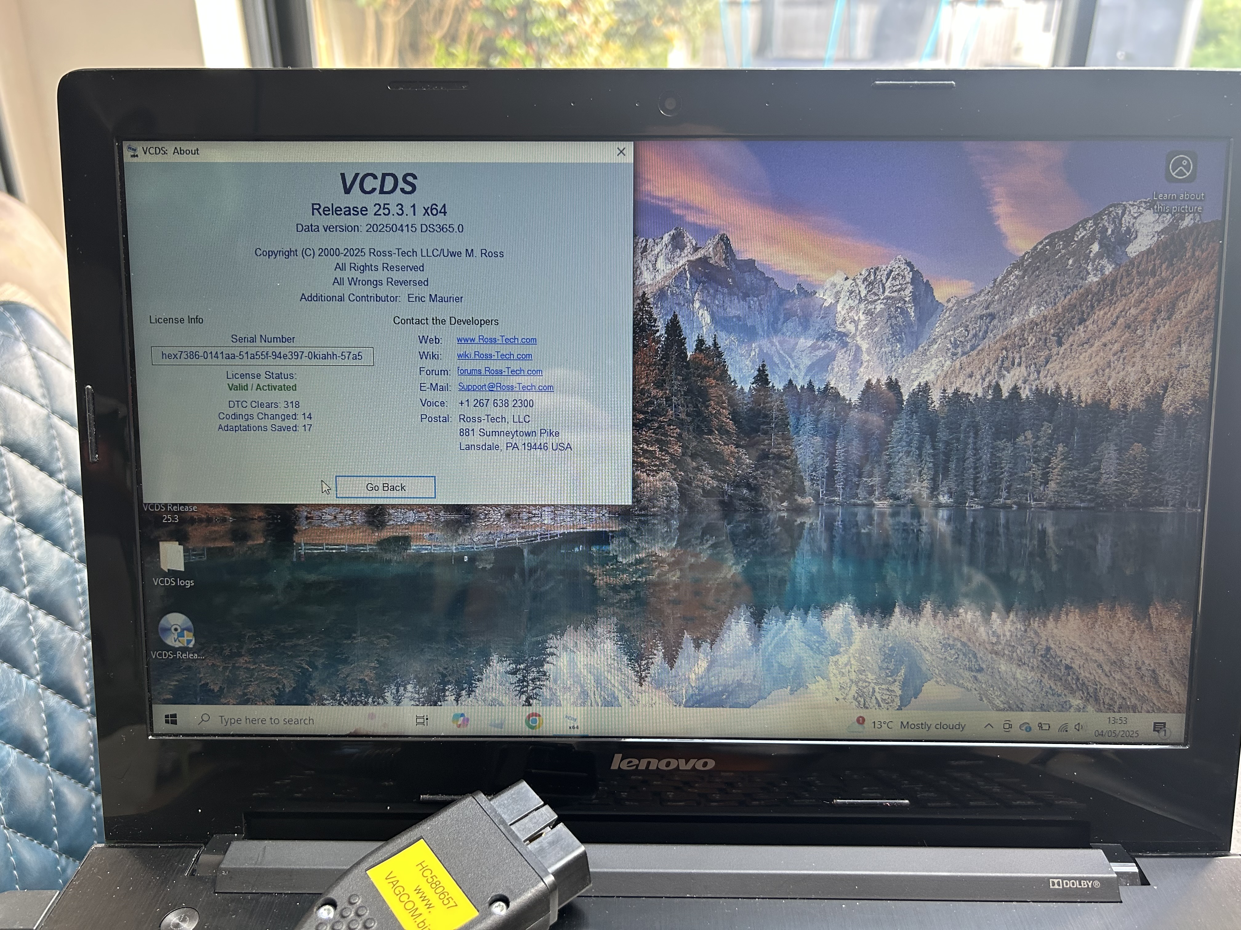

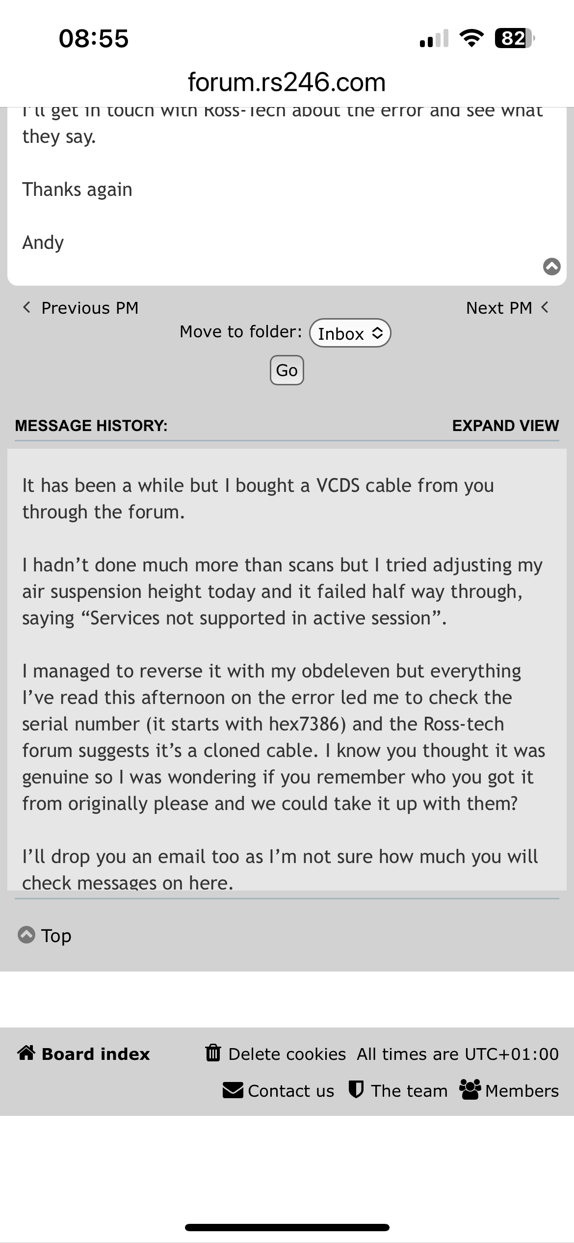

Thanks all, I’m the Andy. I messaged Steve to try and understand more, it has been a long time so I’m really grateful he has replied immediately and is doing his best to help me.

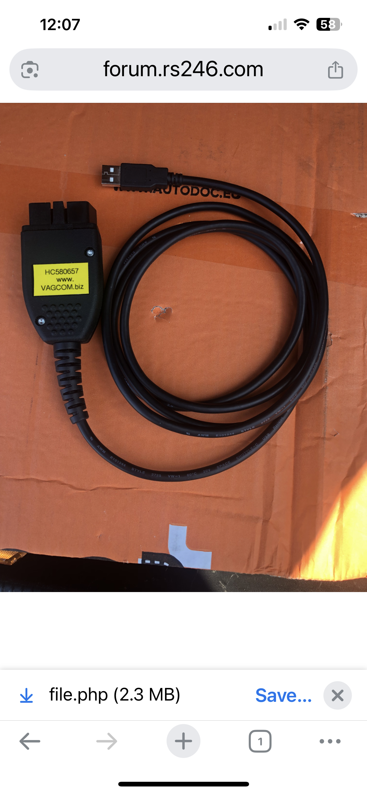

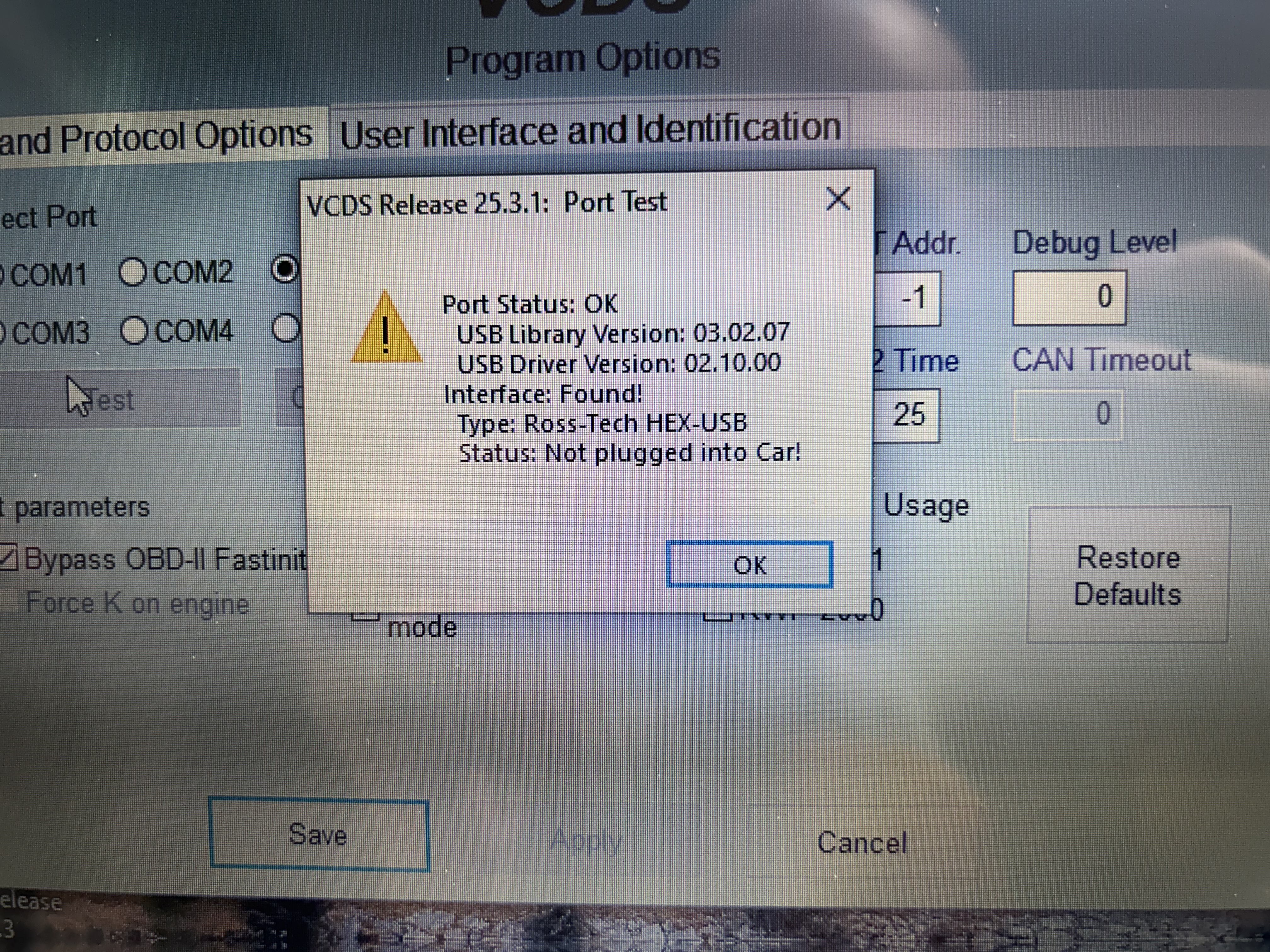

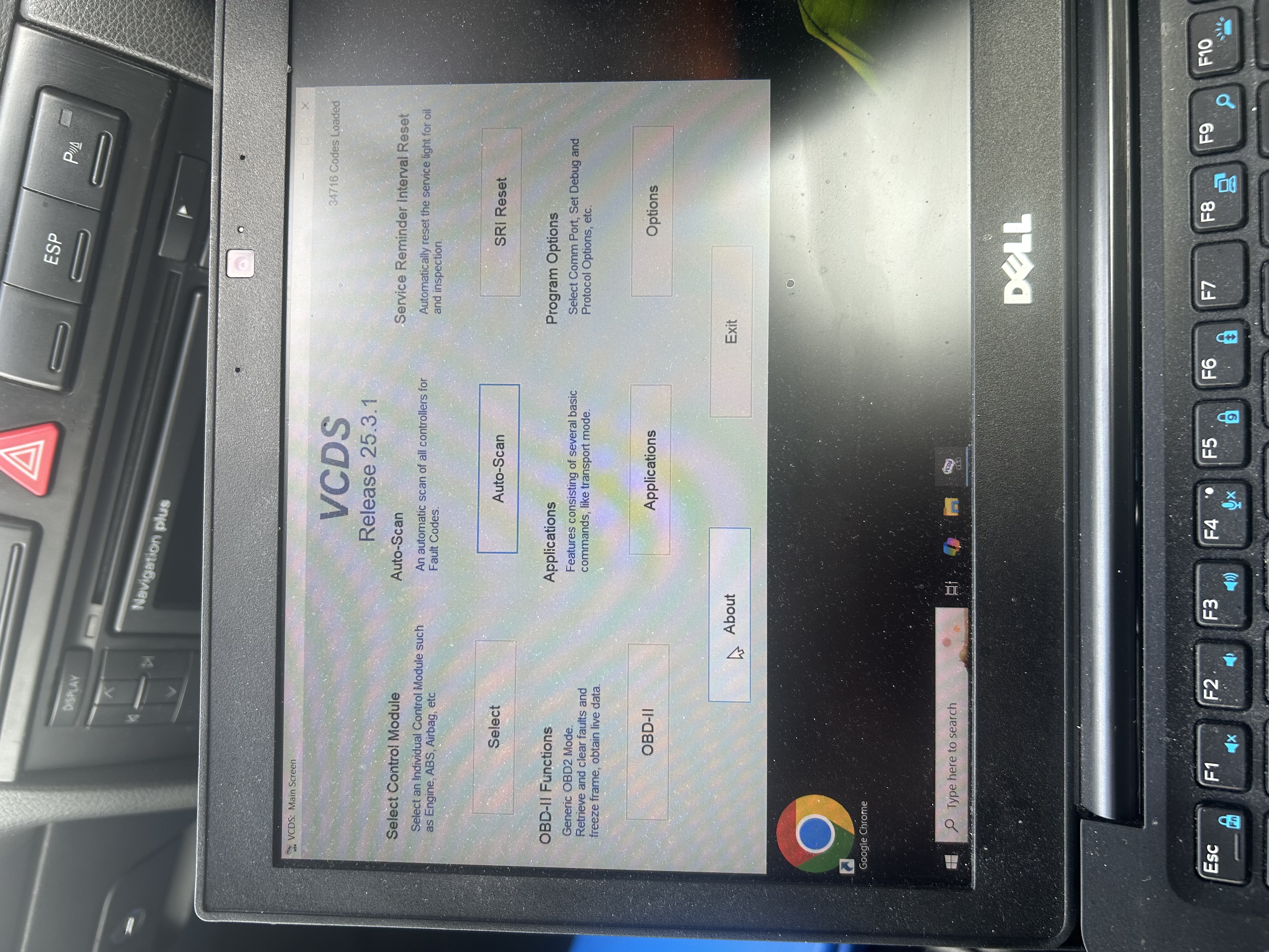

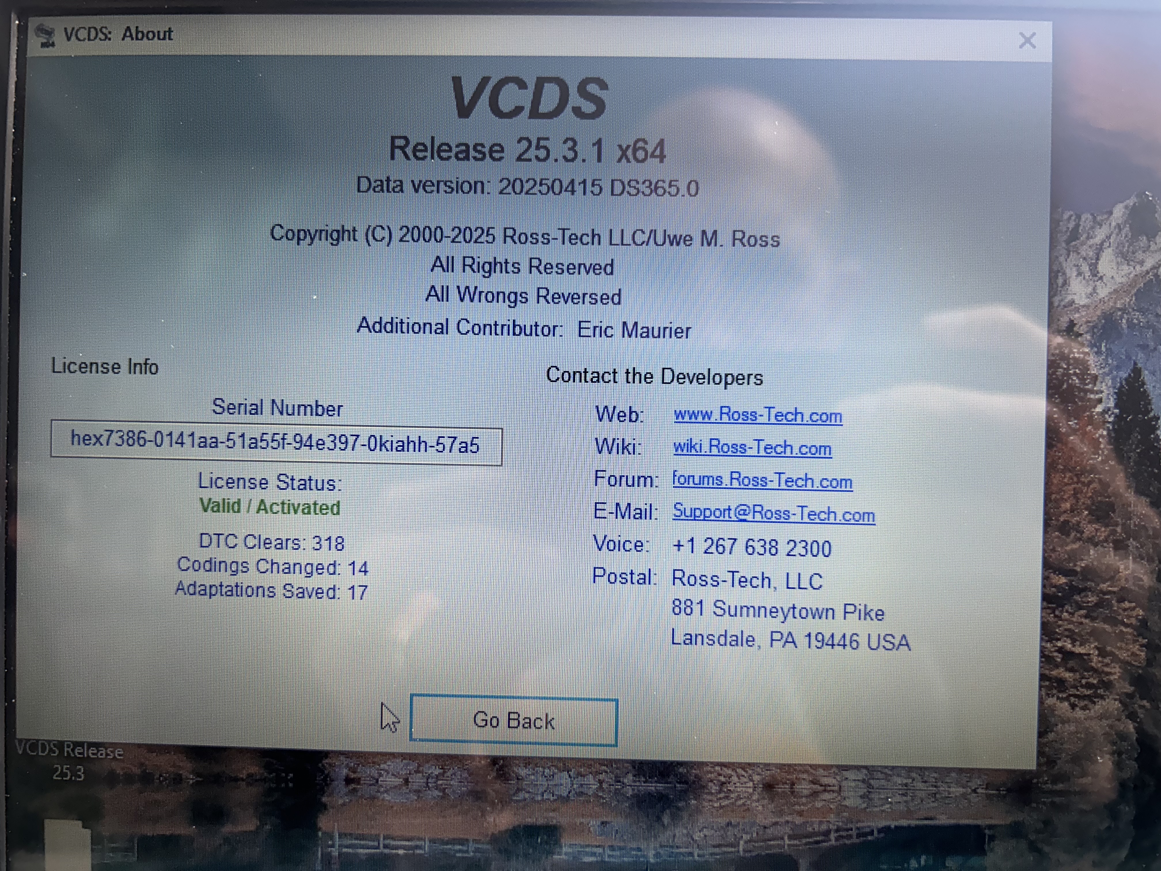

I have mostly used the cable for scans on my 2015 C7 (facelift) RS6 and it has worked absolutely fine but I was trying to lower the standard height on my air suspension yesterday when I got the error message mentioned. VCDS allowed me to do a scan, note down the height of each corner, delete the level control calibration but failed on the restart level control. I managed to get it back with OBDEleven but I started to read into it and spotted the serial number references to hex7386 (I’ve attached a photo showing the full serial number) and confirmation that the licence is valid. It doesn’t pretend to be a Hex-V2, it says it is a Hex-USB (second picture) so maybe that’s why that 7386 serial number is ok in this case?

If I was you I would register the cable with Ross tech in your name.
Where it says licence valid. underneath that is usually your name and registered address.
Looking at the info you have provided. I am even more convinced that the cable is genuine.
Also the gold coloured pins,torx screws and snap in tab adds to that belief.
Let us know how you get on with Ross tech.

I just wanted to provide an update as I have now heard from Ross-Tech and they have confirmed that it is a genuine cable.
My confusion was that I had spotted the negative clone comments about serial codes starting hex7386 (like mine) but the one I have is a genuine hex-usb cable and has a valid serial number.
I still have my error but I will get the cable transferred on their system so I can access their support.
