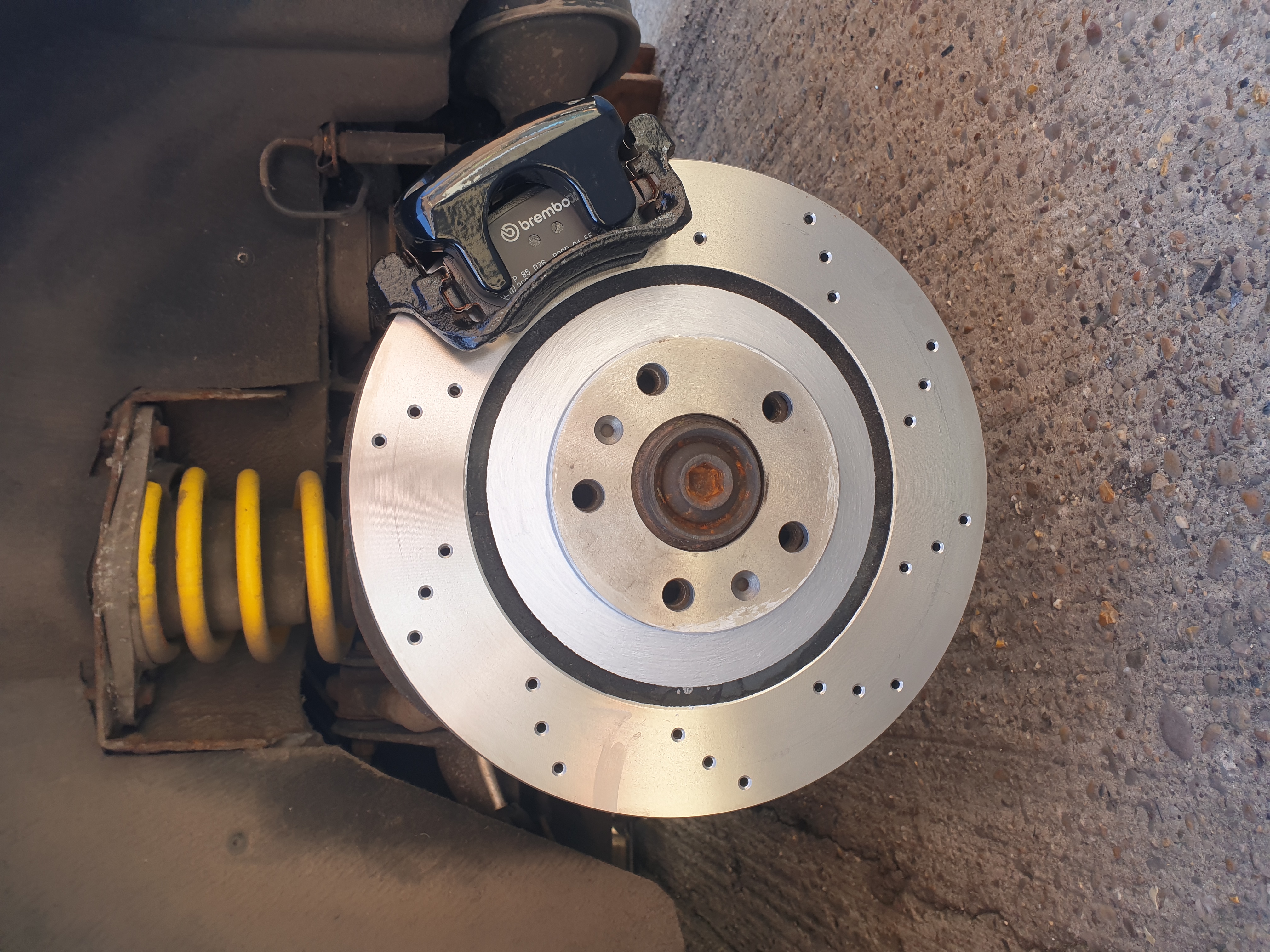

Hold on kids. Don't buy these just yet. I'm in the middle of trying to fit some.
The pcd seems ok, as does the hub centre diameter.
Just trying to work out why these won't go on far enough and mate with the the bolt flange.
I can see that the offset (from rear of disc flange face to edge of disc)is 35mm new vs 40mm original.
Just taking caliper carrier off to be able to get it square on.

Goes on ok without carrier on.
Just going to spacer it out now.

Should have been obvious that it wouldn't go on with carrier on.
Needs spacing. Duh.

One side on.

Is that fitting as standard or with a spacer behind it?

Actually two washers. About 5mm.
I guess no-one zoomed in an saw my half arsed galve paint. Lol.
I think they'll rust up quite quick.
