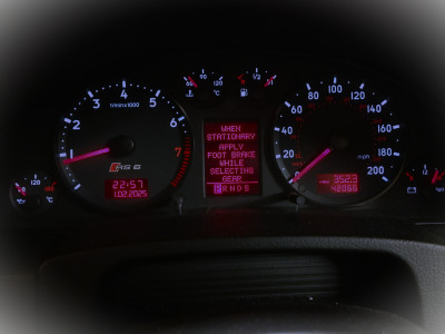

A massive massive thanks to you guys who have helped me over the past 2 to 3 weeks.
Turned the car over tonight after the completion of the work in my other posts re fans and then a rough idle and support from you on Vagcom.
Car fired up and ran smoothly, battery CTEK MXS5.0 remained at fully charged and the fans did not goto full speed on position 1.
I let the car heat up and with Aircon on the large fan rotated slowly, Small fan off. Aircon off and both fans off.
Not been running for a while so let some heat get into the engine and watched the oil and coolant temperature on the dash slowly come up.
Will scan again
Will scan again

Sounds promising.
I'm thinking that you might have a bad contact on the coolant sensor, or maybe even a faulty one. Where did you buy it? Plausibly, the ECU could put the fans on full because it doesn't know how hot the engine is so reverts to fans full on.
