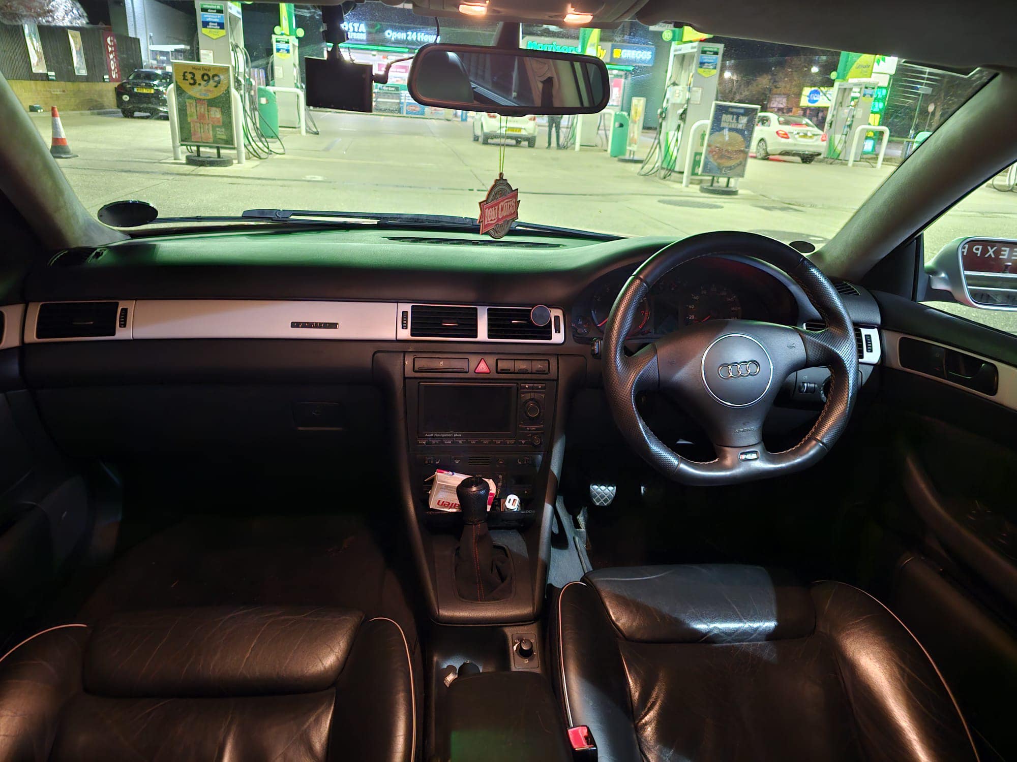

Posts: 20280
Re: new owner,not the best start with rs6
Post by Shoppinit » Mon May 27, 2024 8:50 am

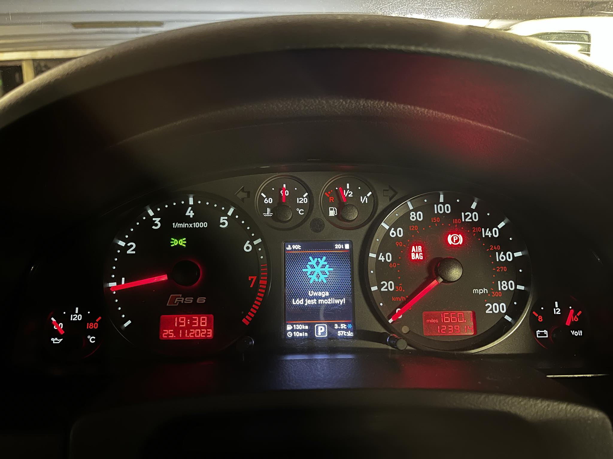

I like your DIS. It looks tidy. What is it?
simonmcc
Posts: 94
Joined: Thu Jun 02, 2011 9:50 pm
Location: Norn' Iron
Post by simonmcc » Mon May 27, 2024 9:34 am
I was thinking the same on the DIS, looks like https://linktr.ee/3dcolormfd ? I’ve been tempted to do that since replacing the RDS with a Pioneer, the top half of the DIS is blank most of the time.

steve2003rs6
Posts: 2935
Post by steve2003rs6 » Mon May 27, 2024 11:13 am
Great post. Really good read and great photo,s.
Another thumbs up for the DIS.

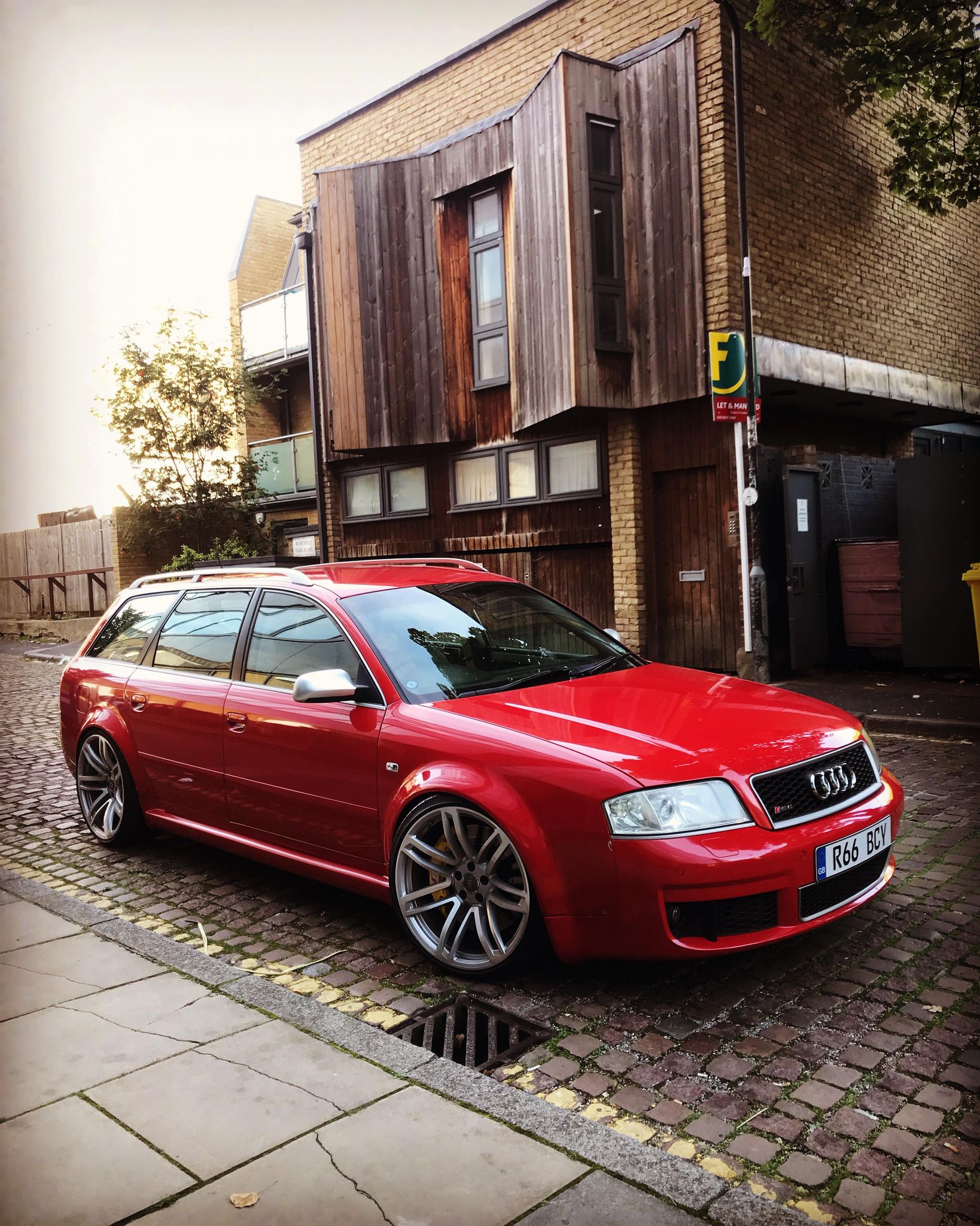

The Le Mans alloys also look great. They just seem to suit the C5.
as Simon said its 3d colour,had this fitted to my rs6 and also to my rs4 b5,not cheap but make it look modern,also you can read and delete fault codes

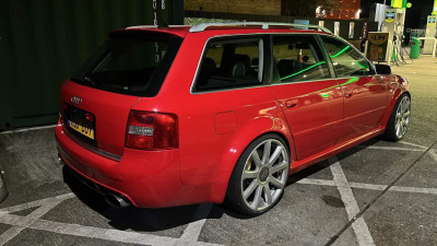

thanks Steve.Had rs6 c7 wheels for over 2 years and was bit bored with them,a8 multispoke suit era of car and they looks very oem,but i think c7 wheels worked very well in c5,also had b8 rs4 wheels for a day,didnt like them and sold them next day

Post by anditsoundslikebells » Mon Jun 03, 2024 9:30 am

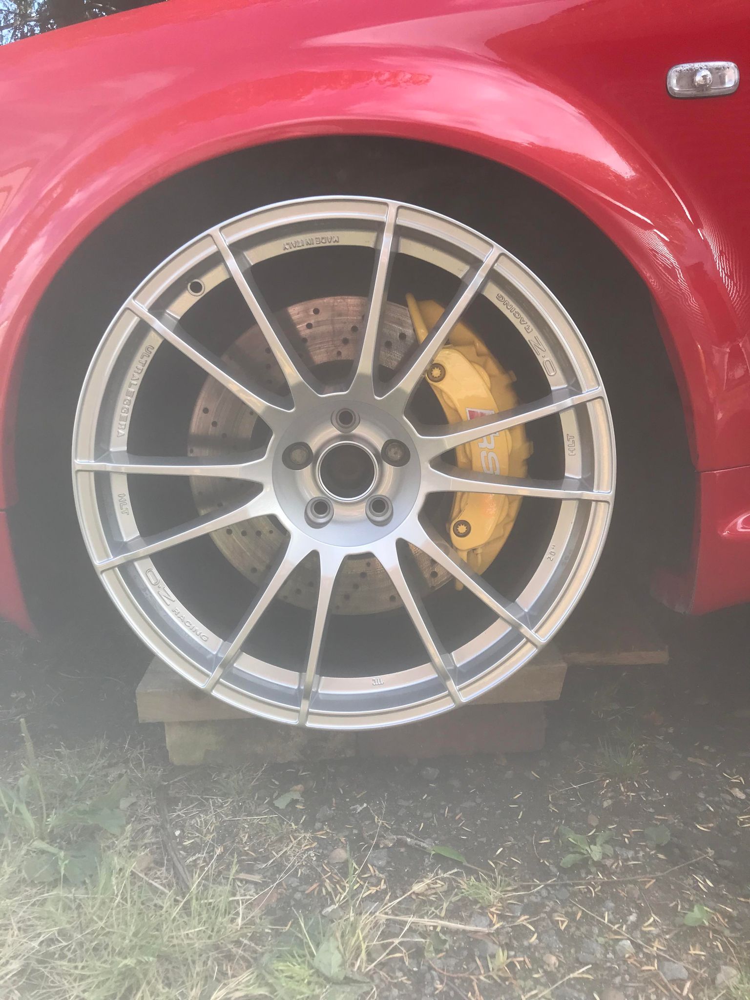

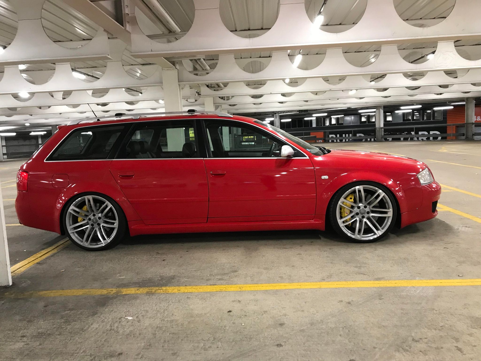

Great thread and build. There are many things here I'd like to get onto my car one day.
I really like those A8 9-spoke alloys. Gives it strong OEM look and a muted style like the rest of the car.
Are all the rims 20"?
RS6 C5 Avant 2002 Daytona Grey
TTH 620 - Wagner IC - OC.T 200cell&downpipes - DW400 pump - 034 TCU chip - FIS - B16 PSS9 - 034 control arms - H&R ARB - OZ Superturismo
rs4wagon
Posts: 278
Joined: Fri Sep 27, 2013 11:55 pm
Post by rs4wagon » Mon Jun 03, 2024 11:48 pm
yes sir,1st one was c7 rs6 9,5x20et21 fitted with conti6 245/30 and a8 multispokes are 9x20et46 with nankang as-2+ tyres 245/30 also.Fitted with 30mm spacers then dropped to 20mm front and 25mm rear.Went to north london on saturday to pick up some audi cantonas 8,5x20 but in England 98% tyre fitter cant do low profile tyres,in the end wasted day and back home with nothing
