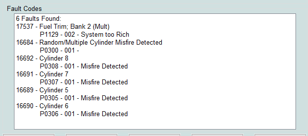

Here are the error codes form last trip.

I see you must have cleared the error codes before doing that run, so that reset your trim values (032). I can see that bank 2 mixture is being made more lean until you get a misfire and fault code.
I think it’s a fuelling issue. So coil pack or bad injector or plug.
It’s not a knock sensor. That wouldn’t cause a fuelling issue.
Could be EGT or lambda sensor.
Could still be exhaust leak / combiner valve.
