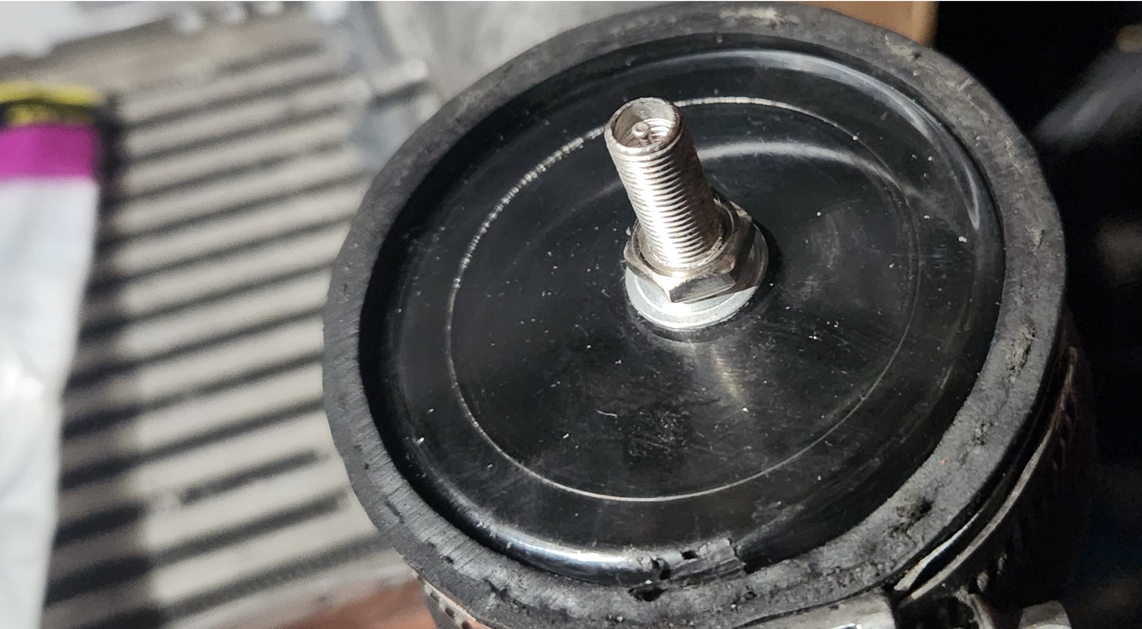

After following SKYEGTBs excellent guide on testing intercoolers and finding a few bits that made it pretty straight forward I thought id put a bit of info on some parts that can be easily bought to make the testing easy.
I must preface this with saying that I had the intercoolers removed with the hoses as well.
In B&Q they sell plastic cups that you put under the feet of tables etc but they are a perfect fit in the large ends of the intercooler hoses , I used these to seal the hoses to do a pressure test
I then bought some threaded schrader valves from amazon
https://www.amazon.co.uk/Emma-Motocycle ... 09&sr=8-17
With these 2 parts you have this
It fits perfectly in the large end of the intercoller hose
Both hoses have a big and small end , so one hose has a large diameter free and one has the small diameter free , on the small diameter hose side the blank has to be fitted inside the hose by the intercooler output flange
the basic diagram below shows what I am trying to get across
You can use a stand up bike pump with a gauge as this should provide enough pressure.
Dunk the intercooleres in a bucket of water and pump away!!
What I found when I tested mine was that the car must of been running normally aspirated as both the intercoolers wouldnt hold any pressure at all , literally nothing!!
I then followed SKYEGTBs instructions and sealed the entire core ends with JB Weld , both intercoolers now hold pressure without an issue , I cant tell you what the performance difference is yet as I am just in final throws of putting the engine back in and conecting it up to here it run (Hopefully !!!!!!!!) for the first time as my 6 was a non running project.
Hope this helps someone looking to do a intercooler test :)

Pps That’s a great test rig for pressure testing the coolers.
