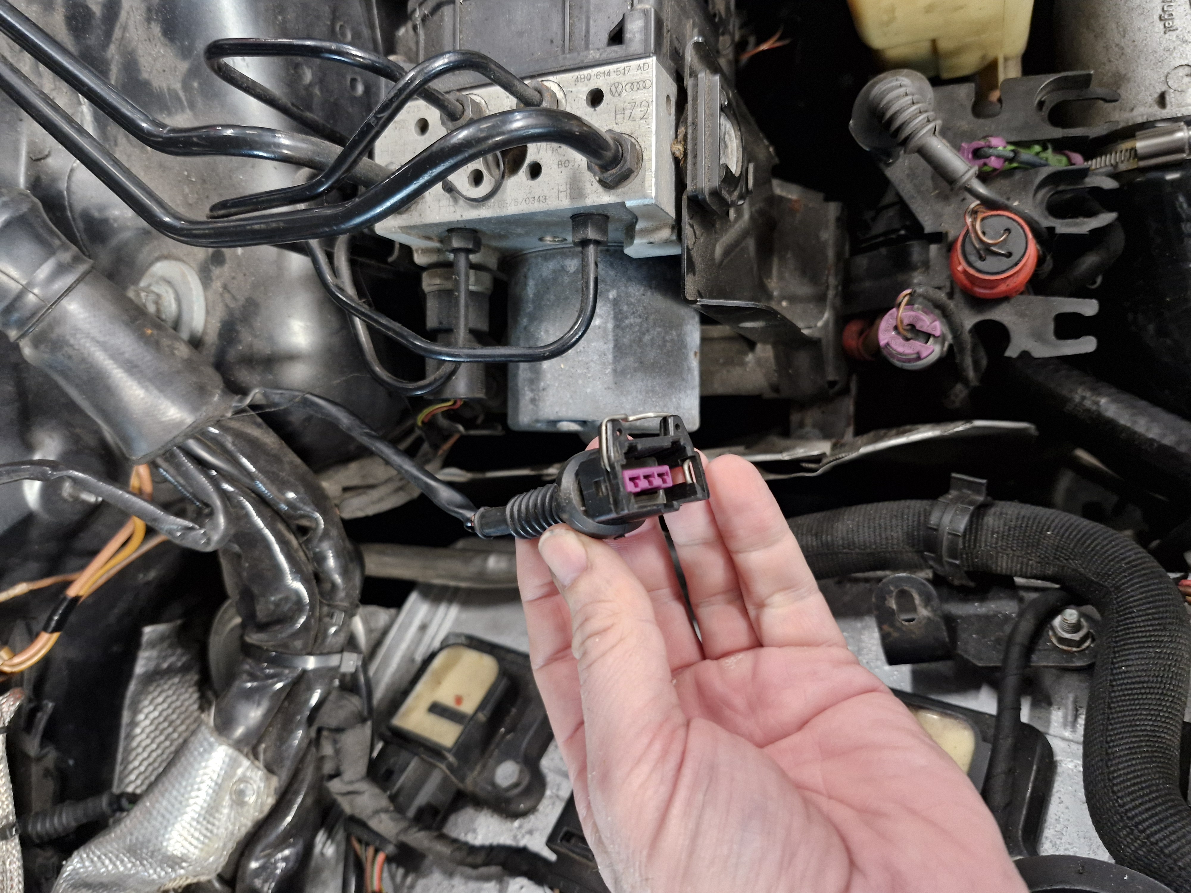

I have been working on replacing the transmission on my C5 RS6 for a while and I am getting to the final bits and pieces before putting her back on the road.
I have this plug that I can't source it's end point to.
Does anybody have any ideas as to.what I am looking at and where it's termination might be?
Many thanks for any assistance.
Richard

Camshaft position sensor? The only thing I can think of with 3 pins and a spring clip.

What colours are the wires?

Or see what fault codes you get with the Vagcom.

Thanks for the answers Shoppinit.
I'll have a look for the wiring colours and let you know.
I had thought about the Vagcom option. Lol

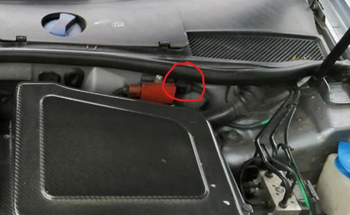

Hello , while I was under the bonnet last night I had a look and I think its the connector the black exhaust gas temp unit , theres two small boxes fixed to bulkhead just by the loom , one brown and one black , i think its for the black one as the brown one has a brown coloured plug.
[attachment=0]rs6.jpg[/attachment
