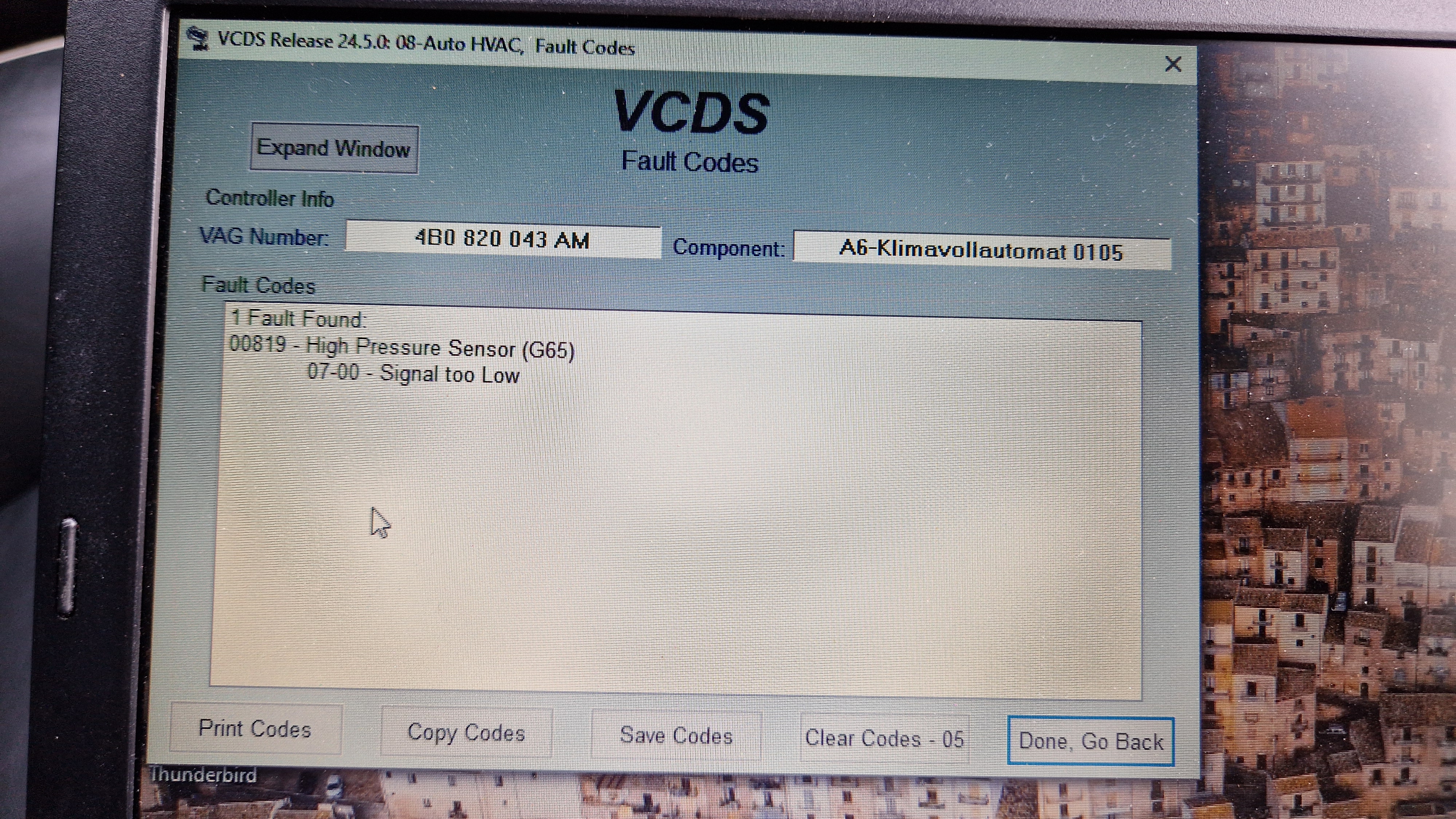

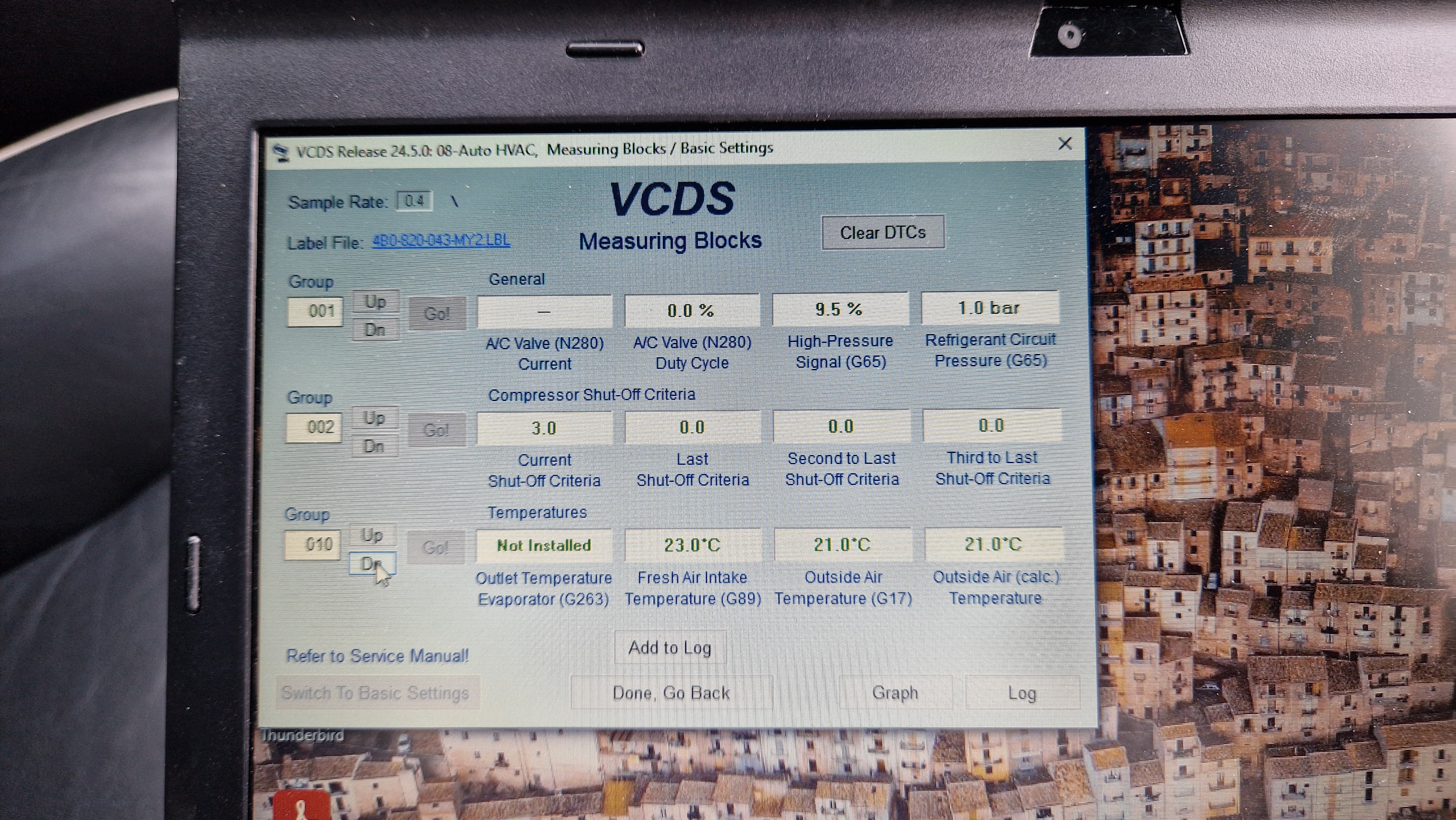

On my 2003 RS6 the AC has stopped working with the ECON light on solidly. I have owned the car for many years and have had the gas re-filled on average every 3 years due to the same thing happening. In the past I didn't even check for fault codes I just correctly assumed that the gas was low and a top up was required, with the system coming back to life after new gas was added. Anyway, this time the same thing happened but on this occasion I did some scanning and the attached fault code 00819 was stored along with the 'compressor shut off criteria' of 3. Am I correct in assuming that I am just low on gas again, or does the fault code from G65 suggest that the sensor may be at fault? I am unable to minitor system pressure with the AC running as the ECON is on solidly. Presumably 1.0 bar is a very low value when the system is idle?

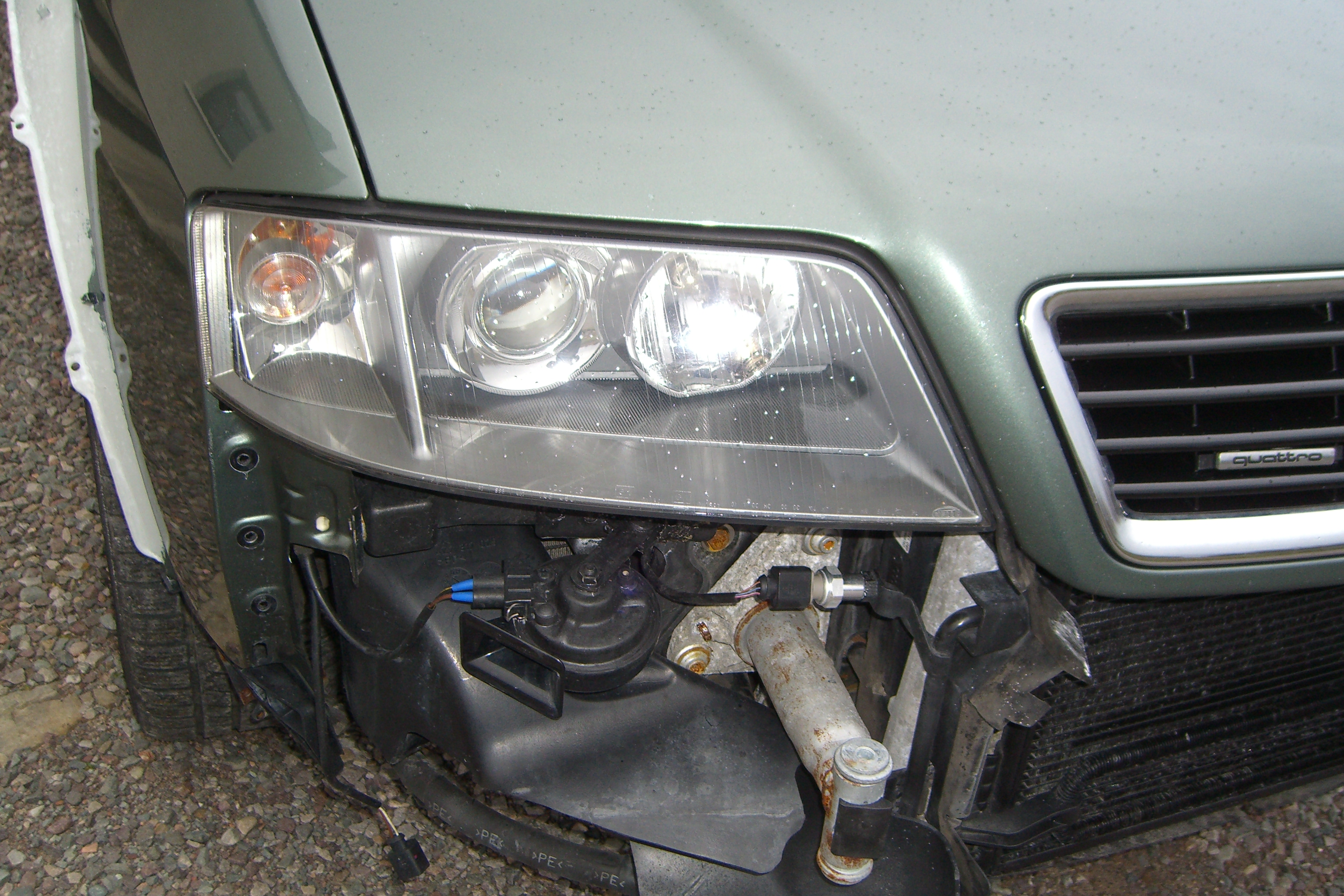

Yeah, I've done them a couple of times on other Audis. Thats the sensor at the drivers side of the AC condenser isn't it? Pic from when I did the one on my allroad. 8D0959482B is the part number, is that correct?

OK, I thought that the sensor was bad as it was giving a low pressure fault and reading 1 bar pressure, but in reality the sensor was good and the system was completely out of gas, and a re-charge fixed everything. Now reading 10 to 12 bar when AC is working. No leaks were found in the system , just the fact the car had been in storage for 6 months not in use and presumably the gas had escaped past a dry seal or something.

Did it myself with an AC Pro bottle. Took the whole bottle and now works like a dream. Been using these bottles for many years now on various vehicles and find them to be really excellent. If you do use one, make sure to add gas before starting the engine, as that will put enough in to get the AC to actually run, as otherwise it may not activate and will prevent gas from being added. After that it takes around 10 minutes of constantly adding a little more at a time. The good thing with Vagcom is that you can monitor the system pressure when doing the work which makes it very easy. I pressurised it up to 12 bar with the AC on full blast, on recirc mode.
I have probably topped the RS6 up 6 or 7 times in the 16 years I've had it, and the last 4 were with these bottles, but on all the previous fills I didn't use the Vagcom. I only used it this time as I was convinced the G65 had gone bad!
