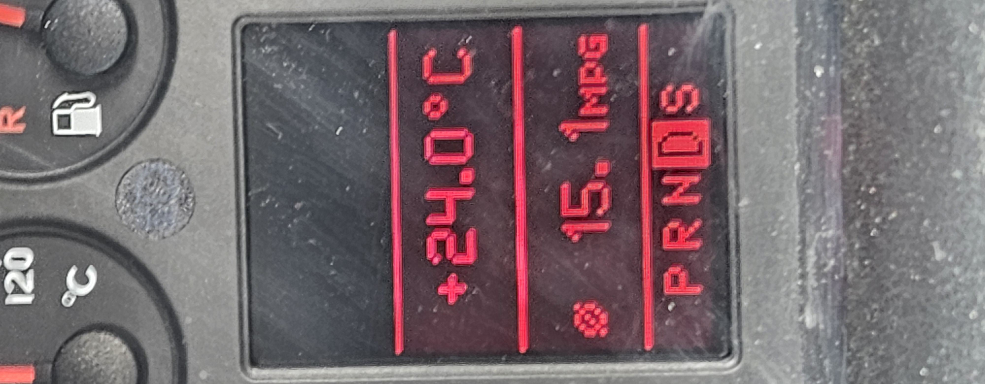

Just wondering if anyone knows how to change the DIS to show the outside temp and MPG all the time , I have changed to a RNS-E and every time I turn the radio on the DIS changes to show the GPS direction. Unfortunately I changed to the RNS-E before I got the car back on the road so I don't know what it displayed before hand with the RNS-D
Pic above is when radio is turned off , this is how I would like it to be all the time , I don't use the satnav on the RNS-E so would rather be able to see MPG. temp ect.
Pic above is when radio is on
I have tried going through menus on the control on the center console but nothing seems to change it , and pressing the buttons on the end of the right stalk also doesn't change anything when the radio is on , everything works fine when radio is off.
I have looked at the coding options foe the RNS-E and as far as I am aware the coding is correct , cant see any coding options to do with DIS characteristics.
Any ideas?

Just press the button under the indicator stalk to get rid of the GPS direction.

Just tried it and it worked , I thought that was the reset button for the mileage ect on the trip computer , you learn something new everyday!
