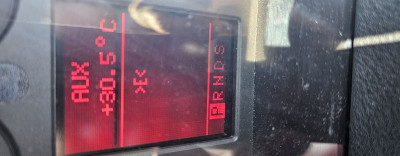

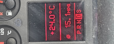

Just wondering if anyone knows how to change the DIS to show the outside temp and MPG all the time , I have changed to a RNS-E and every time I turn the radio on the DIS changes to show the GPS direction. Unfortunately I changed to the RNS-E before I got the car back on the road so I don't know what it displayed before hand with the RNS-D
Pic above is when radio is turned off , this is how I would like it to be all the time , I don't use the satnav on the RNS-E so would rather be able to see MPG. temp ect.
Pic above is when radio is on
I have tried going through menus on the control on the center console but nothing seems to change it , and pressing the buttons on the end of the right stalk also doesn't change anything when the radio is on , everything works fine when radio is off.

Post by Shoppinit » Wed Jun 26, 2024 12:09 pm
Just press the button under the indicator stalk to get rid of the GPS direction.

Post by pwack » Wed Jun 26, 2024 2:06 pm
Just tried it and it worked , I thought that was the reset button for the mileage ect on the trip computer , you learn something new everyday!

Post by Shoppinit » Wed Jun 26, 2024 2:44 pm
Thankyou
This catches everyone out at some point! At least, those with the OE headunits.
