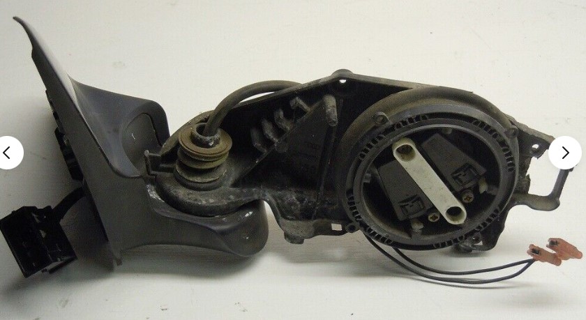

So , bloody fence panel was blown over which landed right on my drivers side mirror snapping it at the cast coupler.
The housing and glass etc are unmarked , does anyone know if the internals of a standard a6 mirror would fit , I know the cover and glass and different but the plastic trim on the bottom has the same part number as a normal a6 mirror.
Was wondering if I could just swap the internals over if I find one wit hthe same number of wires ?

Yeah, I think they are the same. Except some A6 had folding mirrors and/or memory seats so you need to get the right one. What's your part number?

The part number for non-folding is 4B2 858 532BB.
WIth folding is 4B2 858 532BC.
That's for a RHD, right hand side.

Have found the correct part number mirror internals at Prestige breakers on ebay , will update once its here and I have attempted the swap over.

Mirror internals arrived from Prestige , swapped over stainless cover , bottom plastic cover and the mirror glass , refitted and all works , so total cost was £18.
