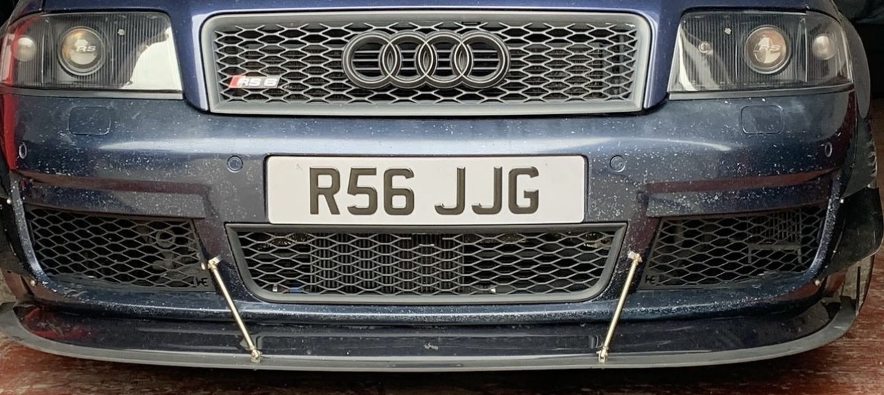

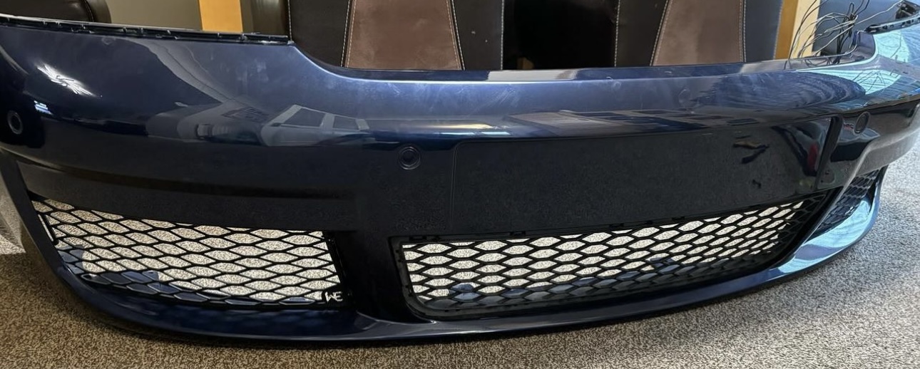

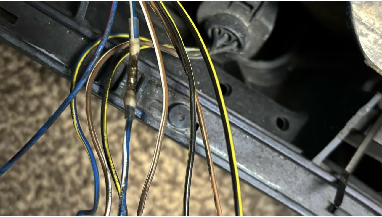

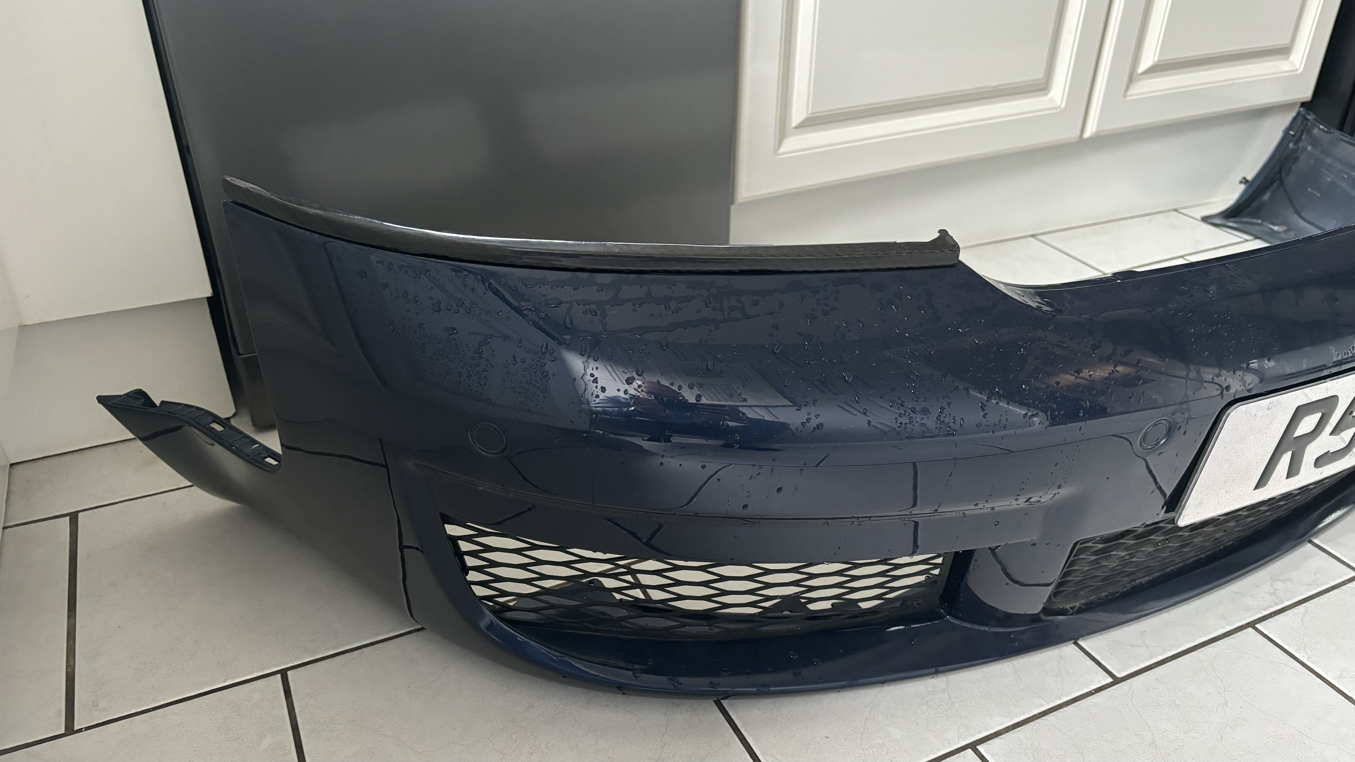

Over the last few weeks I have been doing a bit of work myself towards the build.
First off I send the front bumper off to be resprayed, over the moon with the finish, compared to how it looked before. Then today I actually set about building it back up with all the grills. I also set about sorting the faulty parking sensor problem too. I also removed all the brackets for the fog lights (because race car) weight saving
whilst also re tapping up the whole wiring loom on the front bumper too.

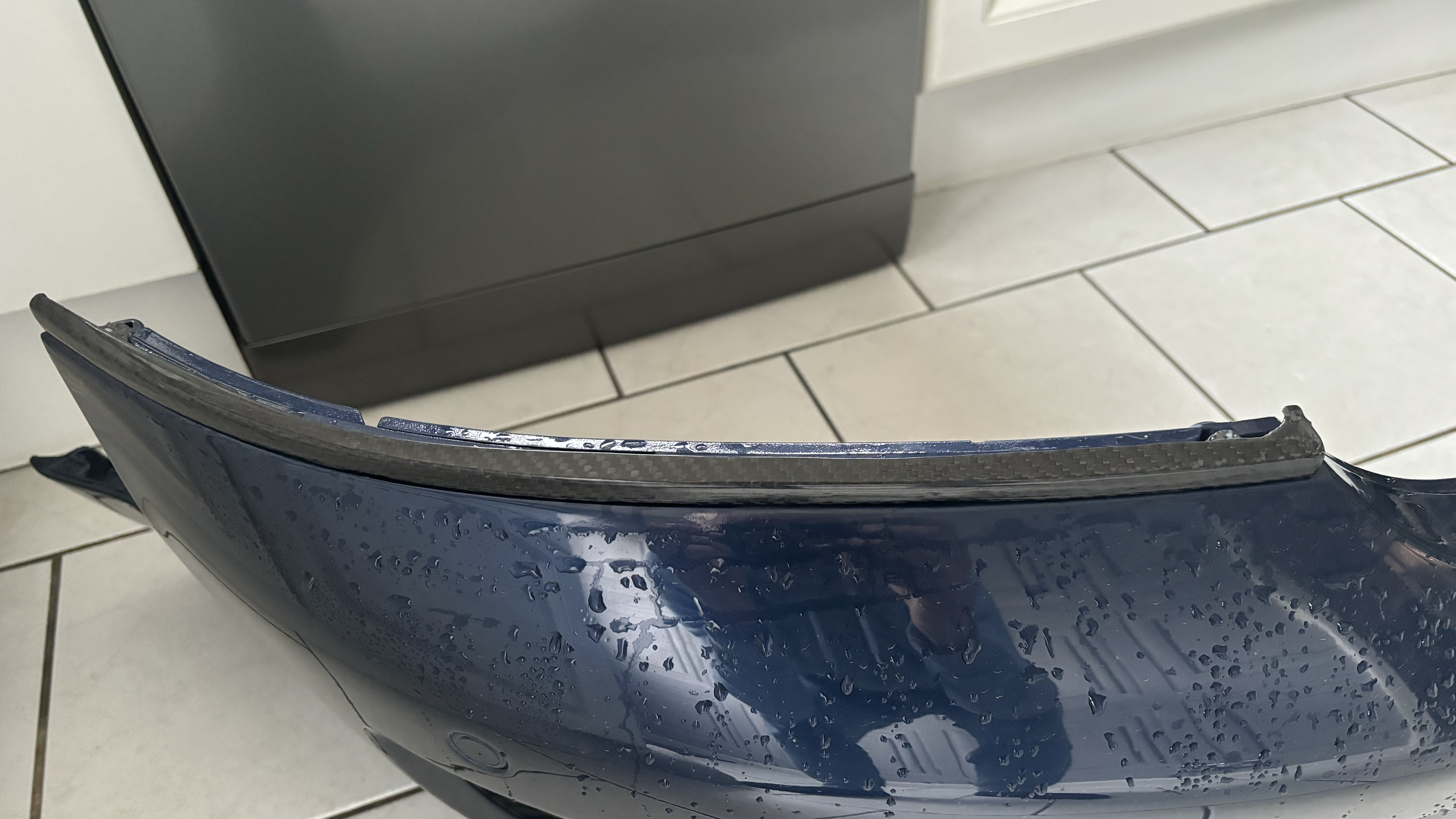

Today I added another part to my front bumper! My carbon fibre under headlight trims
I must say I’m very impressed with the fit and the look
It really does matches what I’m going for in the long run.

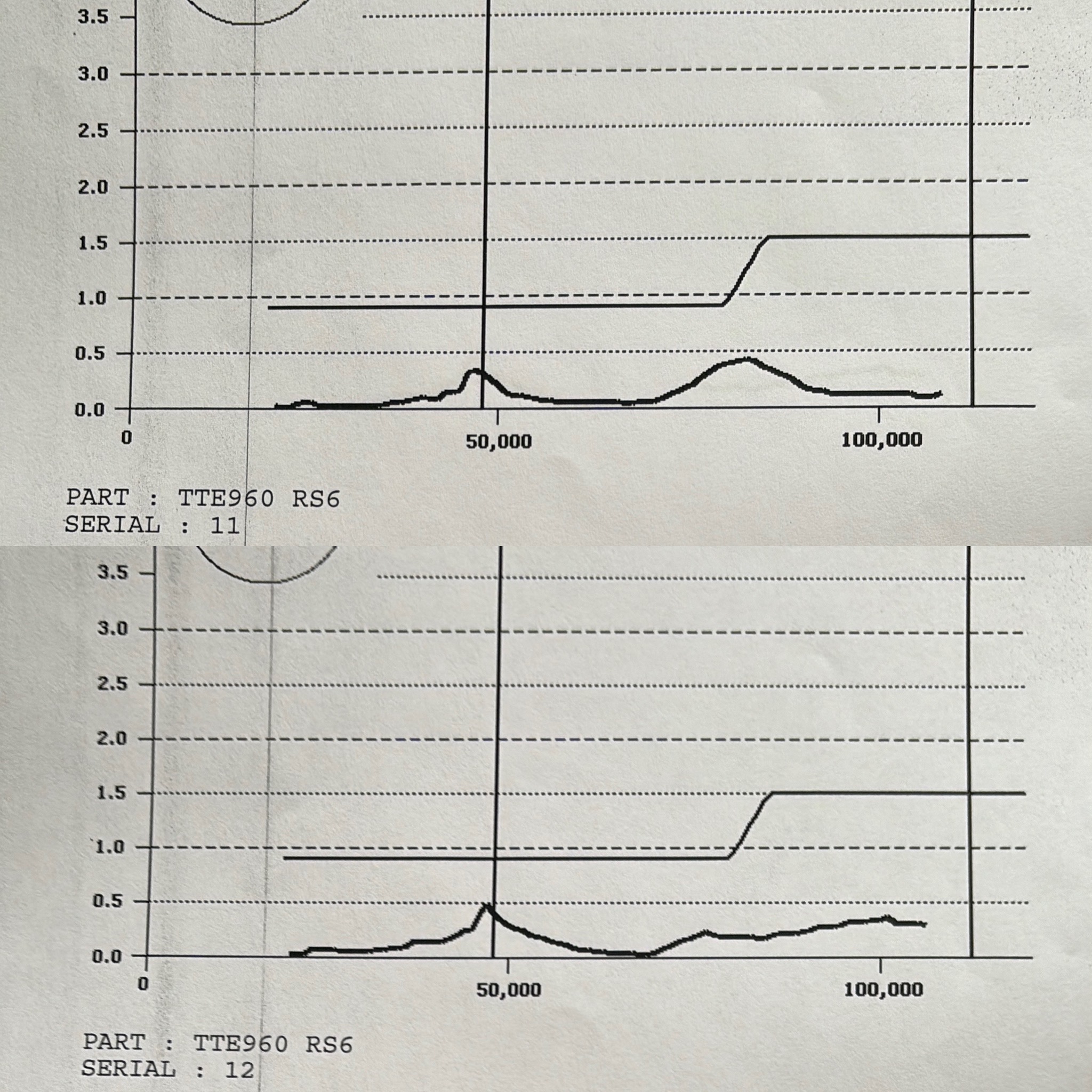

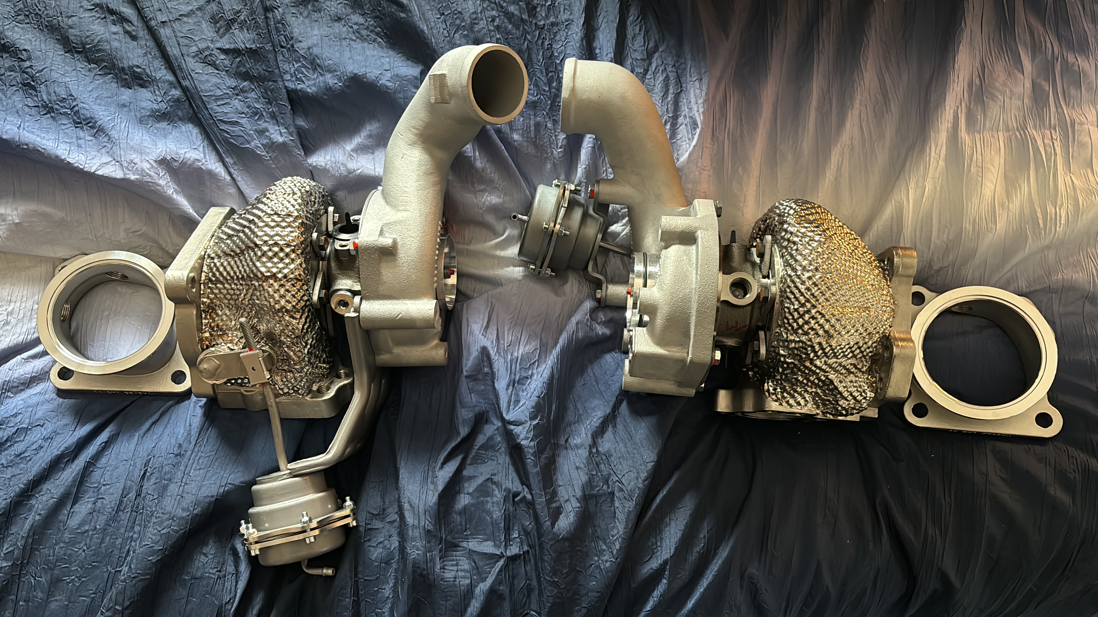

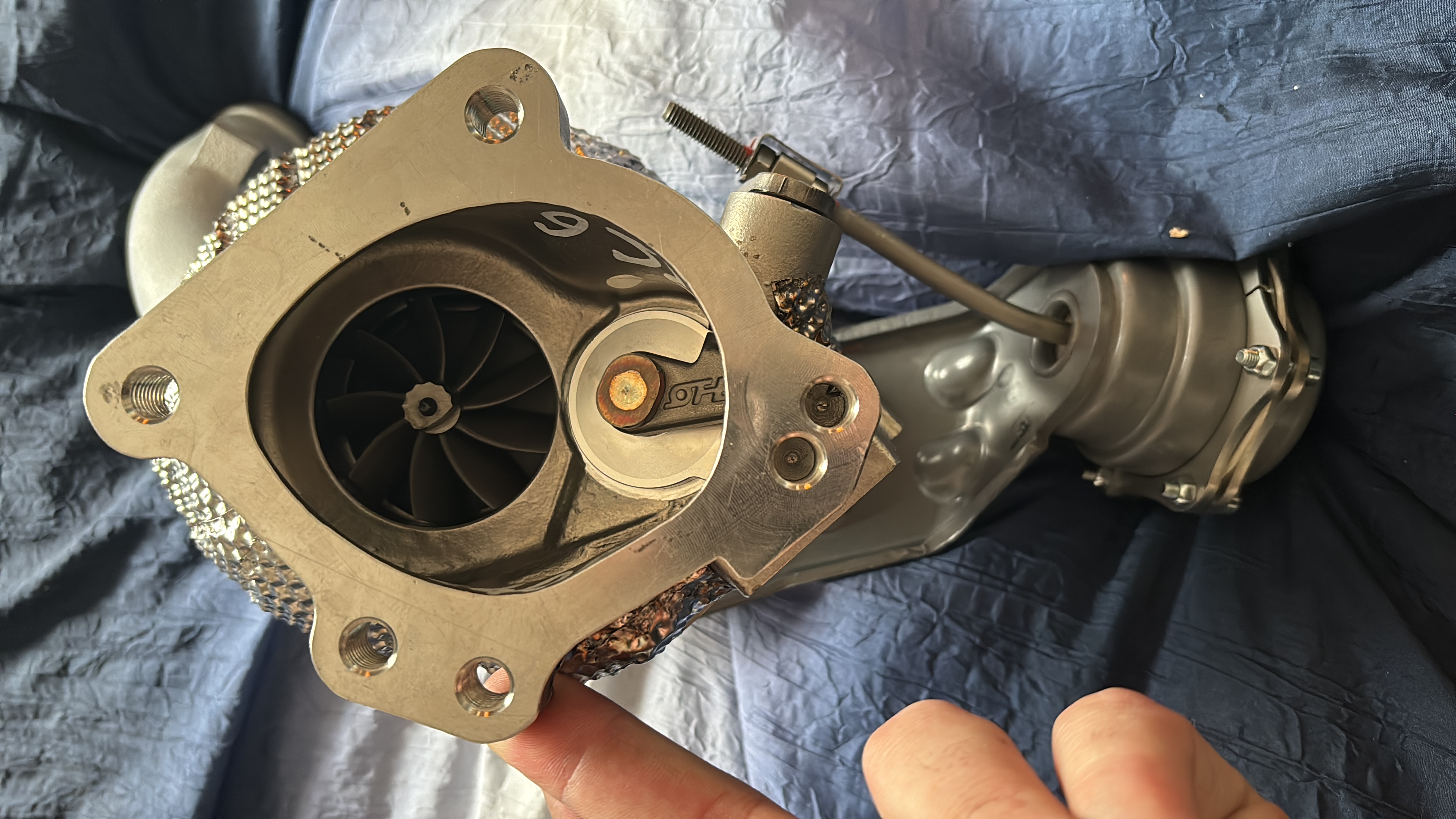

More updates.
Today my carbon fiber bloke has finally finished the very first scuttle panel and coolant res cover flap. I have also received my turbos back from TTE in Germany. What can I say they literally look like brand new but better. Above are the results from the dyno the turbos had after being modified in to the 960’s they are now. As you will see in 1 of the picture I also opted for the 08 exhaust housing adaptors.
Now just for some picture porn (enjoy) I also went with the thermo coating on the hot side of the turbos too. All in aid of helping the engine bay temps stay low. The 08 exhaust housing and down pipes will be getting sent away for ceramic coating again just to help with heat management
I have also had an update my carbon fibre prop shaft is being collected tomorrow for shipping too
