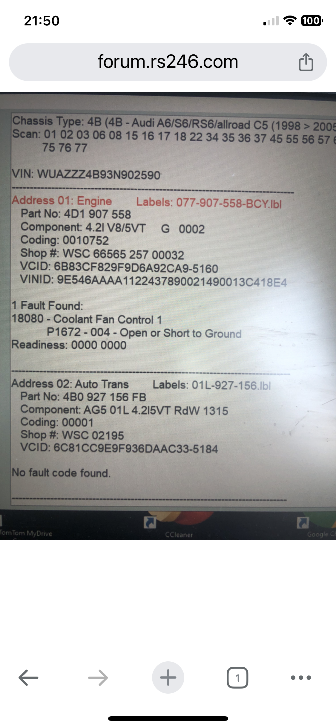

Just a thought. When my fans had a fault IIRC Vagcom showed that there was a fault.
Update. Looking back I found this.
Re: Apikol Intake - Heat Soak
I will give it a scan when i get chance, luckily its just a toy and not a daily! Thanks mate
