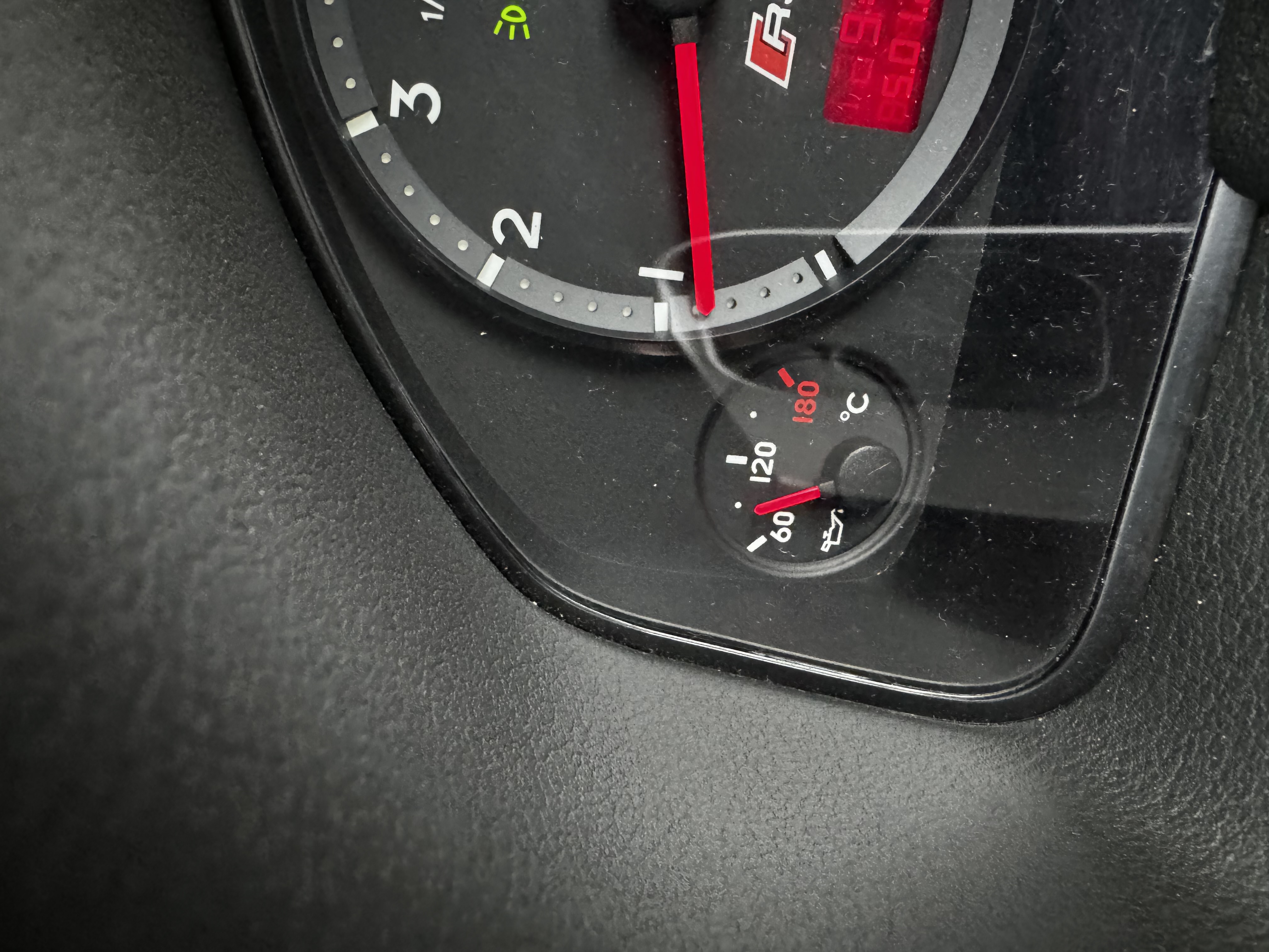

Re: Normal oil and coolant temperatures
This is where the needle is sitting right now - post spirited drive when the oil cooler / thermostat seems to be doing its job.
If I was now to go in a leisurely drive out of town at around 50pmh minimum revs it would cool even further and drop to around 70C at which point the thermostat closes and the oil temperature climbs all the way up to 120 again. Like a yoyo.
