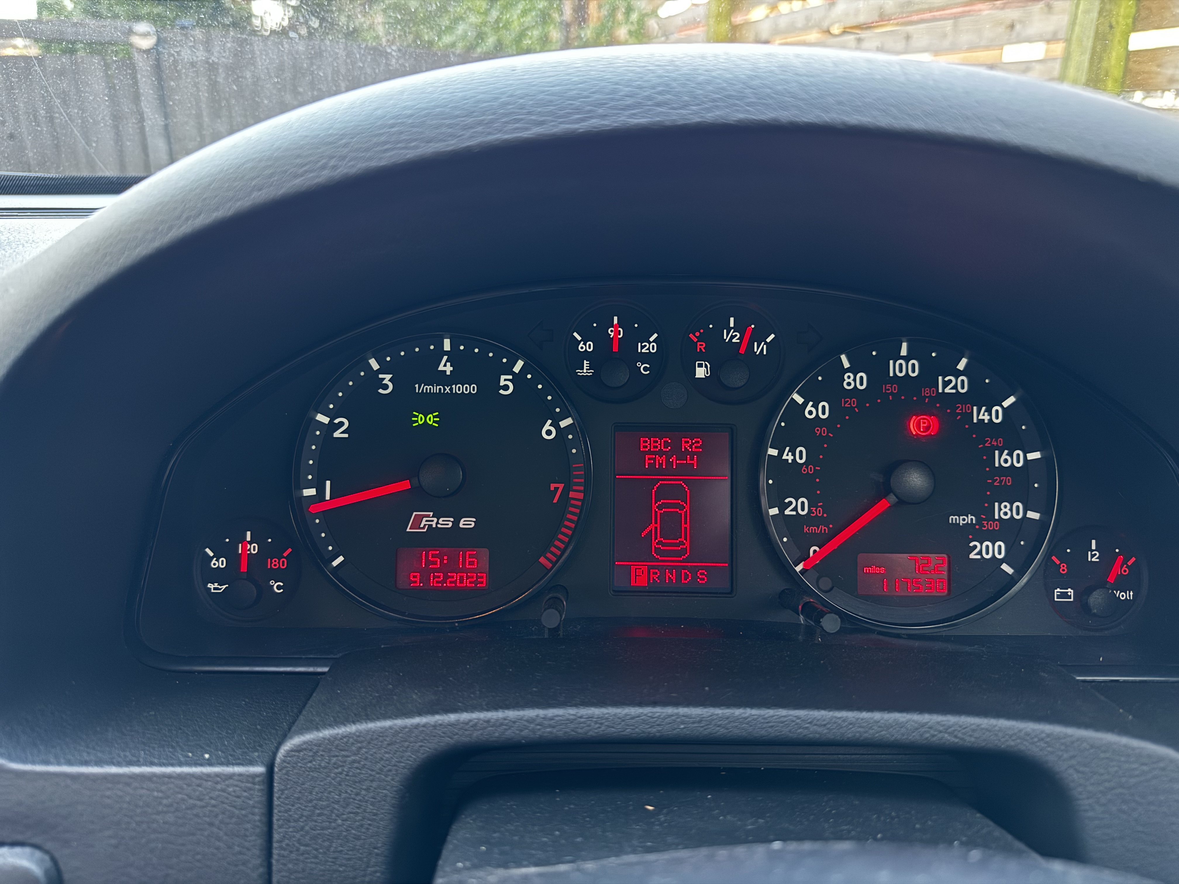

So had a new Mann filter and Shell 5w40 oil put in today and it’s made a difference, although not completely remedied the issue.
Went for a 40 minute drive. The oil temperature sat(as indicated in the gauge) fairly comfortably between 100 and 110 degrees. Which is a great improvement over the 120+ indicated before.
I got to some standing traffic and it slowly raised to 120 again and wouldn’t come back down.
Will go for another drive tomorrow and see what happens after a linger stretch.
Conclusions so far are that the oil spec or filter has made a difference - but ultimately it still ends up hot.

Re: Normal oil and coolant temperatures
I have acquired an infra red gun thermometer and taken a reading from the oil filter. (Easier than getting underneath with the heat Sticker)
Gauge is reading 120 as per normal but I’m getting 105C on the thermometer.
So the sensor might be over reading…. Where is it located? Oil sump pan? Is it simple to replace?
I will finally try to get VCDS running to get readings from there, but would they be false if the sensor is faulty anyway?
