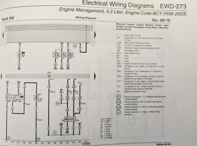

There's no mention of that pump in Bentley's but I found an interesting mention in the diagram for "V51 : After Run Coolant Pump" ... not sure if that's the right one or not, please see image attached. Link to the part at AUDI Tradition:

I should point out that this pump is a brand new unit out of Audi Tradition, 077121599A is the part I ordered & what I've been invoiced for. The original pump had the electrics exposed & corroded so I figured the previous garage had not bothered to plug it back in when they couldn't locate a new one. I do have Elsa which has been a massive help and with a bit of homework I have discovered this:
My problem is the connectors are quite different. Maybe I am missing a length of wire with different ends??
Thank you so much for your replies!

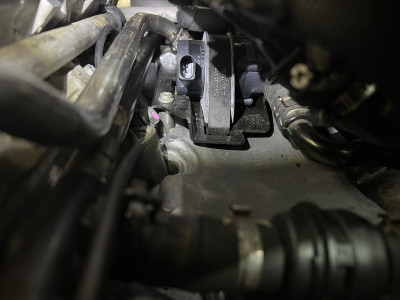

Why has the pump in your pic got a different part number?

Looking at it closer, I think the part num visible in the pic is the one for the latch holding the pump.
That connector looks familiar. I'll be in the garage later and take another gander.

I tried to buy it myself but of all the countries listed, NZ is not there! To save time I have asked the dealer to supply those two connectors and i'll make my own harness. It's only two wires.
Astrosquirrel, could I please have a clearer pic of the EWD? I tried to zoom in but I'm going cross-eyed
