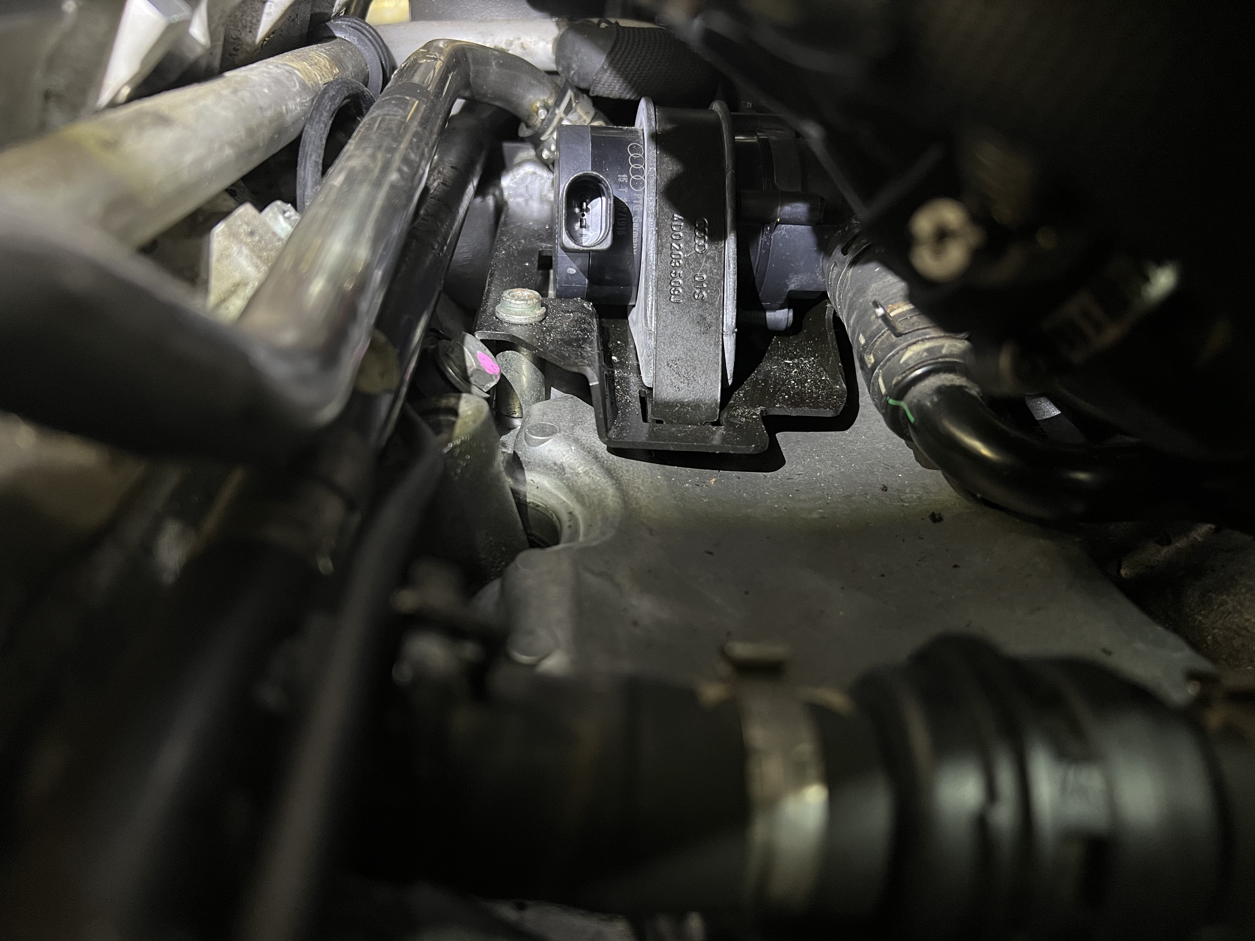

Hi all,
First time post so bare with me.
I am attempting to fix a 2003 RS6 Advant C5 BCY engine which was pulled apart and incorrectly slapped together. The PCV system was thrown together & as a result I have had to replace many broken parts and blown seals along the way. One of these parts was the auxiliary water pump under the manifold.
My problem is, now that the manifold is going back on, I can not for the life of me find the wiring connector that fits the electric pump. All connectors along the loom are accounted for except one square connector which I'm sure will make sense once I've put secured the manifold down. The connector for the pump is small and half rounded.
Is there anyone who could point me in the right direction? Either with a picture showing where the wire connects into the loom or even a wiring diagram. Any help would be super appreciated.

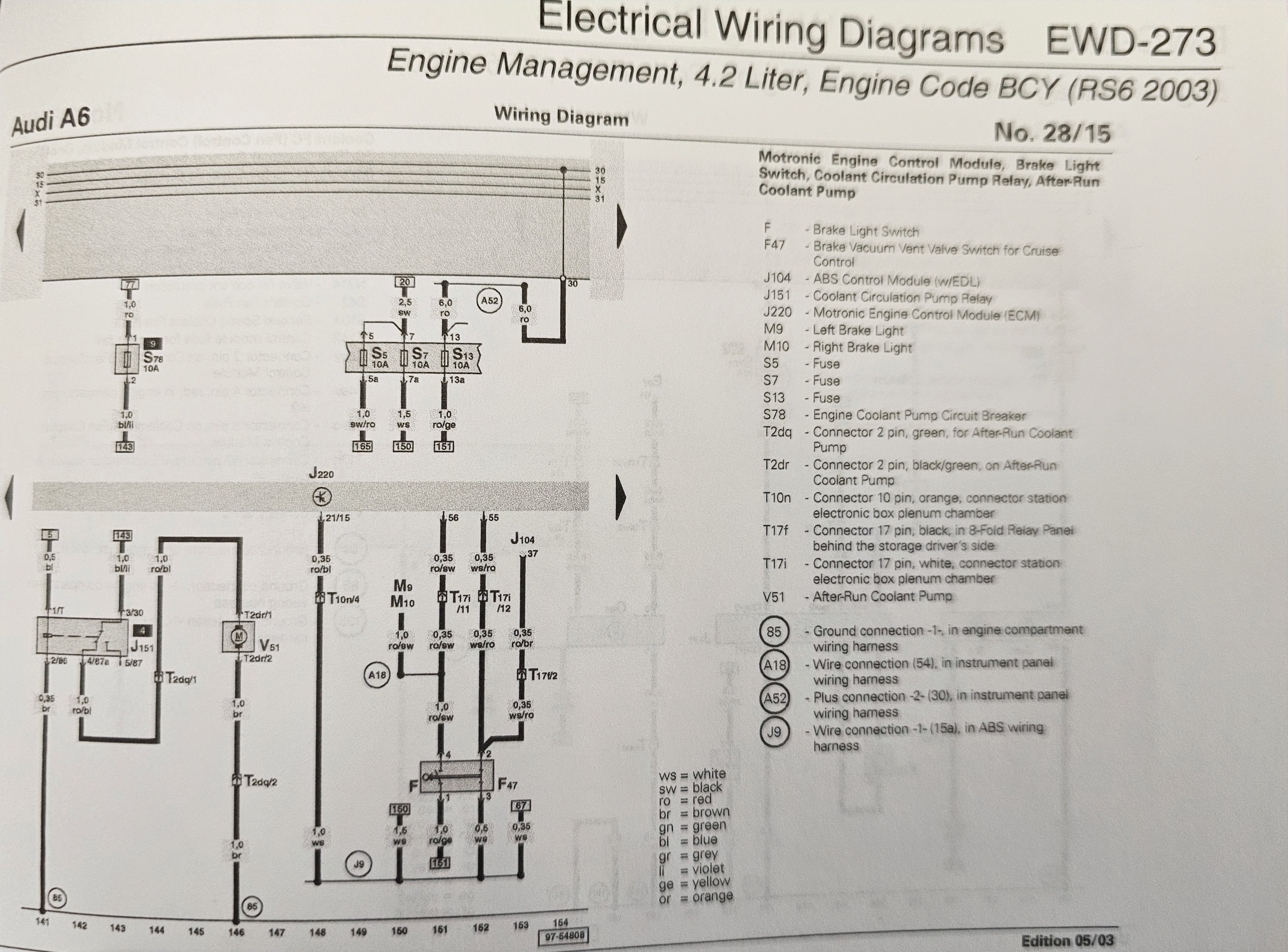

There's no mention of that pump in Bentley's but I found an interesting mention in the diagram for "V51 : After Run Coolant Pump" ... not sure if that's the right one or not, please see image attached.

I should point out that this pump is a brand new unit out of Audi Tradition, 077121599A is the part I ordered & what I've been invoiced for. The original pump had the electrics exposed & corroded so I figured the previous garage had not bothered to plug it back in when they couldn't locate a new one. I do have Elsa which has been a massive help and with a bit of homework I have discovered this:
My problem is the connectors are quite different. Maybe I am missing a length of wire with different ends??

Why has the pump in your pic got a different part number?

Post by Astrosquirrel » Sun Aug 06, 2023 7:12 am
Looking at it closer, I think the part num visible in the pic is the one for the latch holding the pump.
That connector looks familiar. I'll be in the garage later and take another gander.

I think you're correct there Astrosquirrel. I'm going to look into whether there is a missing piece of loom..

Astrosquirrel, could I please have a clearer pic of the EWD? I tried to zoom in but I'm going cross-eyed :D
