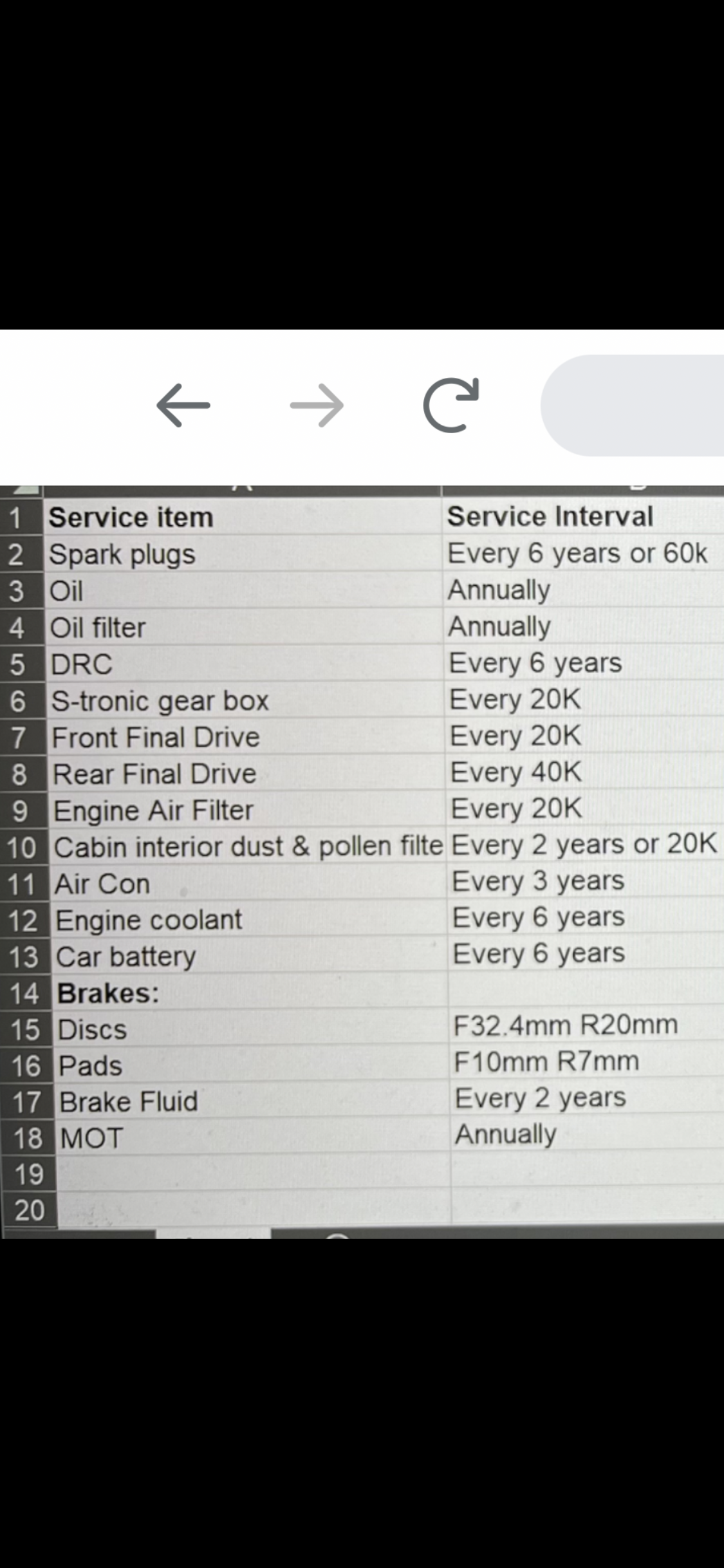

Service items / intervals
I thought wow that is extremely interesting and just the sort of info I was looking for, as a quick reference guide.

Except it’s mostly wrong. For example, plugs are 20k miles. DRC can’t be serviced. The RS6 doesn’t have an S-tronic gearbox.
I will try to come up with a proper list.

Brilliant Ben.
I was looking for a quick reference guide.
Yes mate some items don’t apply.
Being a thickey. I find the service manual a bit of a pain.
Cheers mate.
