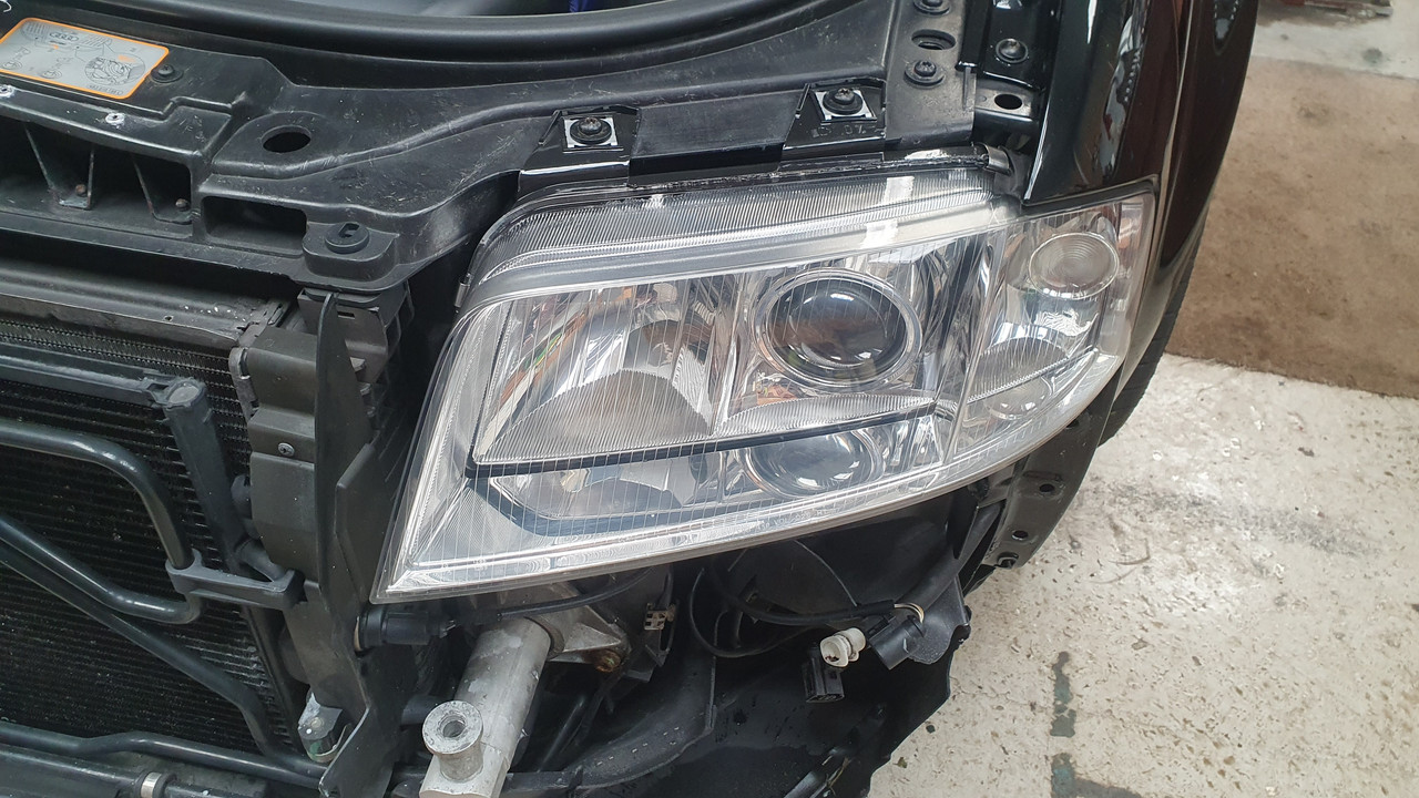

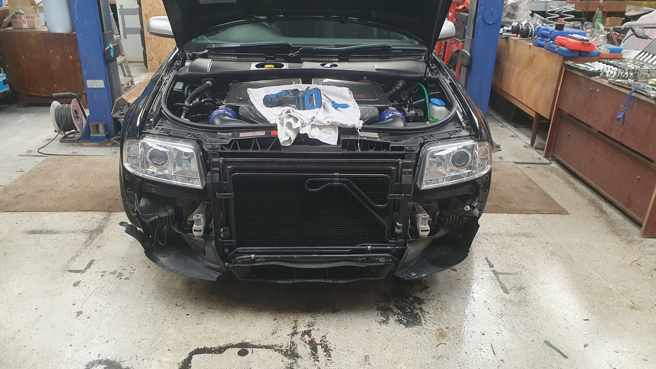

OK, I actually know how to manually raise my headlight aim and have done it numerous times over the years, using Vagcom in block 55 to set the 'level' then turn the cogs on the headlight to raise / lower the beam and then 'confirm'. I do however have a long running problem with my lights, and that is that even with the manual aim at the maximum for both lights it is still lower than I would like, and does not give enough distance range on dipped beam. Therefore, the question really is 'How can I raise the headlight aim above the maximum that the adjusters will allow'!
To give more background, I have just fitted 2 replacement lights to the car. I refurbished these over the winter and replaced the damaged / missing adjuster cogs and re-lacquered the lenses to make them like new again. Both the original lights on the car had the typical missing adjuster cogs and one of them was broken inside and will require gluing to repair.

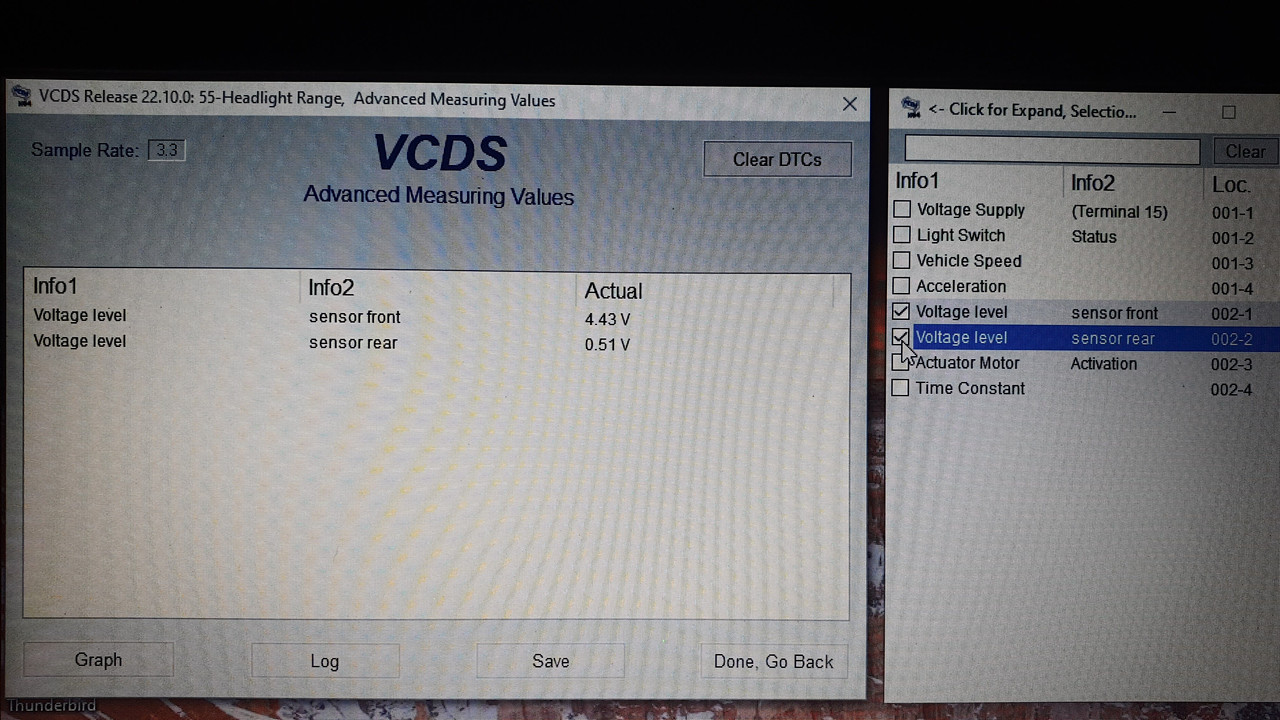

Anyway, the old lights were adjusted at their max height and just about gave me the beam that I desired, perhaps just slightly low, but just about acceptable. The new lights I just fitted are just about the same, but again totally maxed out on the height adjuster. I have checked everything over on the car related to the automatic height adjustment and everything is in spec and no fault codes are found. The lights always do the 'self levelling' test when turned on and generally everything is normal. For info, I disconnected the self levelling arms on the front and rear suspension and tested the voltage with Vagcom - they both read from a minimum of 0.5V to a max of 4.5V. When the car is sitting on level ground the front voltage is 2.03V and the rear is 1.83V - all within limits. I also tested the headlights moved when these were manually adjusted by raising the car off the ground on my lift, and manually adjusting the arms. I confirmed that the aim would lower and raise depending on the movement of the front / rear arms.
As the bumper is off the car I have played about with the mounting screws to tilt the headlight upwards as much as possible before tightening the screws, but this does not achieve a particularly big improvement. So, is there any way to get these lights to aim higher and possibly allow me to not have them at the max height adjustment all time?
