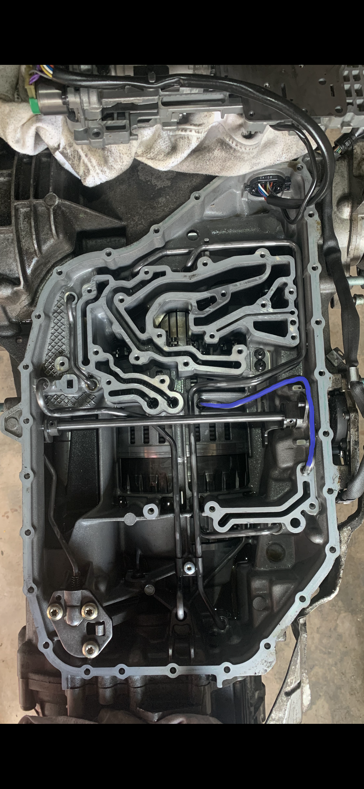

Post by Captain Cowpat » Sun Jul 02, 2023 7:37 pm
I’ve attached a photo of the gearbox underside as I’ve got it on the bench. Hopefully it will show up.. just wanted to confirm which pipe is the culprit when you loose pressure to clutch pack A for 1st and 2nd?

Post by JamesLawrance » Thu Jul 06, 2023 5:03 pm
That's the normal pipe that fails. Cracks where it goes into the casing. Also the sumps are very thin on this transmission, and the filters sit very close, so a lot of filters get cracked or explode.

Post by Captain Cowpat » Sun Jul 09, 2023 12:11 pm
That’s great James, thanks. Thinking it was that one feeding clutch pack A. Many guys on here know that that particular clutch drum splits with the excessive pressure caused by the worn oil way on the pressure relief valve circuit. Can we conclude that this oil feed pipe splits, caused by the same pressure spikes I wonder?

Post by JamesLawrance » Tue Jul 11, 2023 12:32 am
Yeah, that pipe is prone for splitting. Pressure leaks off causes the clutch to burn out.

Post by philS2 » Sun Jul 30, 2023 11:40 am
Damn it. I replaced the smallest pipe (top left) for the 1st to 2nd flaring.
It was split at the flange and when replaced, did reduce the flaring by 90%.
Wonder if I should have changed the highlighted pipe too.
My box had uprated TC/problematic seals replaced and new clutch packs in 2019 and none of these fixed my flaring.
Only when Shoppinit reminded me of the small pipe, did my flaring reduce dramatically.
