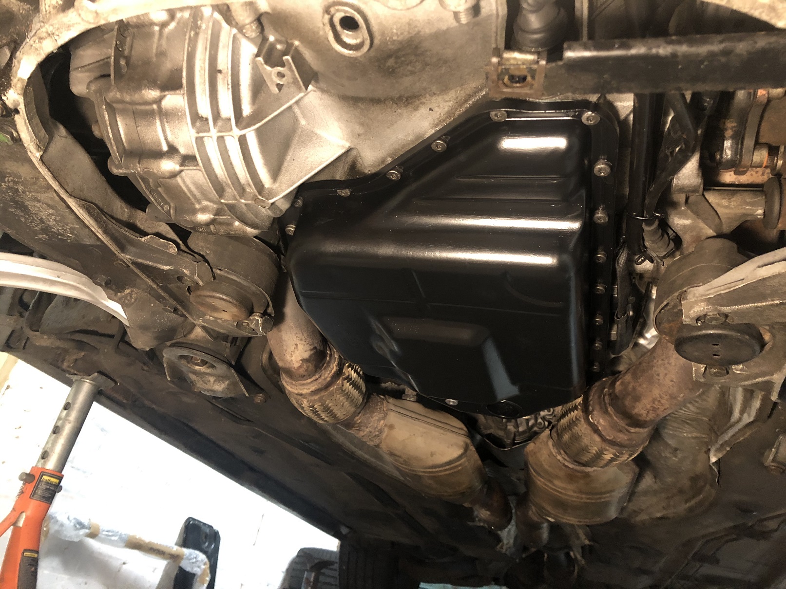

These are the official ZF docs. Note that despite Audi saying sealed for life, ZF do specify servicing - for ALL the 5HP and 6HP gearboxes. Gave the sump a lick of paint while it was out. Bit of a quick and dirty job TBH, but want to stop it rusting. Will get a replacement powdercoated when I can find one.

All bolted up and looking OK

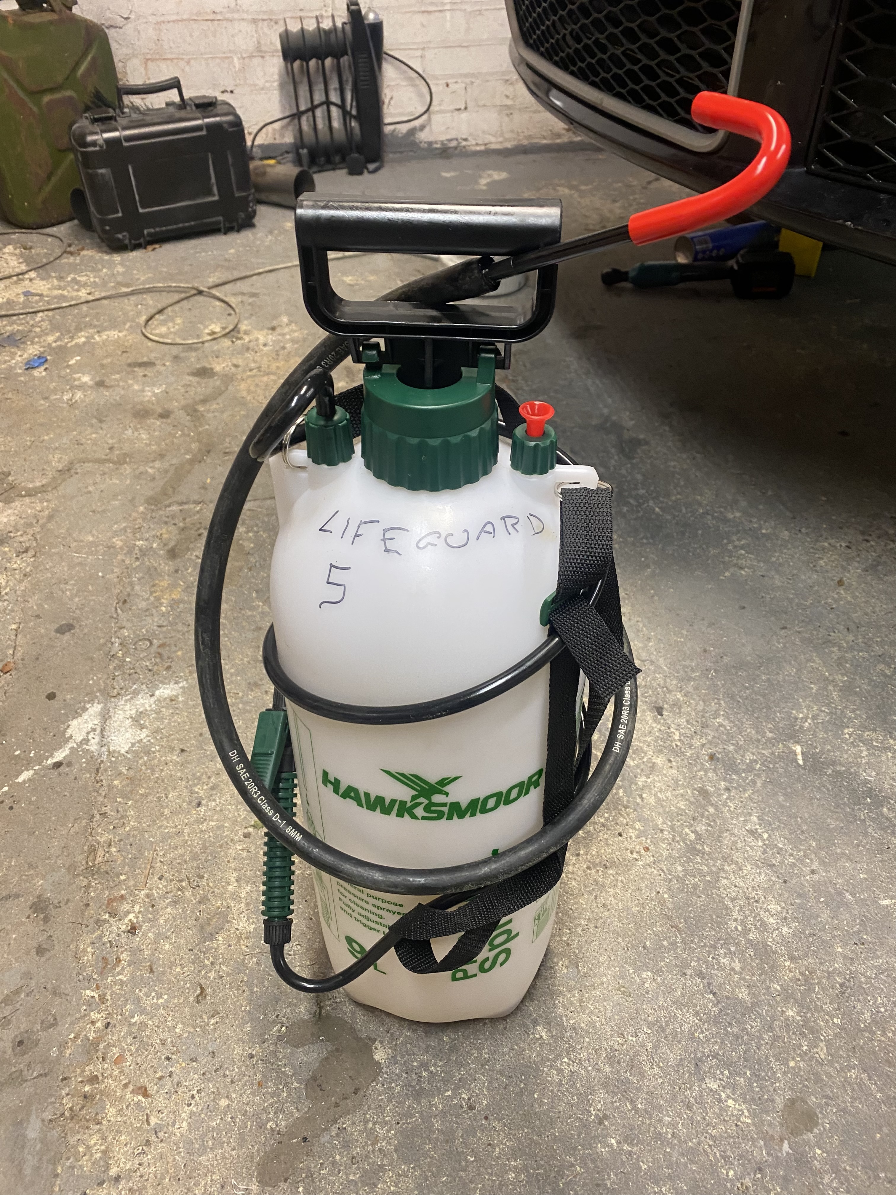

Just done another service. You need 8 litres, one more than in the kit.
And I made a tool

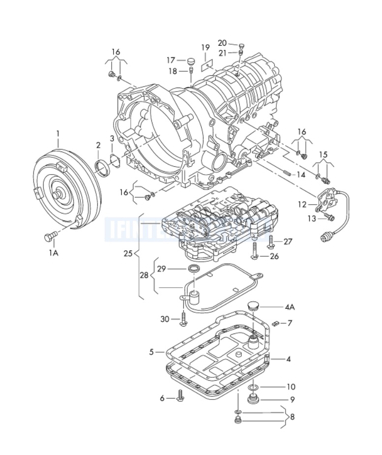

And there’s 2 in the service kit that are similar. One is for the filter, one is for the sump bung. They are similar enough that you need to check which way round to put them

Post by Mɐʇʇ » Mon Feb 20, 2023 9:24 am
I meant sump bung, not filter. Now edited.
item numbers 29 and 10, respectively.
