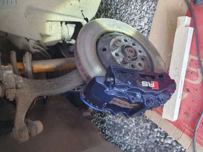

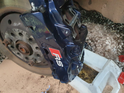

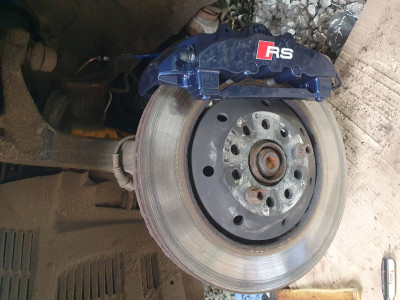

Just to add another pic to this thread I had my calipers done by Brake Caliper Refurbs in Rochdale. I just decided to go low key and had them match my cars Mugello Blue, at least if it need touching up I already have that colour. Im happy with them and one nipple needed to be helicoiled as it had lost its thread. I also put on some Wezmoto braided hoses as I ended up cutting the original ones off.
