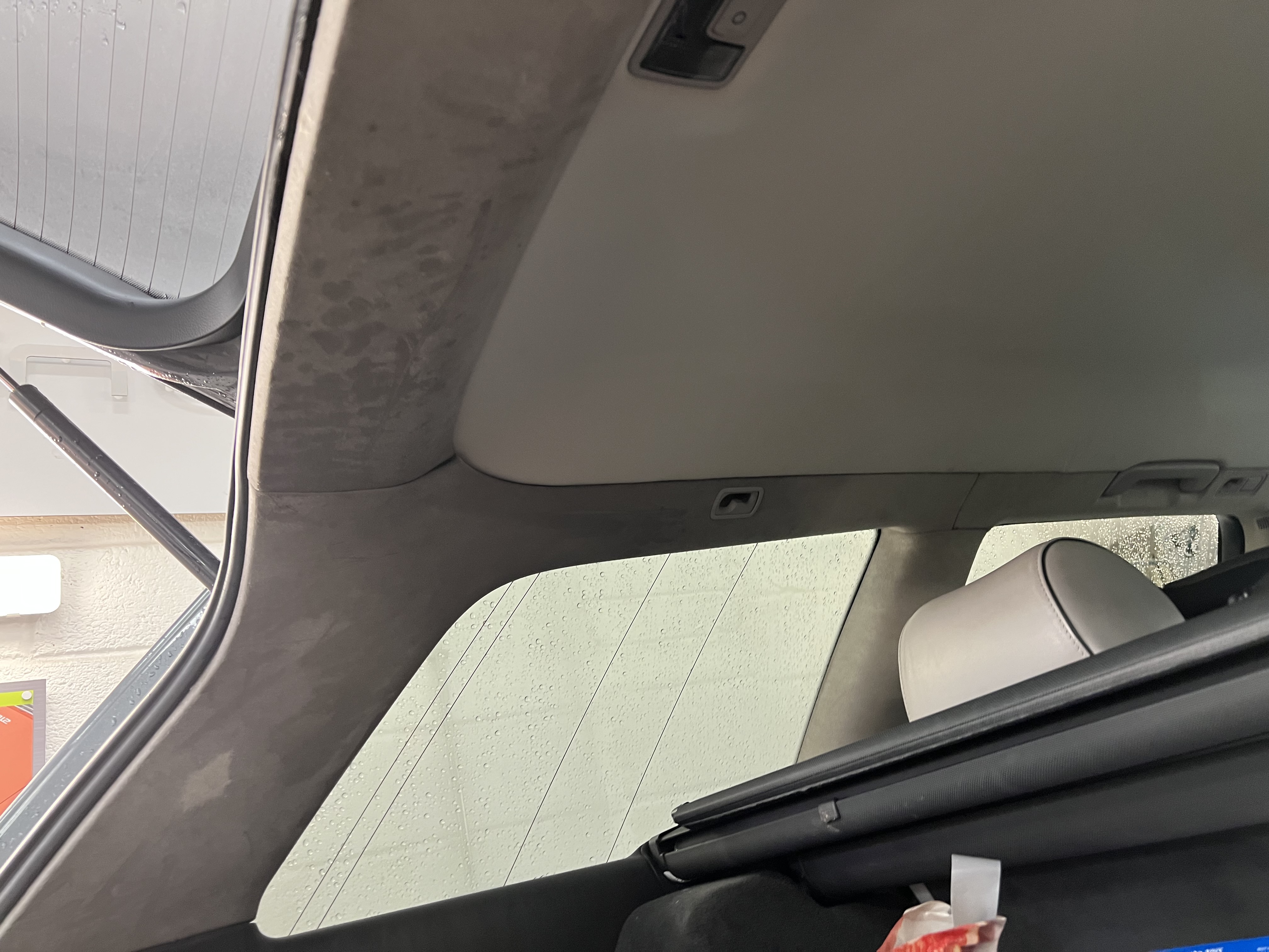

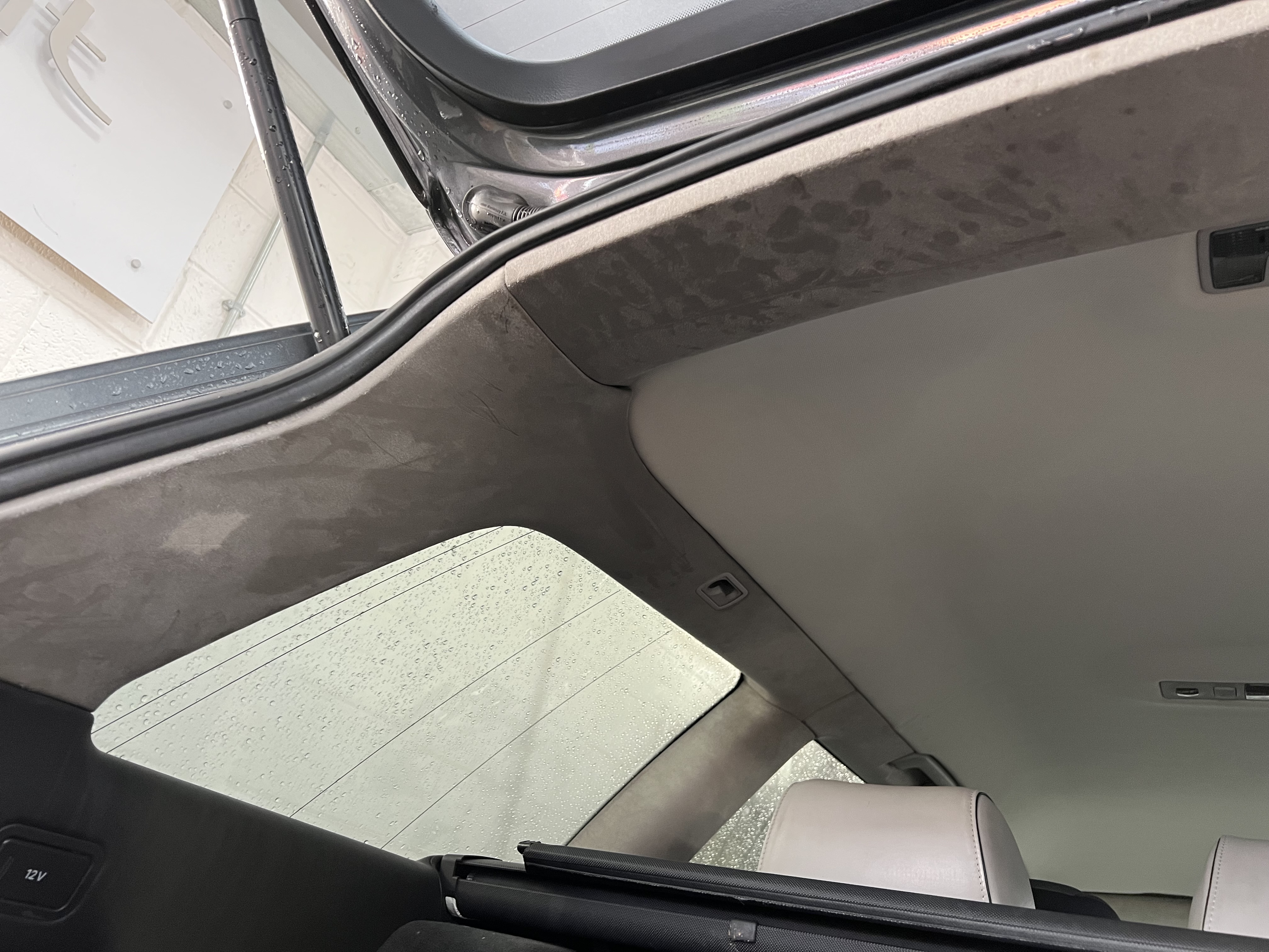

Hi All!
Advice please ? I've got quite a serious water leak coming in from the LHR/Centre rear roof area.
See piss attached.
Inner D-post and rear roof trims are saturated.
I've already had a glass company take the windscreen out and re-bond back in again - So I know its definitely not coming in from the windscreen!
Has anyone experienced this issue ? Is there a known common fault ?
Are there any drain areas that could be blocked ? If so where are they located pls ?
May be its coming in from the roof rails or rear aerial?
Any advice will be much appreciated ?
Many thanks
James

Maybe the GPS antenna base?

Jeez.. stating the obvious I guess, but I'd whip off some of that trim, sit inside, and get a competant mate to go over all the seems and fittings with a garden hose, one sure way of locating the problem, that's how we done it in the bodyshop..

Comma used to do a product called Seek N Seal, it was in a tin with a plastic nozzle much the same as 3 in 1 oil tins, it was brilliant stuff, you could see it creep along the door, window and body rubbers by capillary action..amazing stuff.

Rear screen washer pipe ?

My rear GPS seal isn’t great so I’ve supplemented with some sealant. Did look at a replacement seal but the are NLA. I’ve also bought a sheet of rubber gasket material that you can make your own with. Or I could just get a nicer looking shark fin….
