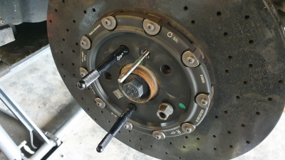

Hello :) Tought I could share some info on a bolt-on front ceramic brake upgrade on our black holes of money. It might be of interrest for someone :) I guess many allready have done something similar, but I did not fint very much on when I searched after it :)
I upgraded my fronts to ceramic, and it was almost too easy.
You need;
- Audi "ceramic" 19z calipers
- Ceramic brakepads
- R8 gen 2 ceramic 380x38mm discs (this is what I used, but I think they are the same on the Rs5, some Lamborghinis etc)
After removing the oem caliper end disc, its just to install the ceramic disc, and drill and tap a 6mm to secure the disc.
The adapter bracket from the ceramic caliper is identical to the oem Rs6 one, so this one you dont need. The ceramic caliper fits bolt on the Rs6, and the disc offset is then spot on :D
Bleed brakes, and have fun :thumbs:

All factory part, no spacers, no mods :) Here in Norway, we have some very strict rules on modifing cars, but this bolt-on all-oem upgrade went straight trough MOT :thumbs:
I have only done some small city driving, and som highway cruising so far, so not really put it to the test yet, but so far I am really happy with it! The best is no more brake dust! :D
