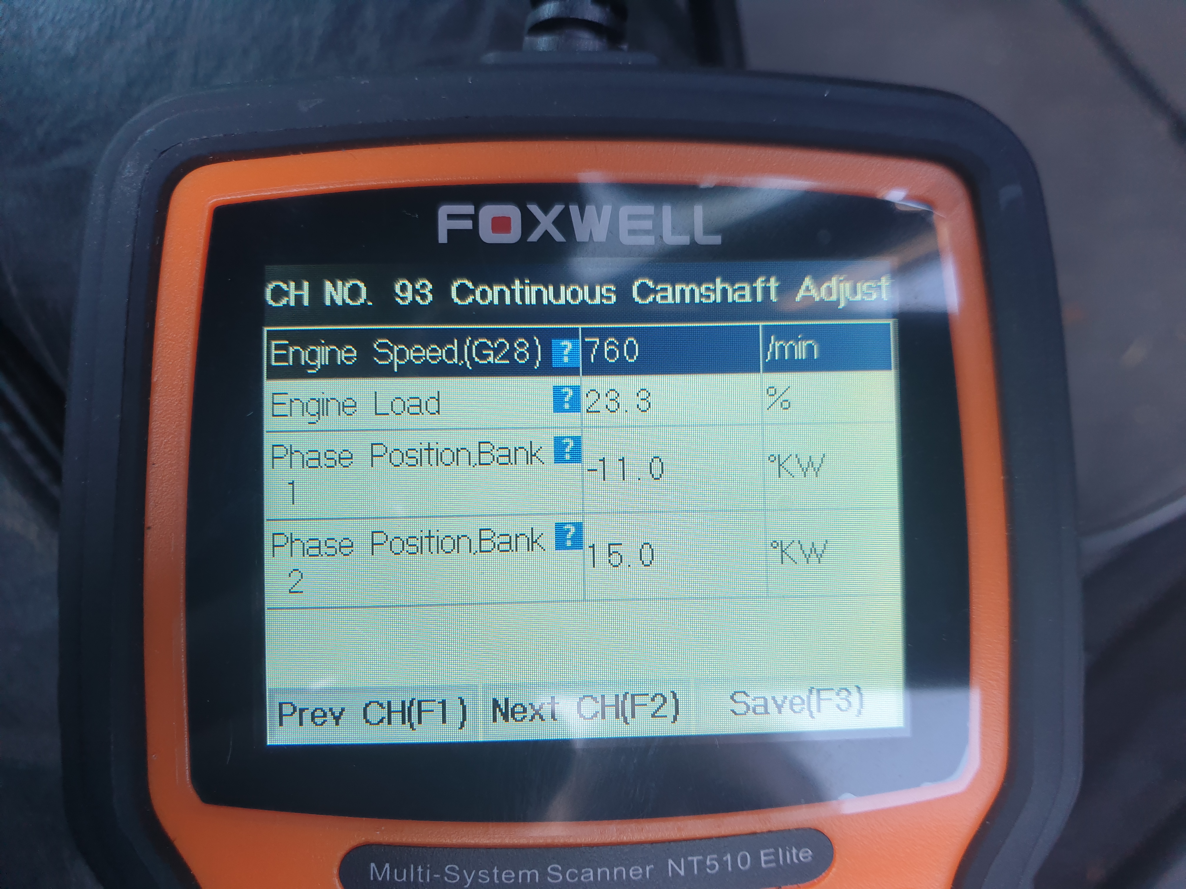

I'm just wondering if anyone has seen these sorts of values on block 93 when checking timing on a 2003 RS6 C5. Bank 1 is showing -11 and Bank 2 is 15, so a large variation across both banks. (See attached images).
The chain link count on both banks have been double checked and timing was set with the correct tools etc etc.
No error codes being shown and no misfires. Car running well although idle does sound a little off, but sits at 760rpm with no fluctuation.
I've checked both tensioner solenoids and they appear to be working fine with correct voltage to both. I think a fault here would throw up a P1347 code or incorrect values in block 90. Block 90 is within tolerance as shown in photo.
Could the timing just be out slightly causing these values or could it be stretched chains or sticky tensioners? Both tensioner pads are good.

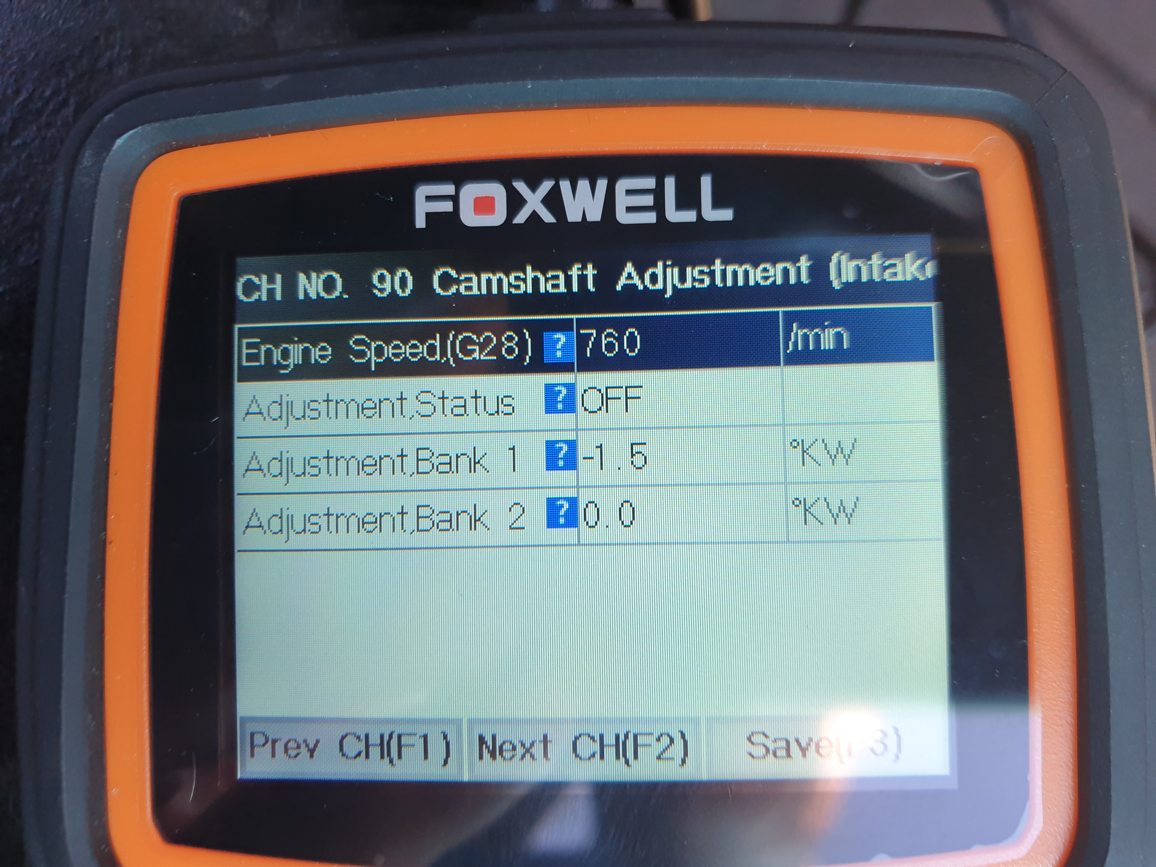

I assumed both tensioners are working fine with the block 90 values being in spec?

Non, the 90 values aren't for measuring this. They are relative values, not absolute.

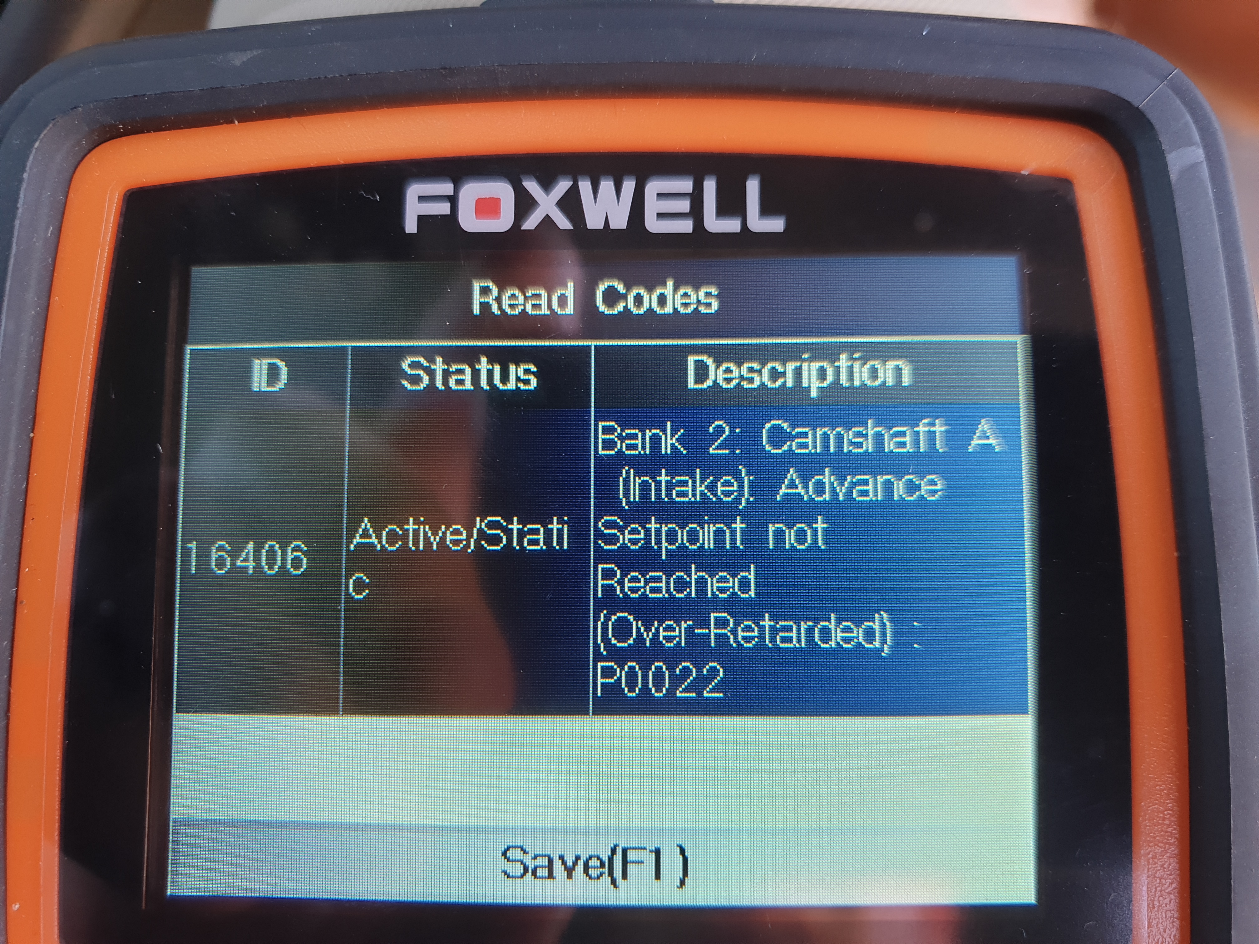

Hi again,

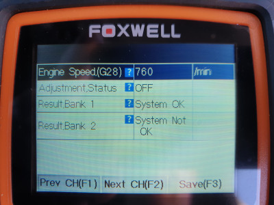

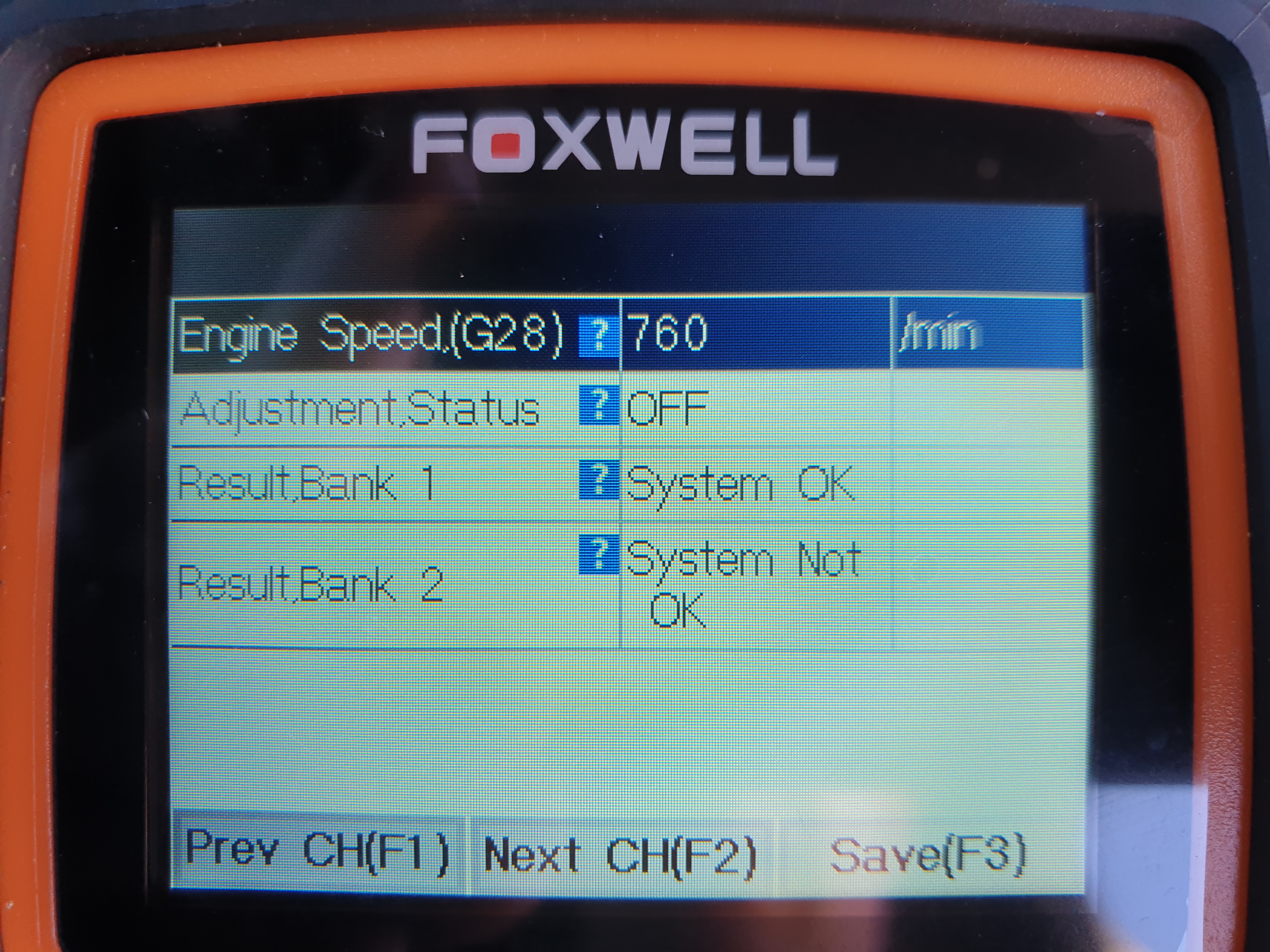

So just just got a new code which will hopefully help explain - P0022 - Bank 2 - Camshaft A(Intake). Advance set point not reached (Over-Retarded). See photo, also block 94 showing an issue with Bank 2.
Does this sound like a possible camshaft tensioner on Bank 2? I checked and power is getting to solenoid okay. Could this explain the value of 15 on measuring block 93 for Bank 2?

You get this error when the dephasing isn't reaching the correct value. IIRC it should measure between 16 and 25 degrees dephasing when activated. If your timing is off by 11 or 15 degrees, which is appears to be, then it's quite likely that when the dephaser activates you won't reach that spec, even if the dephaser is doing what it should.
I suppose maybe a dephaser is stuck in the extended position. Never heard of that happening, though. Usual failure mode is disintegration of pads or failure to extend which doesn't lead to the kind of timing error you are seeing.

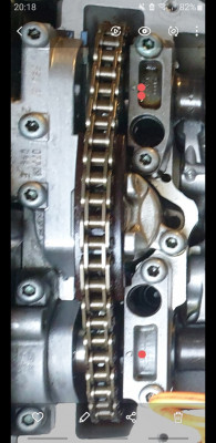

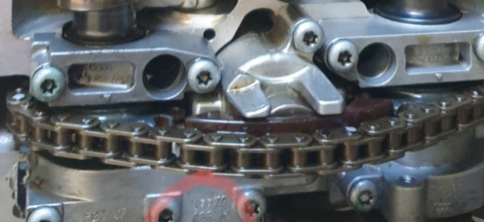

So, looking into bank 2 I've taken a few pics of the tensioner and the misalignment of the cam marks are obvious. This would explain the advance on cam A I think? Ex cam notch is spot on and I'm still counting 15 links, but the tensioner appears very tight even though the car has been sitting for a week. The tensioner appears to be fully extended, with the super tight!
Another observation is the actual tensioner part number ending in 88, but from research the part number should end in 87. Is there a difference in bank 1 & 2 tensioners or will a tensioner from bank 1 work okay on bank 2? The heads have not been modified, just gaskets replaced.
As previous stated no issues at all from bank 1....

Right, bank 2 is on the left from the driver's perspective. Cylinders 5-8. Part number for the dephaser should be 077 109 087 P
They are different parts and not interchangeable. Maybe they have been put in upside-down when they were last replaced. Seems unthinkable that they would physically fit in the wrong positions, which is presumably exactly what whoever installed them thought.
I think you have found the cause of your problem.
