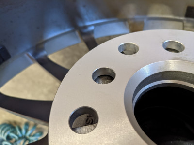

I'm in the garage now sorting the suspension.
The h&r hubcentric 8mm spacers don't fit inside the OZ rims.
The hubcentric insert is too deep.
Is this known?
Can I remove the insert that comes with OZ?
Here now and would love to get this sorted.

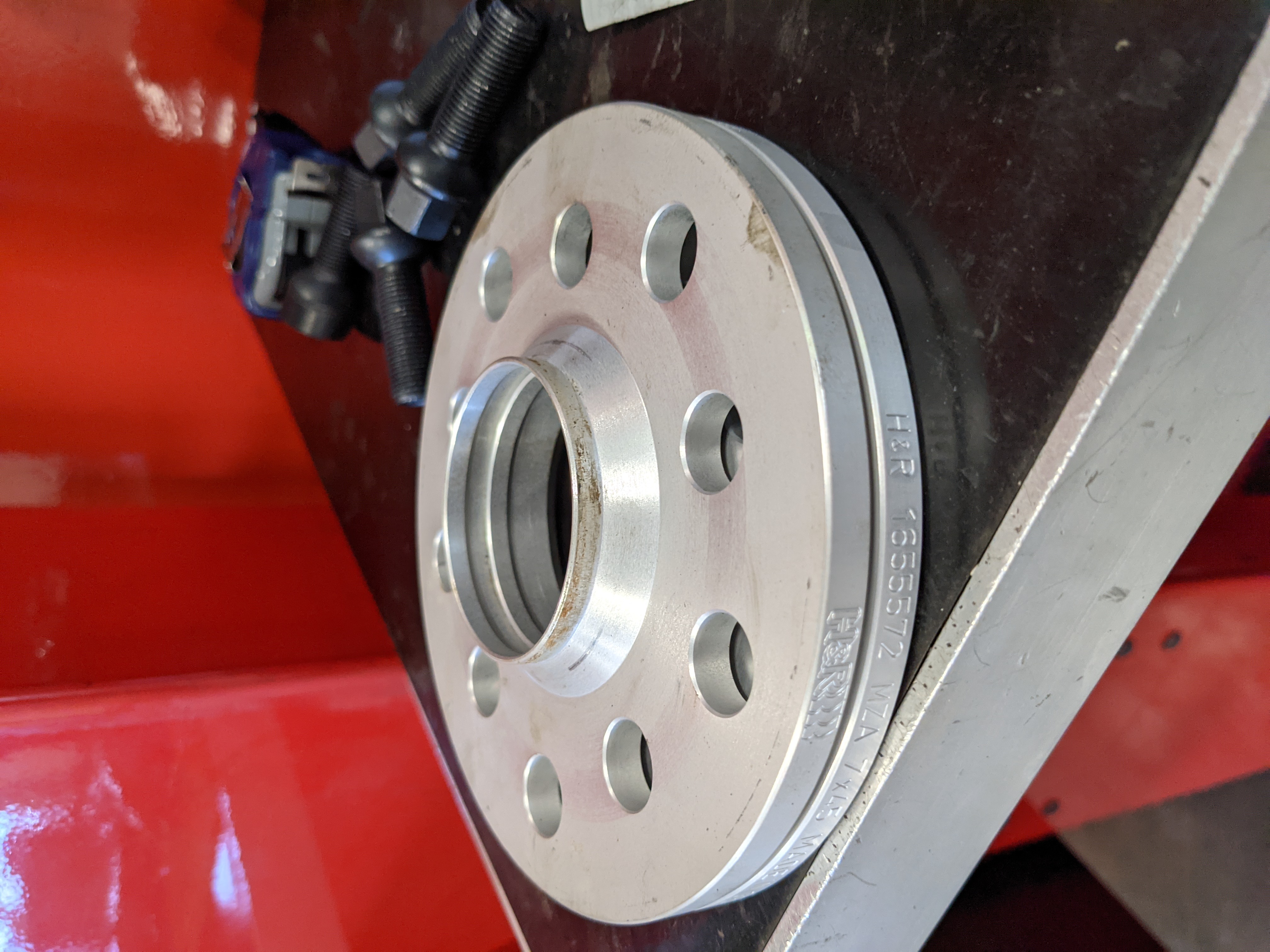

You can maybe see a couple of mm play here:

Have the OZ alloys got the correct spigot for your hubs? They are different for most cars.

I don't understand where they are fouling. Is it the cylindrical lip that extends too far into the spigot? It should be 5mm just like the hubs.
Posts: 20291
Re: In garage now : hub centric h&r 8mm spacers not fitting OZ
Post by Shoppinit » Fri Oct 29, 2021 1:42 pm
OK, It looks like it might be the tapered bit. I wonder why they made that bit so big.

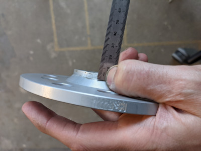

you're right, it's the cylindrical lip that extends too far into the spigot.
I've measured the lip and it is 5mm like you said:
I guess it is as mentioned before and the issue is the spigot that was supplied with the OZ rims.

It sounds like you've got the wrong spigot for your car - I've had OZ's before with H&R spacers (although on a B5 platform) and there were no issues. The spigot should replicate the OE wheel profile. Unless the spacers are for the wrong platform?
