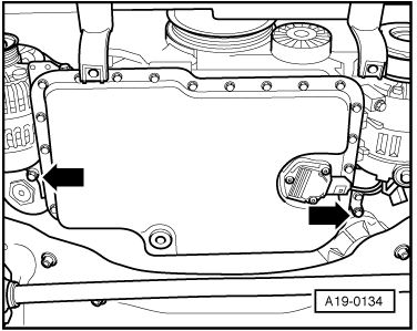

Block coolant drains
Post by Lander91 » Mon Sep 06, 2021 9:19 am
I've searched, honest! Where on earth are the block drain plugs? I'm up to 4 flushes to get the green <beep> the PO had put in the engine. Still coming out green.

Post by Lander91 » Mon Sep 06, 2021 11:22 pm
Found them:
coolant drains.JPG (36.47 KiB) Viewed 1376 times
