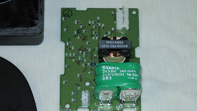

I posted a year ago about battery issues. It was a fresh battery and draining after a week or so. Turned out to be the alarm.
I just left the alarm horn out and it has been much better since. That said, after I installed a CTEK bluetooth battery monitor system it is easy to see where your current is going. Even with all things working well, the ccm and the alarm system sensors are a constant current drain. If I leave my car unlocked the battery drain is far less.

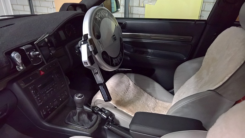

I'm no fan of the electronics and every man and his dog has some system to bypass them anyway so a Disklok is the way to go. Have one for each car (despite them being almost unobtainable this side of the world) and while I am under no illusions that they are unbeatable, it's another fence in the way.
