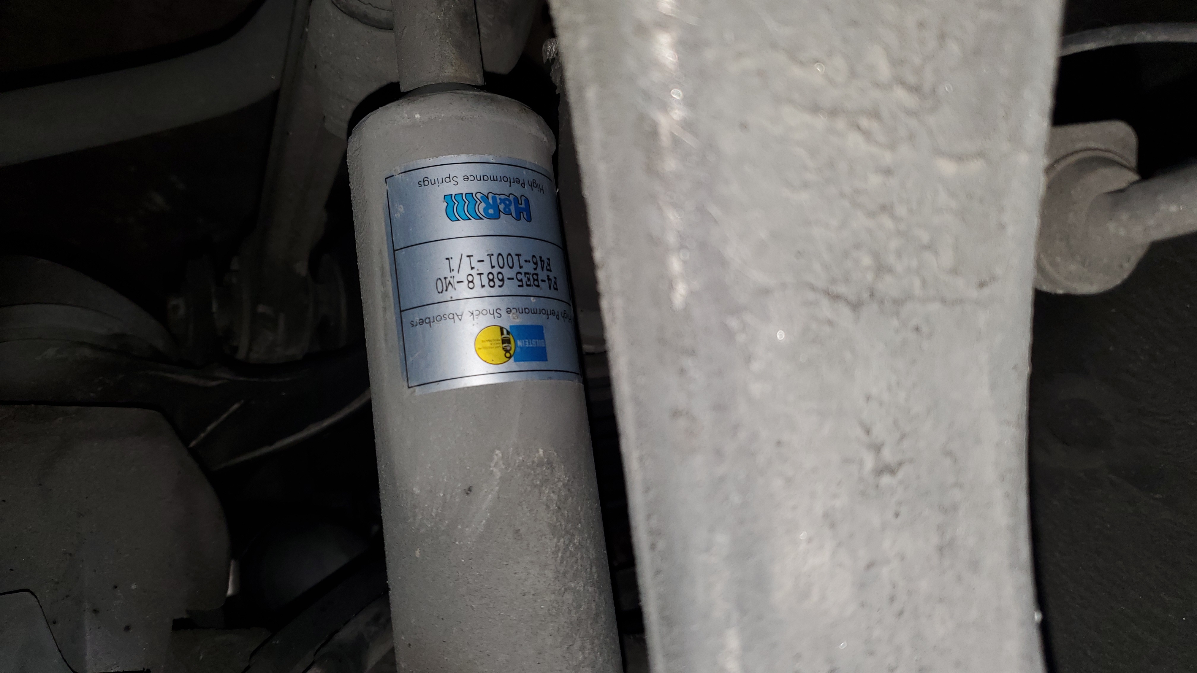

Hi all, to confirm re H&R, these are the <beep> ones? Red H&R springs.

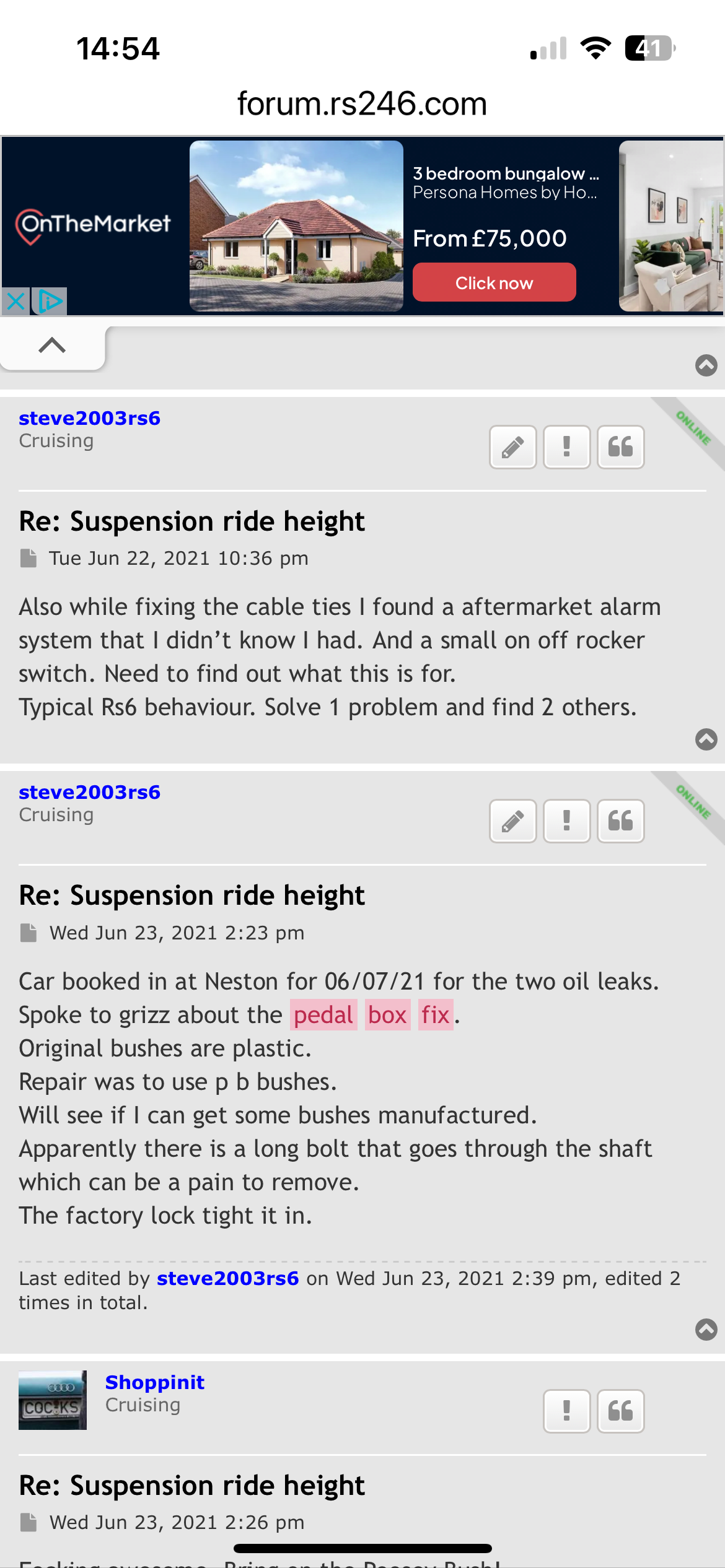

Bit of a thread resurrection, but what is the mod you did to the pedal box?
Steve2003rs6
- Posts: 2970
Re: Current best suspension set up for c5?
Total cost was 50p for 3 cable ties.
On bad roads I had a clunking noise and it was sending me nuts. Appeared to travel up the steering column.
So I started with suspension. All new top mounts and bushes. All new bilsteins then all front suspension arms replaced.
Still the clunking noise persisted.
Spend was £1000,s
Then forum members said have you tried the pedal box fix.
As a last resort I bought 3 cable ties and followed the recommendations to cable tie the pedal (Brake) shaft to the frame just above the pedal shaft.
Result problem solved for £0.50.
Basically you are overcoming the excessive play between the brake pedal shaft and the plastic bushes.
Did I feel a right Pratt or what.
Ps please don’t tell my wife.
Cable ties are still on now and still no clunking. To be honest I had totally forgot about them being there.
IIRC there is info on the fix in the FAQ section.
I later discussed the repair with Grizz. They used to rebush the housing with pb bushes. But it’s a nightmare apparently to remove the long bolt to release the shaft.
