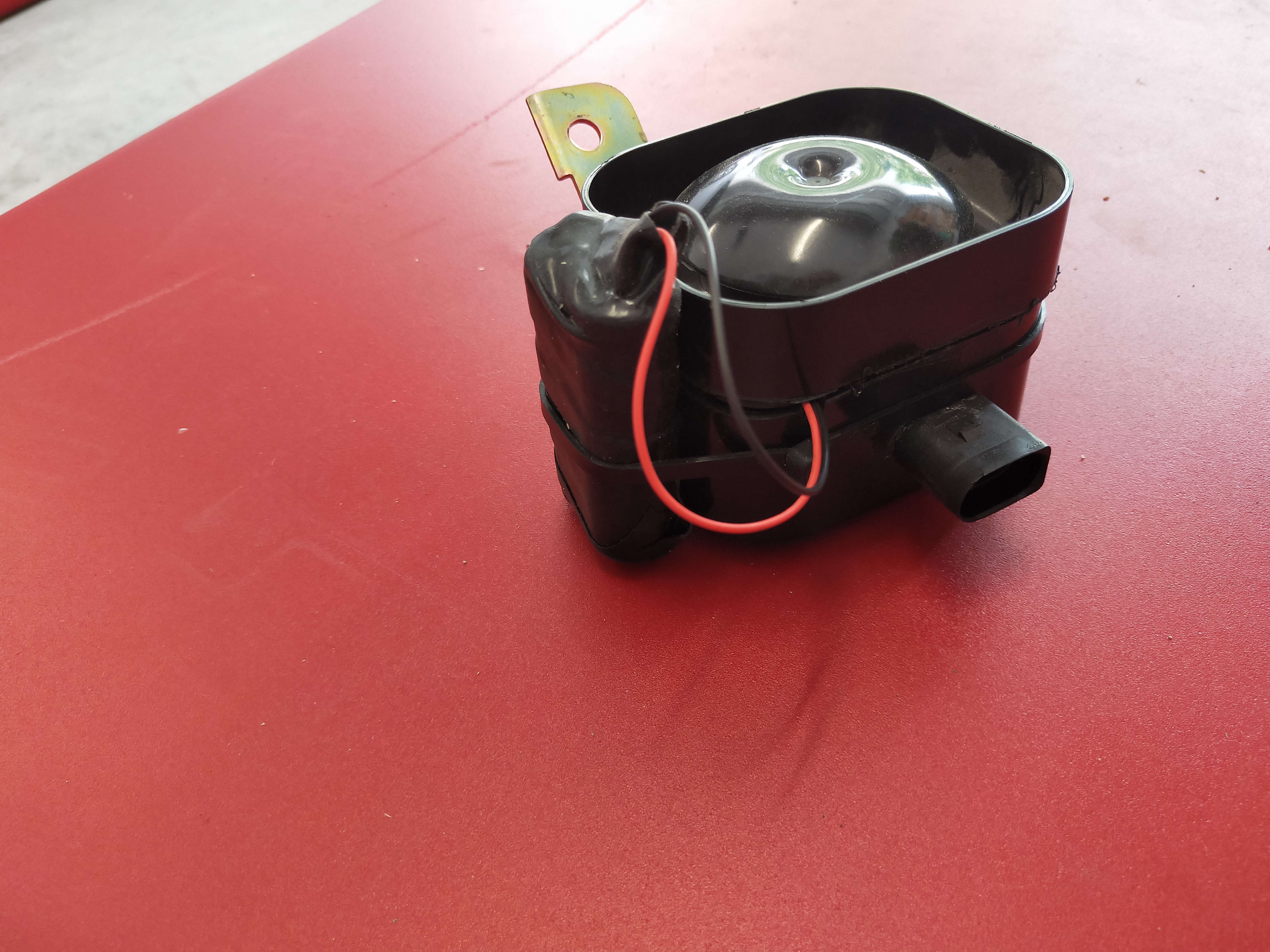

Most Audi alarm sirens are sealed with an internal rechargeable battery.anditsoundslikebells wrote: ↑Sat Feb 27, 2021 9:54 amI only found out about the original alarm when I was fixing the climate unit over the holidays. That was a surprise.
What battery am I looking to get hold of to replace?
You can try to get a replacement unit, but it will likely have an old tired battery anyway, or try to cut it open and replace.
Or just live with it as it is.....

This is the alarm out of the spares car. I fitted batteries to the outside. It's different to the one in my car. Need to do the one in my car now. Cut them open with a Dremel.
Re: Car Standing-Battery Dying-Kill Switch
I’ve bought a spare one to do just the same
