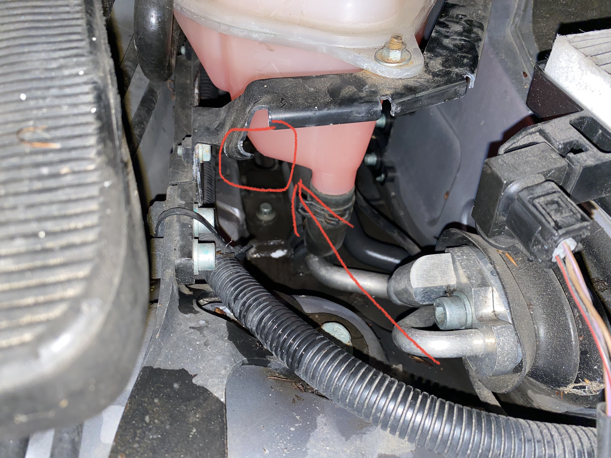

As there are no real pics online for these drains/bungs, I’ll add these to help anybody in future and maybe this can be added to the FAQ section or similar
This is where you will find both of the rubber bungs that need removing
One is right under the header tank, I found it better to remove this by undoing the 3x8mm nuts so it can lift out the way
This pic shows it under the tank back in place

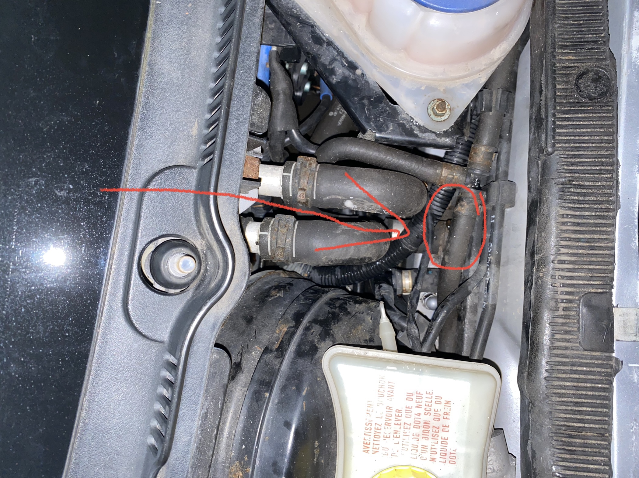

The other is beside the brake booster/servo, it’s hard to find with lots of pipes and wiring in the way. If your stood at the front of the car leaning over the engine, it’s to the very right of the master cylinder, this pic shows roughly where it is under the ancillaries, use a longish driver and prod around but be careful
