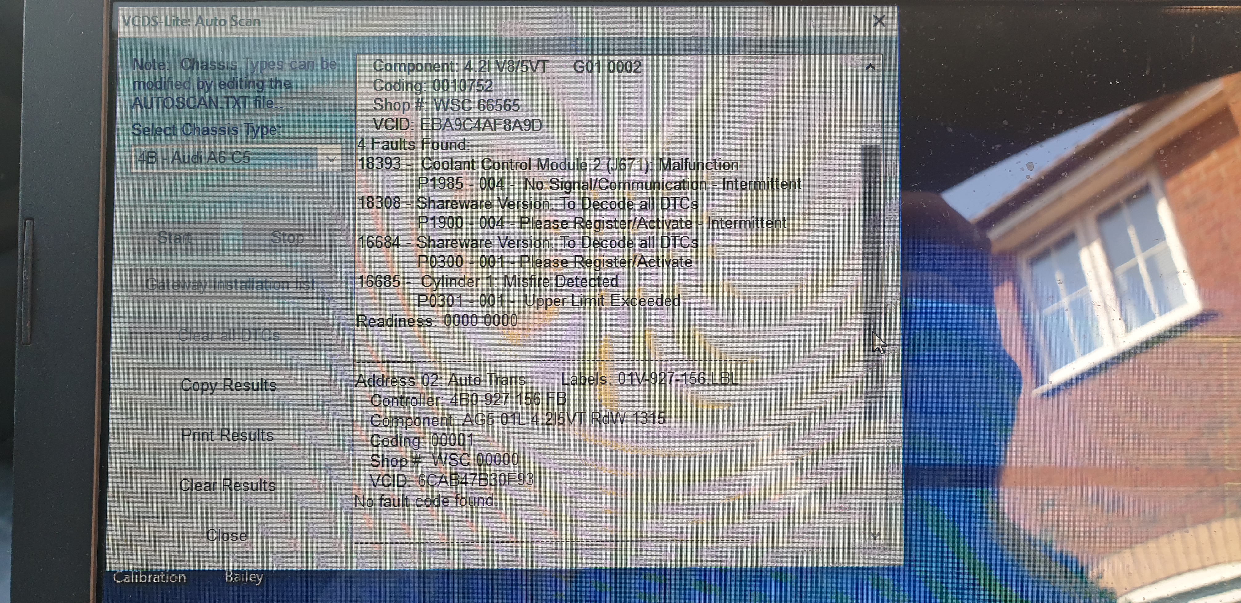

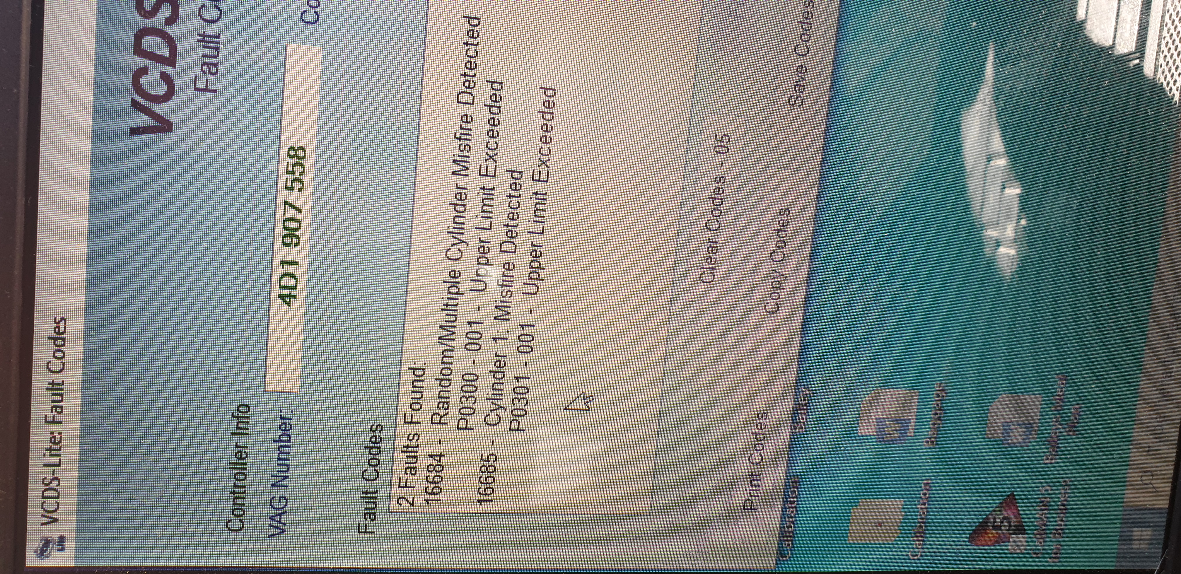

Right here are the codes that I have that I think are relevant.
First I think is an old code, the one with the coolant control module. After clearing all codes and rescanning it didn't come back. But it does state coolant control module, bit could also be known as the temp sensor ? Possible I guess ?
Sorry they are on the side ! Any way to flip them using site code ?

Ah, I see. You are using an extremely old version of VCDS hence the non-existant coolant control module. The J671 in fact is the controller for the small fan. Not an uncommon failure, but has no bearing on your problem.
The misfire code has put your malfunction light on. Since there are no other codes, then I suspect that the problem is either a faulty plug, plug not properly torqued, faulty ignition coil or faulty injector. All of those are fairly easily eliminated by swapping things between banks.
Going further, if you've got a borescope, stick it down cylinder one and have a look for wetness / other anomalies. Might indicate head gasket. Could do a compression test, too.
