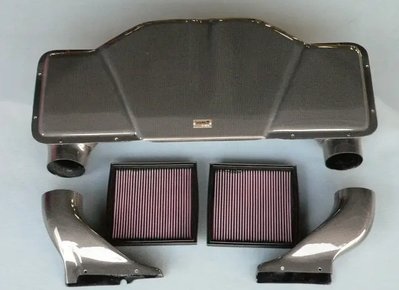

Seeing as it's Christmas and you'd need someone to bring something like this on a sleigh, has anyone ever fitted the Gruppe M airbox to the RS6? Early morning curiosity. I read up that the ram air setup was a dud on the B7 RS4 and this seems to be a rehash of the OE Airbox design rather than sticking a cone filter into the system.
Other than hearing the name, I've no experience with the brand or it's products other than it's Japanese.
My Car came with BMC filters and I'm toying with reverting to the OE Paper elements so the Gruppe M isn't really on my list of must haves.

Waste of money in my eyes as all they have done is remake the OEM one

Missed out the "LOT" of money. May and may not be some improvements but the larger size makes me wonder how much extra difficulty there is in getting it on and off. With my original, it looks like some idiot cracked the air box base when trying to get it off. It's been fixed but clearly the attempt fell foul of the two securing nuts and perhaps the locating pegs stuck in the grommets as well. Some of the people let loose on these cars are a menace.
