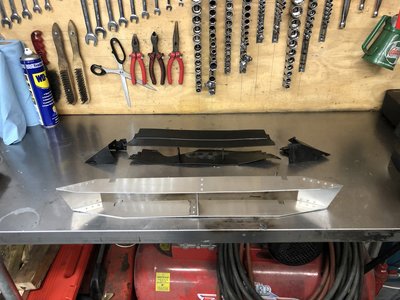

How much of your plastic is broken? Every time I even looked at the oil cooler plastic, another piece falls off - it's made of such crap plastic.
I decided I didn't want to put a POS like that back on, nor did I want to give audi 180 quid for another bit to fall apart.
So I made a new one out of 1.5mm NS4 aluminium.
Total cost - £27.66 for a sheet of 1.5mm thick 900x300 NS4 ali from https://www.merlinmotorsport.co.uk/
Plus a few 3.2mm rivets and 4x 5mm bolts, nuts & washers.
Mostly went OK, although I am a bit miffed that the lower panel isn't exactly true - has a very slight curve in where it's pulled by the brace.

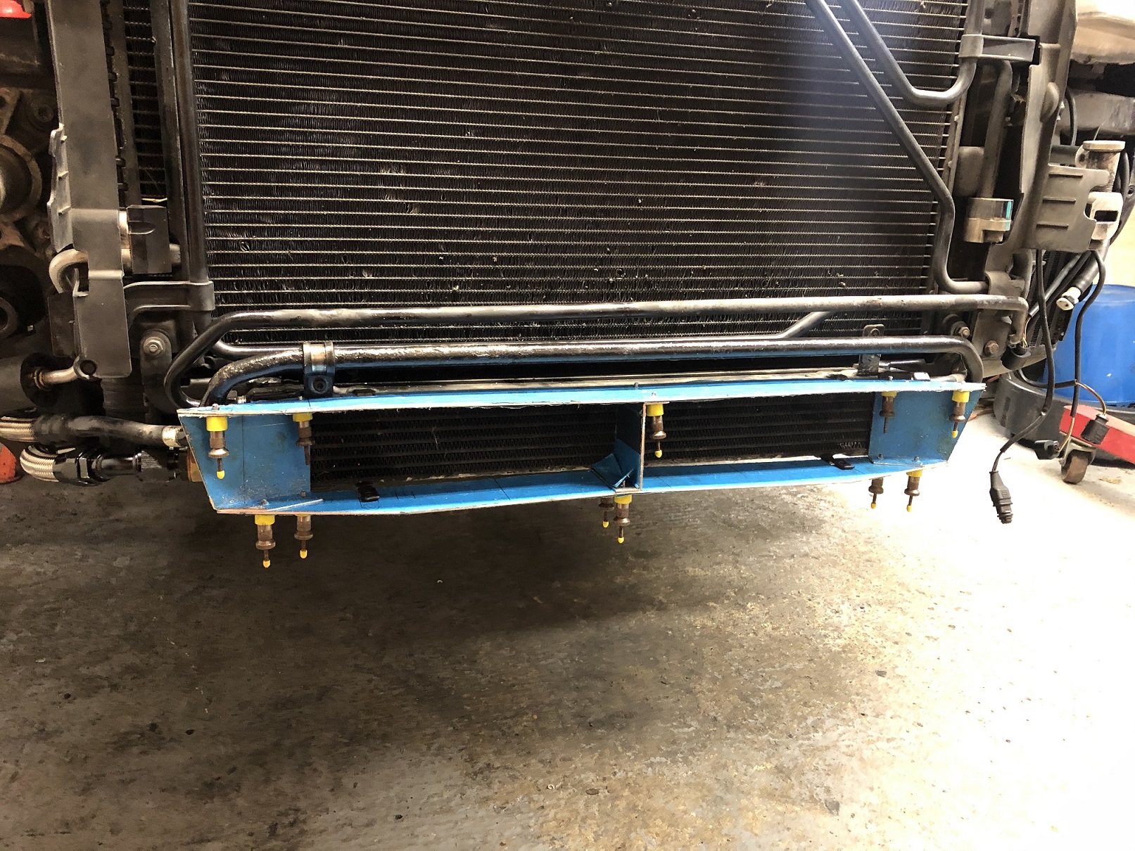

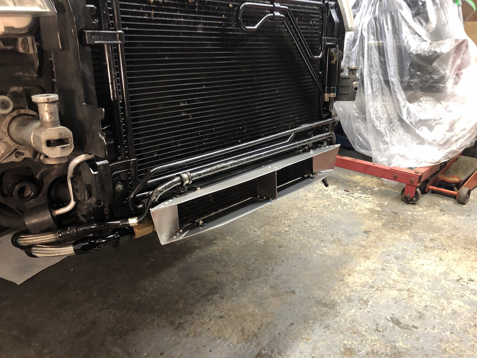

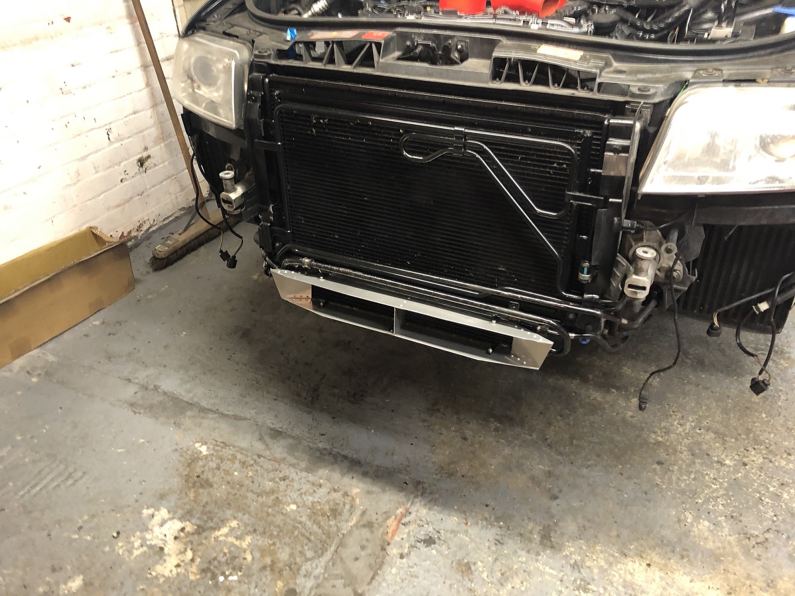

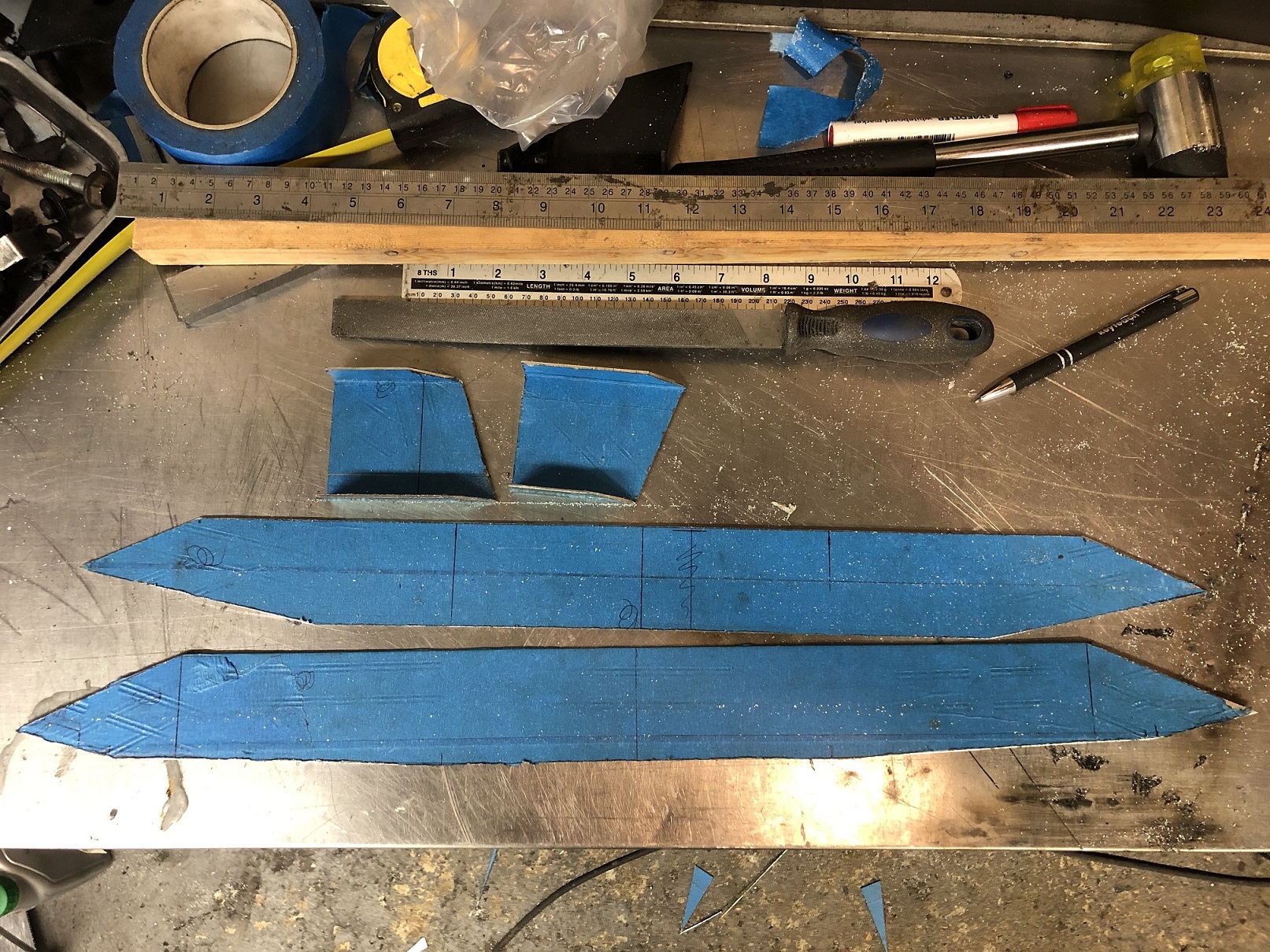

Sizing up the old POS: Making a kit of the parts: Trial fit with skin pins Looks alright Final fit

It fits well. Some other pics of it here : viewtopic.php?f=2&t=113332&p=928673#p928673

hey Matt, you dont still have the dimensions of the pieces you cut? My OEM one is pretty much completely destroyed so not much I can use.
Re: Oil Cooler Duct/Air Guide
I'm sorry, I didn't, I didn't think about it until too late (bumper is now back on).
no problem.
You can see how many bits my old plastic one was in - so I kinda just had to guess a bit on the new ali one.
