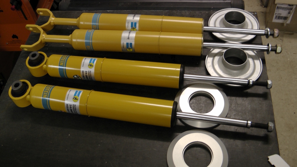

Mentioned earlier that I couldn't get the KONI solution for the C5 RS6 so I ordered a set of Bilsteins. Happy days and an early Christmas, they arrived not long ago. Unpacked and a nice setup by the looks of it.
I do have Bilsteins on the RS4 so this wasn't scraping the bottom of the barrel but I was open to trying the recommended solution. Will get them fitted around everything else that's happening and report back.

I prefer Bilstein over Koni for street driving. Are those B6 or B8's?

Post by IchBautAuto » Tue Nov 26, 2019 10:24 pm
They're B8. I've had good experiences with the RS4 equivalent B8's so no hesitation in using them. Getting lower spring plates was a bonus. You had to reuse the RS4 front lowers.

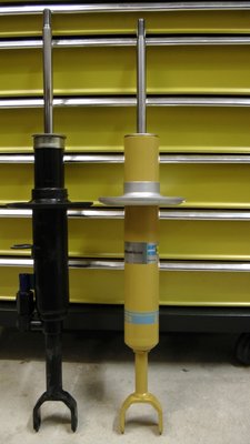

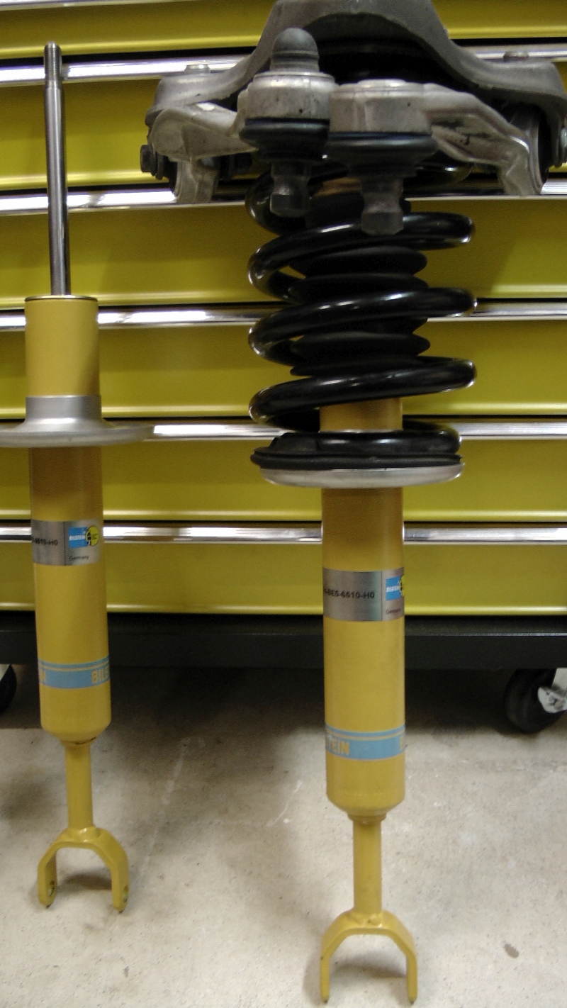

Post by IchBautAuto » Wed Jan 22, 2020 8:26 am
Finally got around to the damper swap. Interestingly, the spring preload on the OE dampers was very low, although it does become clearer when you see that the Bilstein dampers are 20mm shorter overall.
The spring perch is 5mm higher so I'd imagine the finished product will sit a fraction higher than standard.

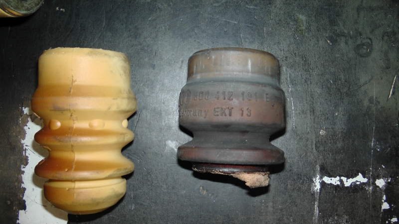

Does anyone know for sure which is the correct bump stop? The one that came off was knackered and was 8D0 412 131E.
The US Audi site has a part number search and it says that number is for the B5 sports suspension and is incorrect for the RS6. The aftermarket shops list just about every part number option as suitable, highly unreliable. I would normally have taken the fitted part to be correct but not so confident on this.

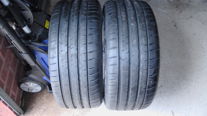

Added a set of Michelin PS4s to try them out.
