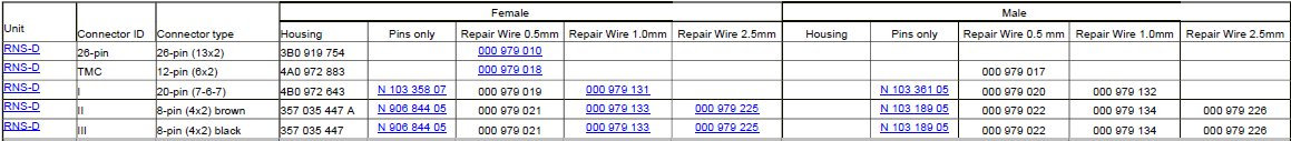

You can start by ordering the housings and pins (or repair wires if you don't have the crimping tools). What is your comfort level with wiring repairs?

My comfort level is slightly above zero, but luckily the guy fitting the unit for me is very good, he was shocked at the state of the ‘modified’ loom! As you suggest, if you could help with an ID for the colours for the loose wires I can order the bits and we should be in business? Thanks for the pdf but I couldn’t read the diagram in your earlier reply?
Re: Wiring diagram for Bose amp - PO hacked!
Try reading it again. It's just an image file. It's the part numbers you need.
