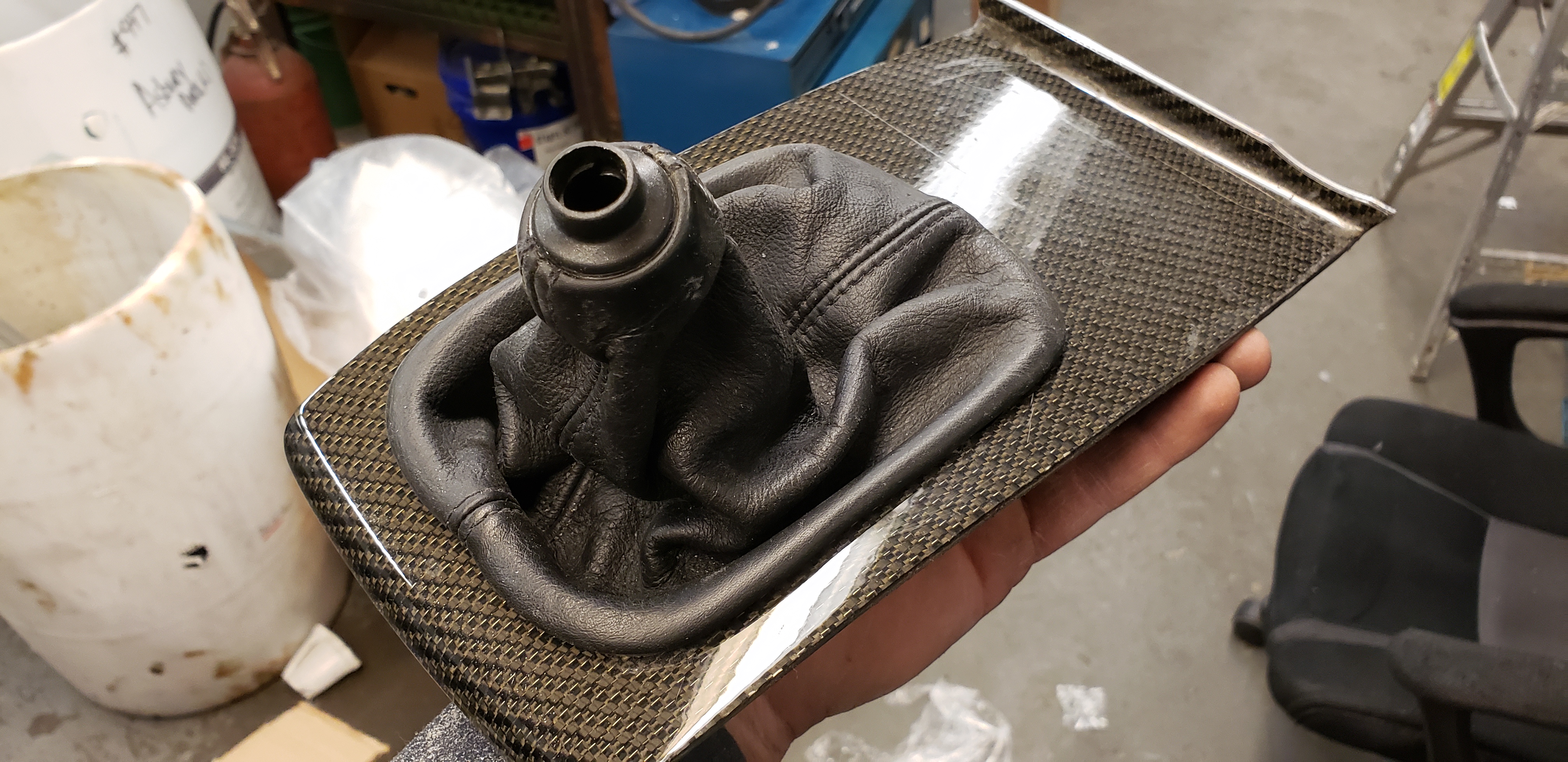

Some late night modification. Just need to try and buff out the small scratches.
