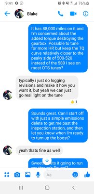

I thing I will go with Blake, I bet when that RS6 tune wakes up it is a beast. But I’m worried about the trans. His prices seem so reasonable compared to everyone else. I wonder if his tune is better accented with a tip chip from 034.

I spoke with him about that trans in particular!
I said I liked the power of the Stage 1, but wanted the tq to be a little more conservative. He said he could tune it reasonably.
This was back in January, he can do whatever you want

I still don’t understand the emissions delete lol. Wow he seems like an awesome guy though. How did it feel with the tune.
