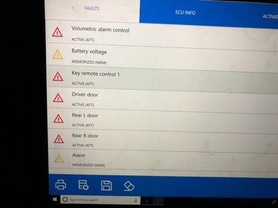

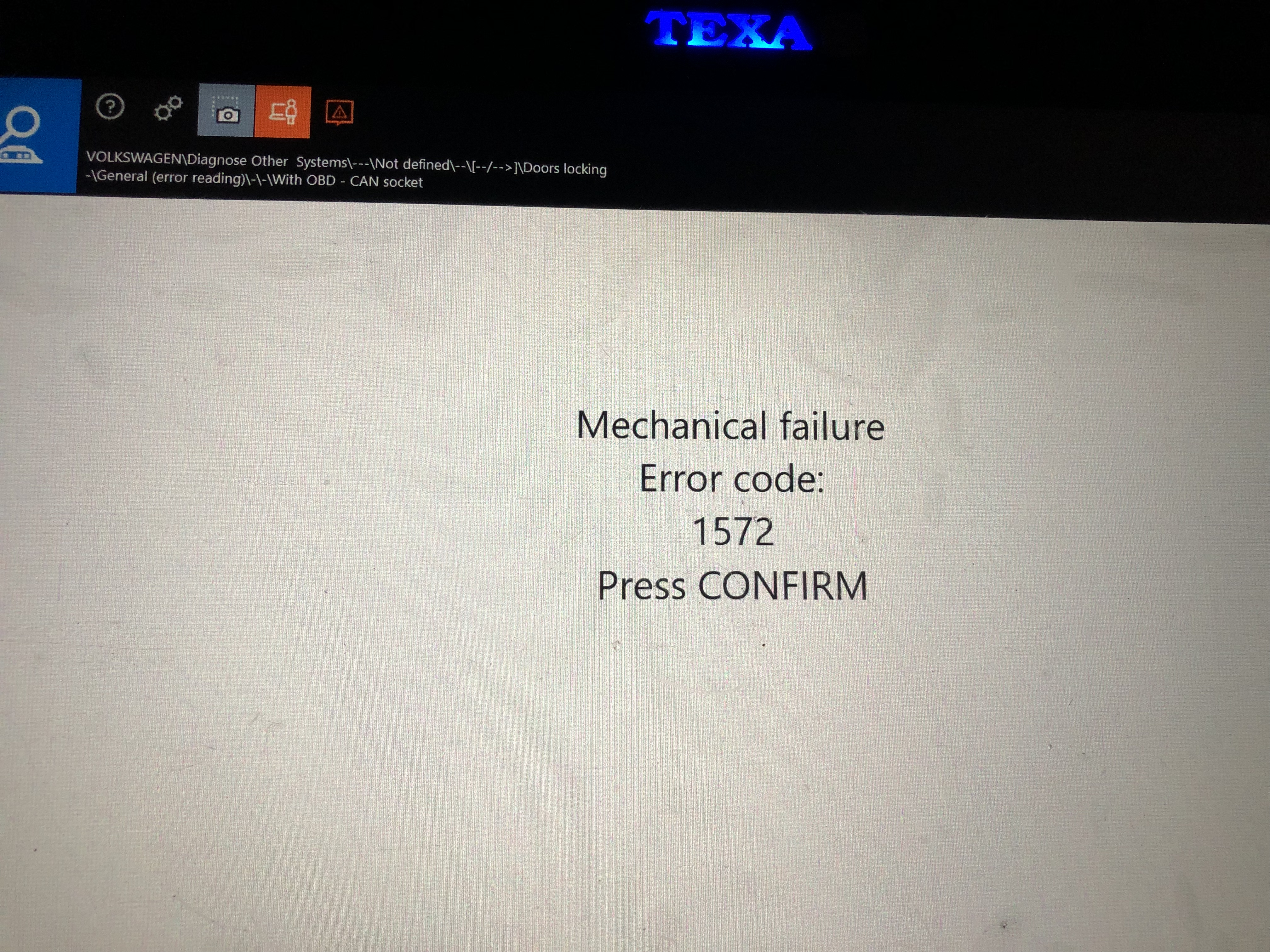

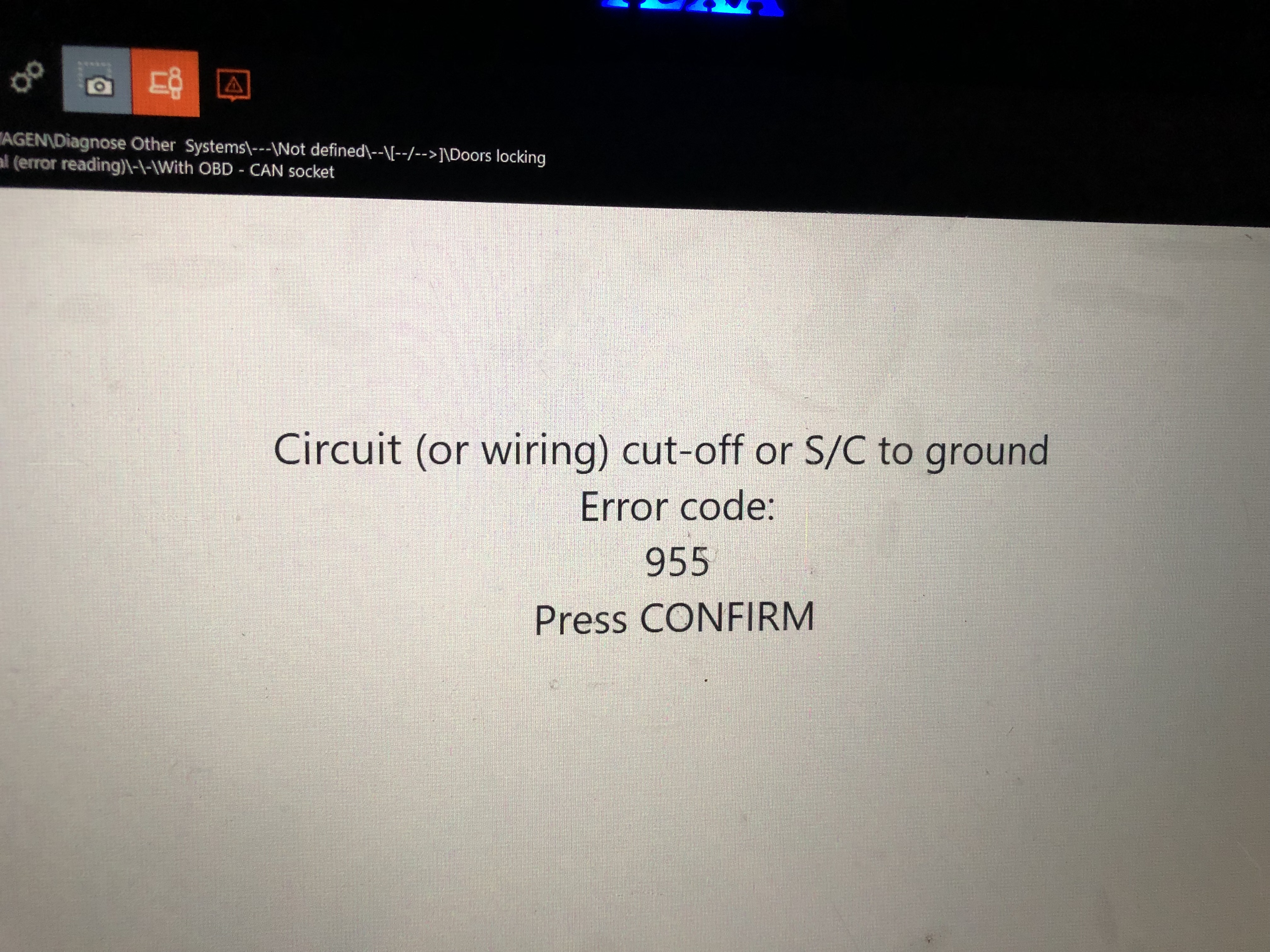

Unfortunately I can’t stretch to the luxury of my very own diagnostics programme solely for one car so Vagcom is out of the question. I borrowed my ‘generic’ diagnostics machine from work although the car will only connect under ‘VW generic’ not Audi.
Here’s what I’m getting: I have a ‘German car specialist’ over the road from my work and the head tech over there swears to me the key only needs resynching as even by being without battery for 6 months much like a memory card it can’t wipe data and if it were working before nothing is at fault now. I have tried every possible syncing process found on the web from multiple countries for all models and age of every Audi and nothing works.

Ps the first mechanical error description relates to the active door faults and the circuit cut 955 relates to key remote control problem.
