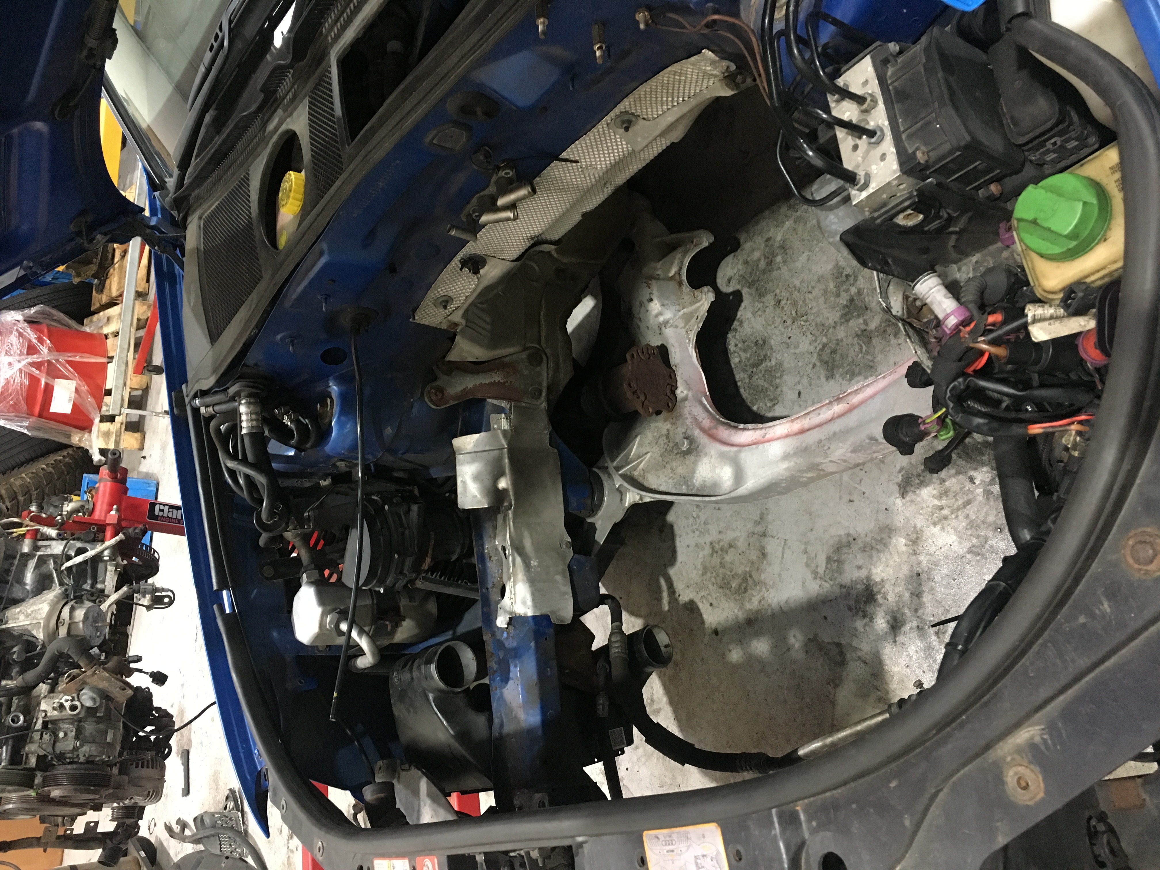

The hole you mentioned!

There is no point doing the job half arsed when you have the engine out.
Is your car in there at the moment? Its quite impressive seeing just how much room the engine and box take up!
