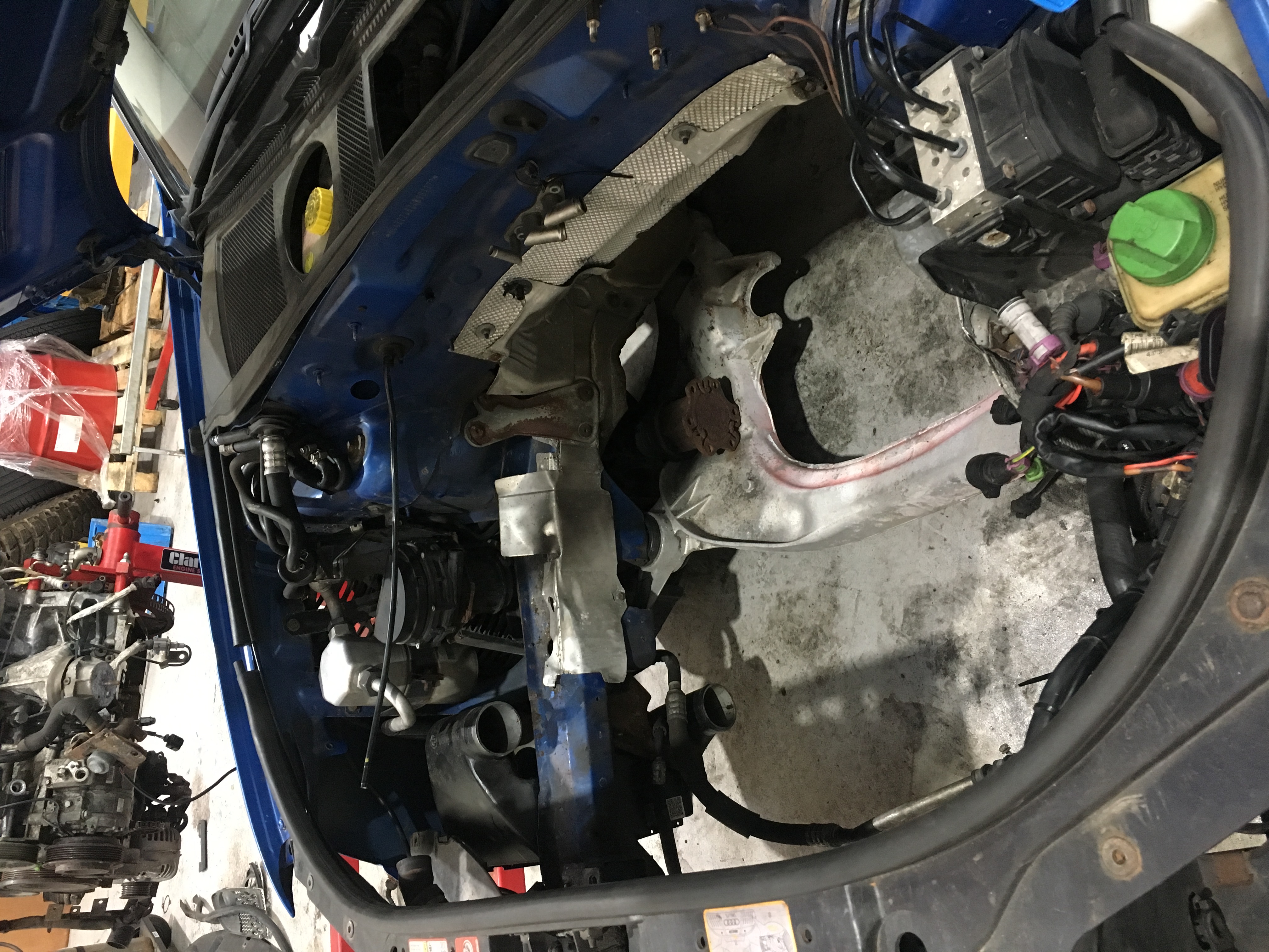

Hi all
I got a price through from Unit 20 this week and we're looking to add a couple of preventative jobs into the repair as the engine is out. One of these is to refurbish the turbos as they can just be removed at no additional labour cost. Unit 20 have quoted me a price for this but as they send them away I'm just keen to see what others have done to make sure that I do the best job possible.
Be grateful for thoughts, plus also any work which others might recommend that I do based on their own experiences given the current hole under the bonnet...

There is no point doing the job half arsed when you have the engine out.
Is your car in there at the moment? Its quite impressive seeing just how much room the engine and box take up!
